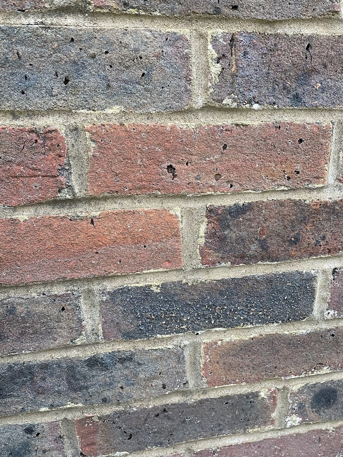

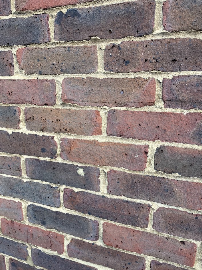

I need to do some pointing patch repair to a few places, and trying to identify what might have been used originally.
House is ca 1950s ex-council house.
The weather-facing front (front.jpeg) has a distinctly different look-and-feel to the back of the house (back.jpeg), which is much more yellow and crumbly.
Might this just be different sand that was used?
I'm mostly trying to identify whether it looks like lime might have been involved. I don't really think so, and was therefore intending to patch with a 4:1 sand/mortar mix. Does that sound about right?
Many thanks
Martin

Lime is an alkaline material, and will fizz violently in acid. Chip off a small section of mortar, and drop it in a dish of white vinegar. If it fizzes violently, it’s most likely lime!

Acid won't make mortar lighter, but will clean it - while eating away the cement and weakening the weather resistance - and opening pores to collect dirt to then darken it!
And 3:1 is way too strong for face work - that will erode the brick arrises in short time.
Back to the OP, 1950 is a bit late for lime mortar, but not impossible. However, lime may well be stronger due to exposure than it would be when sheltered. You'll need to test it.
They are using 3:1 for the white cement and 4:1 for the grey pointing (with grey sand).
