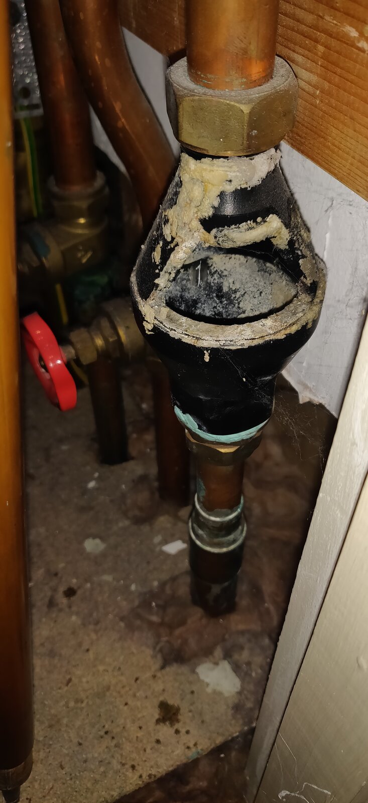

Hi guys.
I have a part of my heating system that is like to identify. It's constantly dripping at the moment and not sure if I have a problem.
Many thanks
Mark
It is a Tundish and needs attention, shouldnt be any water in there under normal circumstances
I have an unvented system and every few months I have the same issue - only its not an issue really because its what its for - its a visual aid to see when my systems tank needs its air bubble recharging / purging of water. When I can see the drips its time to recharge. Not saying this is your case but this vid may help.
in this vid the water comes out of the tundish evem more but whenever I have done mine by turning the valve no water comes out but i can hear a gurgling sound from the tank - like trying to empty a tank too fast. I hold the valve open until the curgling fully stops, usually about 40mins and then thats it for 7 months or so.
The valve is srping loaded and if you turn too far it clicks shut but I can balance it and keep it open while I do something else.
Thank you so much for you help guys. It turns out that there is a TPRV that is not working correctly and leaking through the valve. I have a plumber inusrance type thing and I've paid out £45 for the excess for someone to come out to tell me the valve needs replacing and now they want to charge me £120 to drain donw the system. Does that seem excessive to you. I know the part is around £65, wondering If I could drain down and fit it myself?

Just re read your issue and you says its dripping all the time. When my system needs air sak purge it only drips when the hot water is on.

As for doing it yourself I would not deal with pressurised systems DIY.
Reminds me the other week I had my boiler serviced and the gas engineer although fully accredited etc to fit boilers he is not allowed to deal with the unvented pressurised system side of things.
I don’t think you are allowed to mess with an unvented cylinder unless you have the proper qualification although having said that, you’re not designing and installing the whole system, it’s only a sealed, screw on part of an already installed system - no adjustments etc so if it was me, I’d be tempted have a go. I don’t think you’d need to drain the whole cylinder down either - it will be fitted at the highest (and hottest) part of the cylinder. :whistle:
Au contraire, it’s maintaining a safety part of the system, so therefore would need a G3 registered engineer to sort this out.
