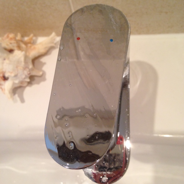

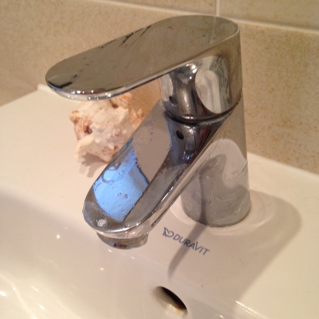

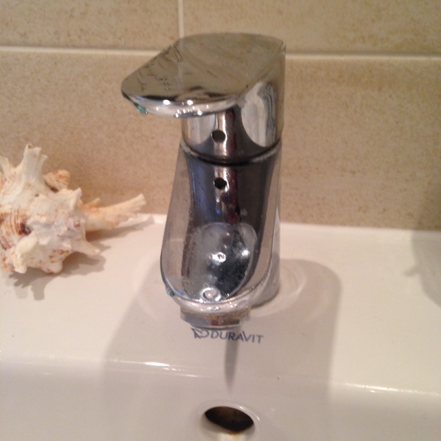

Firstly can someone identify the brand of mixer tap in the pictures please.
Secondly has anyone had experience of selecting cold water but getting hot water instead. The water does eventually run cold. This is a new problem affecting 2 mixer taps in my son's house.
Taps will be a couple of years old. Other outlets at the property are OK. We are therefore suspecting the taps.

Judging by the word "hansgrohe" written across the top of it, I'd hazard a guess that it's a Hansgrohe branded one....
It sounds like you've got hot water creeping into your cold. What kind of hot water system does your son have?
Whoops. I hadn't seen the writing on the tap or visited. I just asked for some pictures.

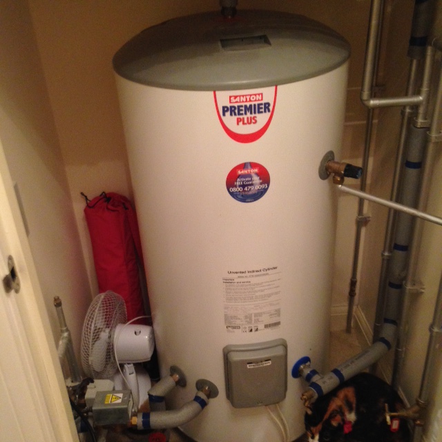

I am pretty sure it is an unvented cylinder. I'll get another picture then we'll know for sure.
The house is a new build about 2 years old.

Here is an image of the cylinder.
I presume that as there is no cold water storage then all cold water outlets are fed directly from the mains ?
I understand re unvented cylinders so won't be touching it but if its the taps then....

Looks like a Hansgrohe "Focus". Their stuff is expensive, but in my experience, very reliable. If the two problem taps have been working OK for two years, but have both suddenly malfunctioned, I think I'd be looking (as other have said) at an unbalanced pressure problem. Any unvented hot water cylinder and associated controls should be serviced annually by a suitably (G3) qualified technician. Such a service wouldn't be a bad starting point for the investigation.
