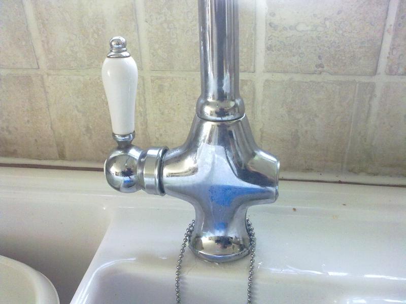

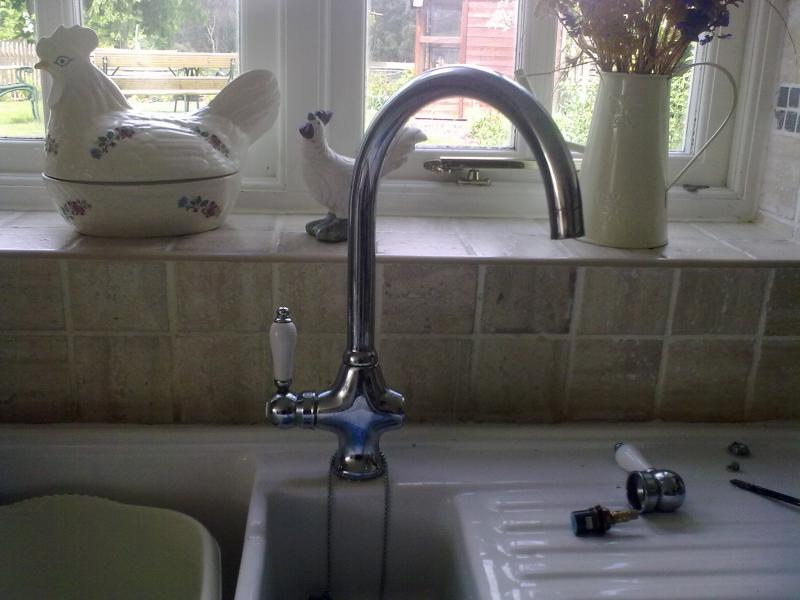

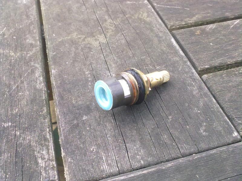

Identify taps need new ceramic cartridges
don't need that, just see how many splines and how big the top is, and how much it protrudes.
chances are its the same as the ones sold in b&q, i only say this because they have them on display and easy to check with what you have
Ok thanks for that, was looking on Ebay & there did seem there might be a standard
No standard tap cartridge.
It will be 1/2 inch where it threads into the tap body but apart from that they will be different from various manufacturers
If you look at the Lunns site as suggested by denso13 you will find that there a thousand and one types of cartridge, so a 'generic' cartridge would be impossible.
