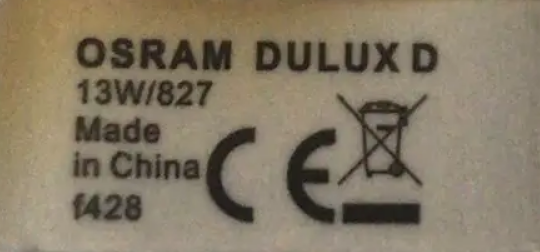

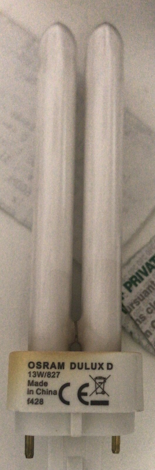

Could I please get some help identifying the model number or type of bulb I would need to seek a replacement for on Amazon.
I’m trying to find an LED equivalent as they seem to keep failing often from the spare set that was left for me.
I thought it might be Dulux D or /827 but I have other makes of similar bulbs with their own unique reference which makes me trying to identify a generic model number for these bulbs somewhat difficult.
it is a miniature fluorescent that plugs into a lighting fitting that contains its own electronic control or ballast.
I think yours is called a Dulux 2-pin and they are still made by Osram. Your pic does not show the base clearly. It might be G24d-2

Any idea what the 827 relates to because I dont think its a model number as some of the other bulbs have different numbers. I looked on amazon and its not the lumens output.

This
shows what you need to replace it, but the LED's marketed to replace the CFL are not easy to select, the Osram Delux D 13W/827 with a google hunt comes up with loads of hits, there seems to be a 4 and 2 pin version, and at £6:20 for 2 pin version not over expensive. But we all know the government has decided mercury is more dangerous to arsenic so fluorescent is being phased out, so is it worth getting a stop gap?

827 allegedly is the colour temperature designation: 2700 K or (very) warm white. Colour TV camera line-up temperature - dimmer fader 7 on tungsten halogen lamps (3200 K at full volts) back in the day.
900 lumens and a CRI of 80
May be important if to match with others?
