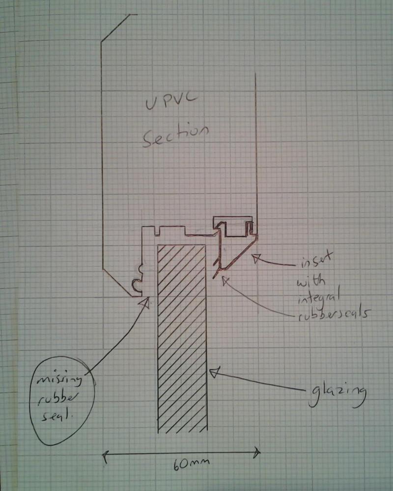

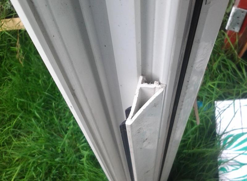

I have a large 'pair' of french doors which have no glass or rubber seals.
I'm trying to identify the profile so I can find the correct rubber seal and glazing thickness.
I've made a reasonable - although incomplete - drawing of the profile and a couple of photos which might help.
I know little about rubber seals except that it appears that most are of a few basic designs.
Can anyone help identify the seal or point me to somewhere I can find out?
Looks like all you need is a wedge gasket, put the glass in put the beads on and measure how thick the gap is between the glass and the frame, order wedge gasket, push it in ..done
Thanks, I didn't know they were called wedge gaskets!
Half the problem is don't have the glass so I can't measure the gap (and vice versa). It looks to be a total gap of about 34mm. Is that likely to be a 16mm spacer, two 6mm panes and a 6mm gasket?
