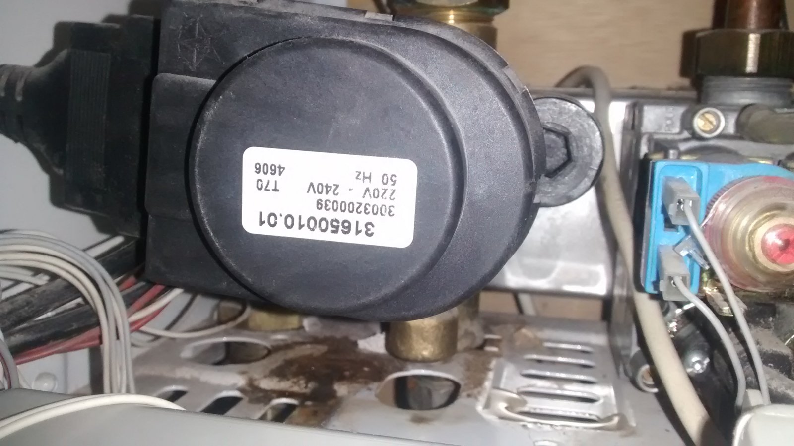

An engineer wouldn't quote for repairing this slow weep/leak from inside my boiler, they said they were unable to identify the part required. Does anyone have any idea what this part is and what's likely to be involved in having it repaired?
(I am about to download the installer's manual and go through it and possibly contact the manufacturer (Heatline) to find out what the part is called, but I thought it would make sense to ask here first.)
Having looked at the manual, I believe the part that is leaking is called the 'Three-Port Valve'. The pictures above show the actuator motor in place and also removed so that the source of the leak can be seen.
Can this fault be repaired (it seems to be leaking from the pin that sticks out), or should the whole thing be replaced? Thanks
It's a Heatline compact s24, thanks.
The diverter repair kit seems like the obvious thing. Any idea why an engineer might not be keen to take the job on? Too small?
AFAIR when these boilers began to have issues you could only buy the complete diverter from Heatline at an extortionate price so he may have thought it was a non starter...or he was planning to come back and suggest a new boiler...or just plain incompetent.
I see. I looked online to see the kits are less than £10. I'll buy it and look for another engineer. The kit looks pretty simple, I guess it would take an engineer less than 10 minutes to fit one?

I very much doubt it's an S24, looks like it's a combi. C24 maybe? And no, draining the boiler and possibly your heating system as well, removing, stripping down, refurbishing, refitting the DV, and refilling it all and testing to check it works won't take "less than 10 minutes". Maybe your engineer didn't want to take the job on because he could tell you were going to have unrealistic expectations and were also likely to expect an unrealistically small invoice once he'd done it?
would not be surprised if the diverter valve actuator is also Knackered now

The source of the leak should have been identified within a few minutes, the Heatline spare for it is close to £200, but I would expect any half decent engineer to atleast tell you thats whats wrong and give you the option of a repair, even doing the full block is less than an hours job, although if the kit to repair it works then thats great, however as said, it quickly damages the electronic motorised valve heads so if your continuing to use the boiler at the moment be prepaired to fork out for one of them aswell.
Good to know, thanks. I did see the repair kits with the same part number listed for £50 -£70 from some plumbing supplies websites.
