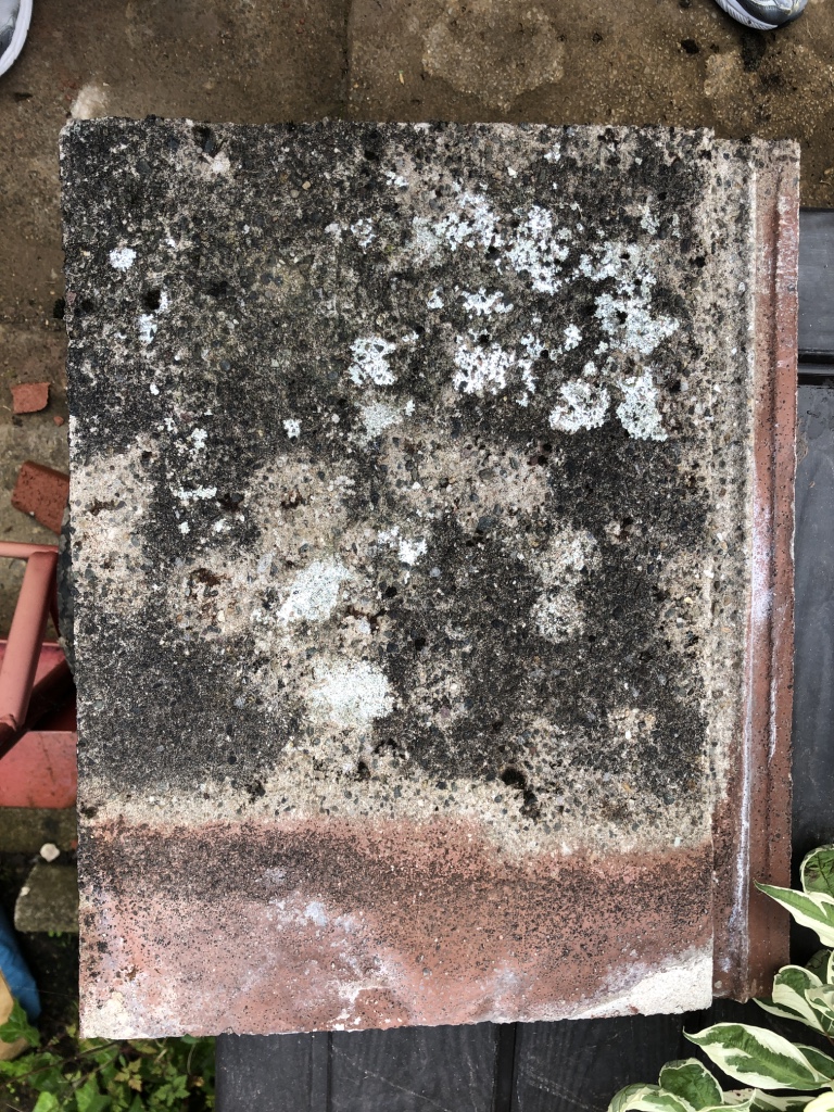

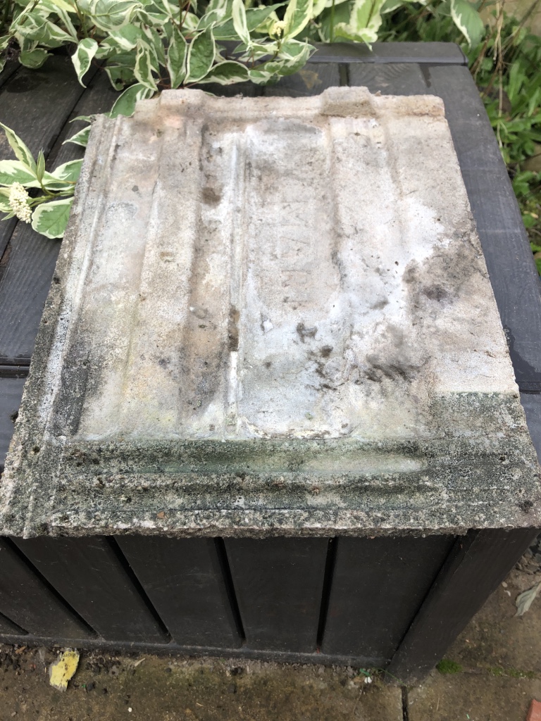

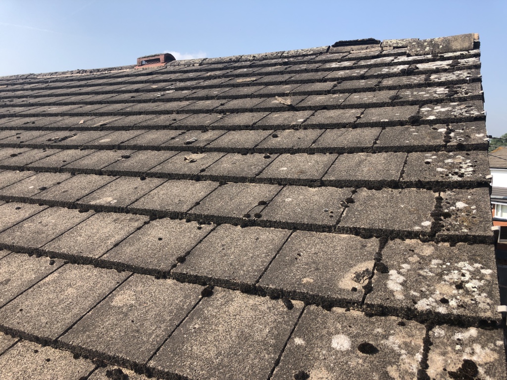

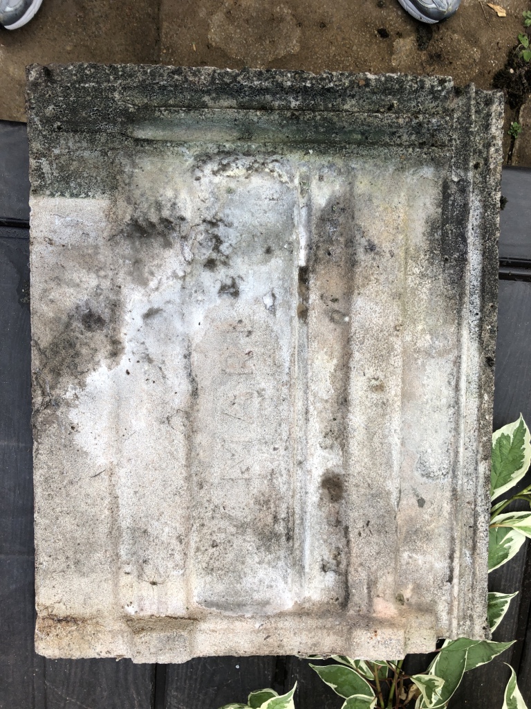

I wonder if someone could offer their experience. This pictured tile is what is currently on the existing house. It is 410mm x 310mm in size.
It is evidently a Marley tile but is it a modern or something else? I guess these are the original tiles from 1975 when the house built.
What tile can i use on my extension and will the new tile slot into the groove of these old tiles to "carry on" the existing to new extension roof?

its a Marley modern.
i have a few hundred in my yard.. but a long way from Manchester.
new ones will join in
