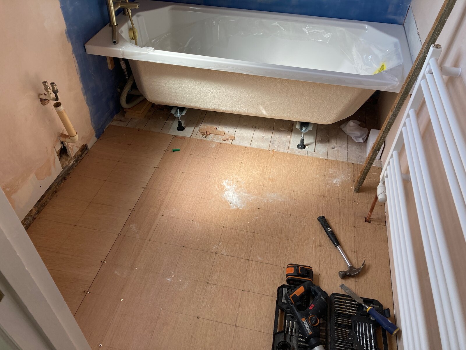

I'm in the process of ordering everything for a bathroom renovation and was planning to buy Karndean Knight LVT to install myself. The room is about 2.75m2. The current floor is made of hardboard nailed to the floorboards, with peel and stick tiles from Poundland that I put down many years ago (aided with some regular floor adhesive). It has held up very well despite the cheap flooring so I was feeling quite confident in my ability until it came time to actually place the order!
I just want to check that I have all the stuff I need before I pull the trigger and buy the flooring. I'm assuming I need new hardboard (and condition it with water), adhesive, measuring tools and a good knife, patience, and knee pads. It's such a small area that I imagine that an ordinary household rolling pin will be sufficient for going over the planks once they are glued down. Am I being wildly over-optimistic here? Should I buy an offcut of lino instead??
And find some patience - the plywood should be nailed with something like 19mm ring clouts at 100mm centres (that's 325 nails per sheet)
That seems like a lot of nails for an area less than 3 square meters. The current floor is nothing like that. Why are so many suggested?
It is the industry standard, certainly for 5.5mm plywood going down beneath LVT such as Karndean. On my current project it has been specified for all areas where LVT or roll vinyl is to be fitted subsequently. We install the ply as part of the sub-floor prep and the floorers put down primer followed by SLC before the finished floor goes on
Bear in mind these are only 2mm nails, and that you need to ensure that the plywood has minimal voids beneath it where the original boards meet, repair sections, etc are and that the ply cannot flex, which you really don't want. This way leaves you with a relatively flat and very stable floor almost regardless of what lies beneath it.
Board with 6mm marine ply as suggested above. I used 20mm screws at 150mm centres

Thanks all, this is helpful. Seems like I might have just been lucky with the existing floor because I don't think it had anywhere near as much prep! The difficulty is that I will need to do the floor after the installers have put in the new bath & toilet etc. so I'm not sure how to deal with that if I'm putting in new plywood, other than cutting it around the toilet. Maybe I should ask if they can put the plywood down before they put the toilet in, at least.
It's certainly a lot easier to install plywood with the basin pedestal and toilet pan out of the way (BTW the same goes for installing the finished flooring). I've not long plied our bathroom floor - it being an existing bathroom the bath stayed in place, as did the sink pedestal but the toilet pan and close coupled cistern came out (about 10 to 15 minutes work). Cutting round the bath (panels removed) was a doddle - cutting round the sink in 5.5mm ply took a bit (lot) longer and TBH the only reason I didn't take the pedestal out was that I was being lazy. When I (eventually) redo the room I'll lift all the ply and lay a whole new (cement board) floor in one go before I install the new bath suite.
