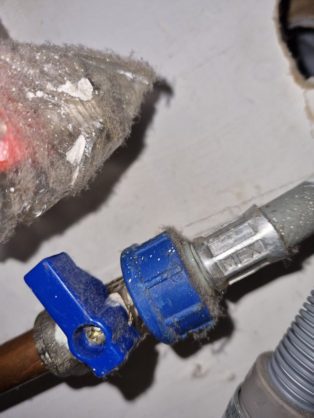

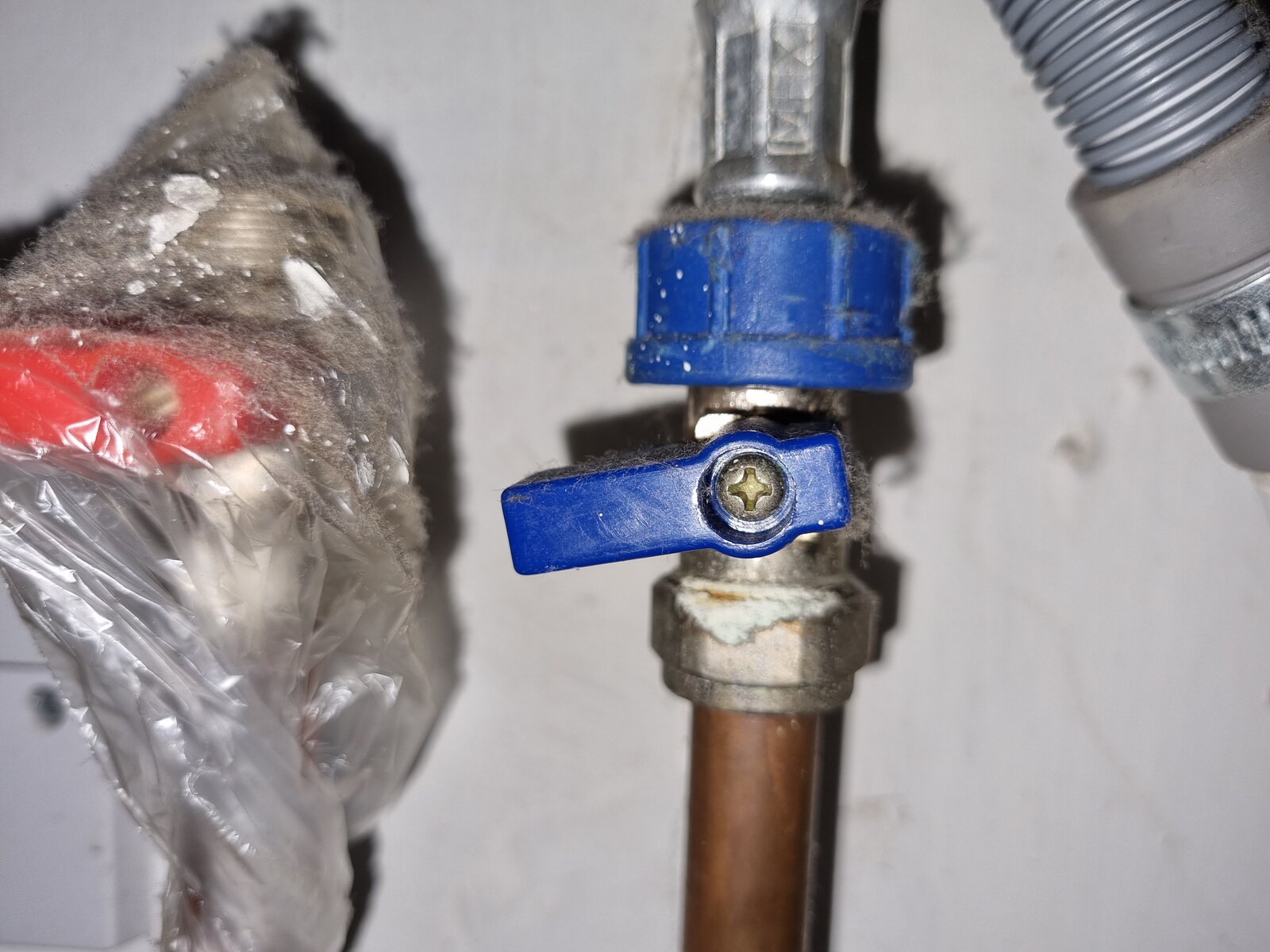

Apologies as this is a bit of a cross post. I've had to try to isolate my washing machine hose tonight for it to be replaced tomorrow night.
When going to do this I noticed that the valve wasn't fully open/vertical. I've tried to close it and can't get it fully horizontal. Had a bit of a Google search and seen comments similar saying that it indicated the valve was faulty and when re-opening it started to leak.
Looking at the 1st picture below it looks like it might already have been taped up from a previous leak?
My question is, should it start to leak tomorrow night when re-opening, what are the options? Can it generally be fixed (even in the short term to get me through to next week)? And if not, how difficult are they to replace?
Very easy to replace. Turn off the water at the mains, loosen the nut, fit a new one using the existing nut and olive if they don't come off easy.
If re-using the nut and olive - no reason not to as long as the olive isn't misshapen - buy a roll of Gas PTFE tape and put a wrap of tape around the olive, minimises the risk of leaks.
