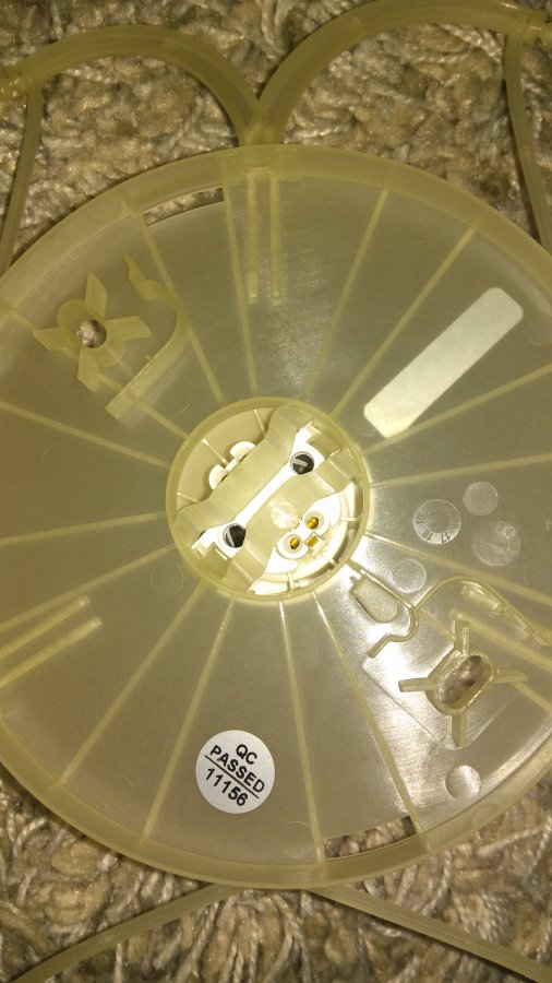

I bought this Ikea light fitting at the weekend it was very cheap that aside it's for a cupboard and I noticed that it does not appear to have anything marked for live or neutral connectors nor does it have an earth connection point as its all mainly plastic.
Question is what do I do with the earth white and does it matter which way the live neutral go??
Sleeve the earth wiore in green/yellow sleeve and put the end into a small terminal block. ( which you will have to supply ).
If the lamp ( the bulb ) is bayonet cap ( push and quarter turn ) and there is no switch in the fitting then it does not matter which way Live and Neutral are connected.
If the lamp is screw cap then the Neutral should go to the terminal that connected to the threaded part of the lamp holder and the Live to the central pip of the fitting. Not essential but it reduces the risk of electric shock when changing a lamp and touching the metal screw after forgetting to ensure the light switch is OFF
