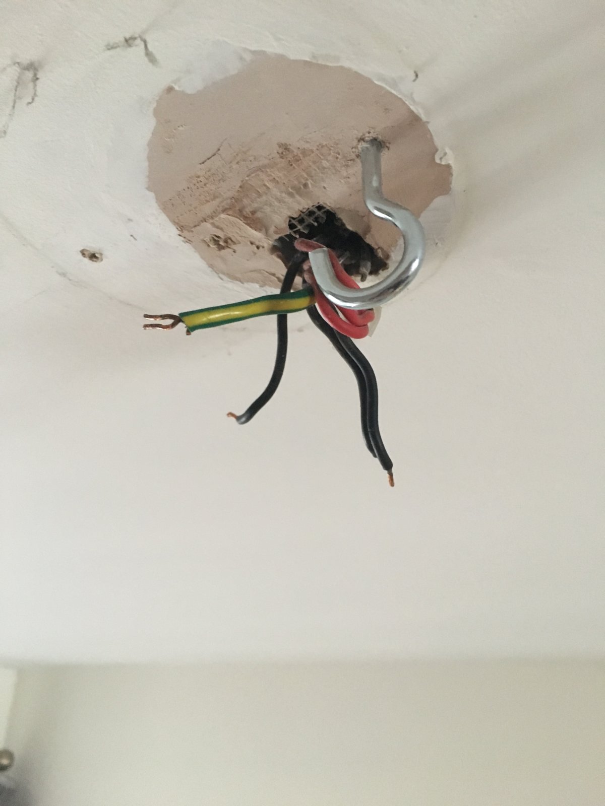

I have bought a light from Ikea with a live and neutral box. On removing old light I have found three black/brown wires, a earth wire ( not needed) and three red wires attached to a terminal.
Anyone know where to attach the three black/brown wires to the live and neutral terminal on the new Ikea fitting?

You connect the live and neutral of the new light to the same wires as the live and neutral of the old light were.
Conventionally that would be live to the single black and neutral to the other two blacks.
If not needed. put a terminal block on the earth wires so that they are connected together.
There should be three earth wires. The picture seems to show only two. Make sure all are sleeved in GY sleeving and all conductors are securely attached to a 5A terminal block or Wago.
The three reds can be left alone. They only attach to each other, not to any other wiring.

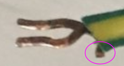

I think I can see a third earth wire, cut a bit short and therefore probably not connected. (Need all three connected to each other.)

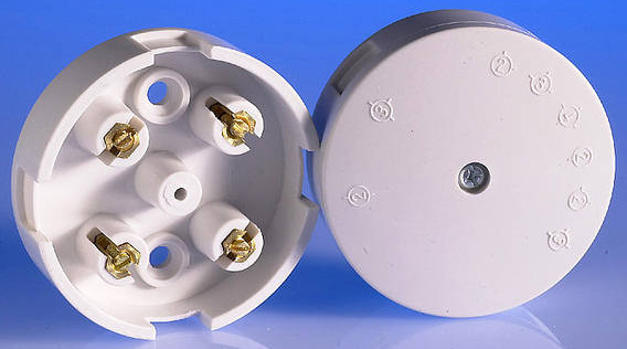

A junction box somewhere close, with flex running to the light.
Traditionally a round JB like this was used:
These days I suspect a maintenance free one would be more likely.
