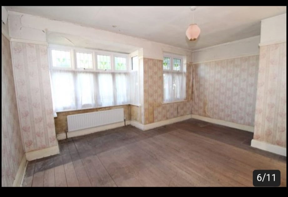

You can see in picture below both side external walls (front of house with windows). The gap is around 4m across.
The small wall on the right was a cupboard that was not load bearing at all.

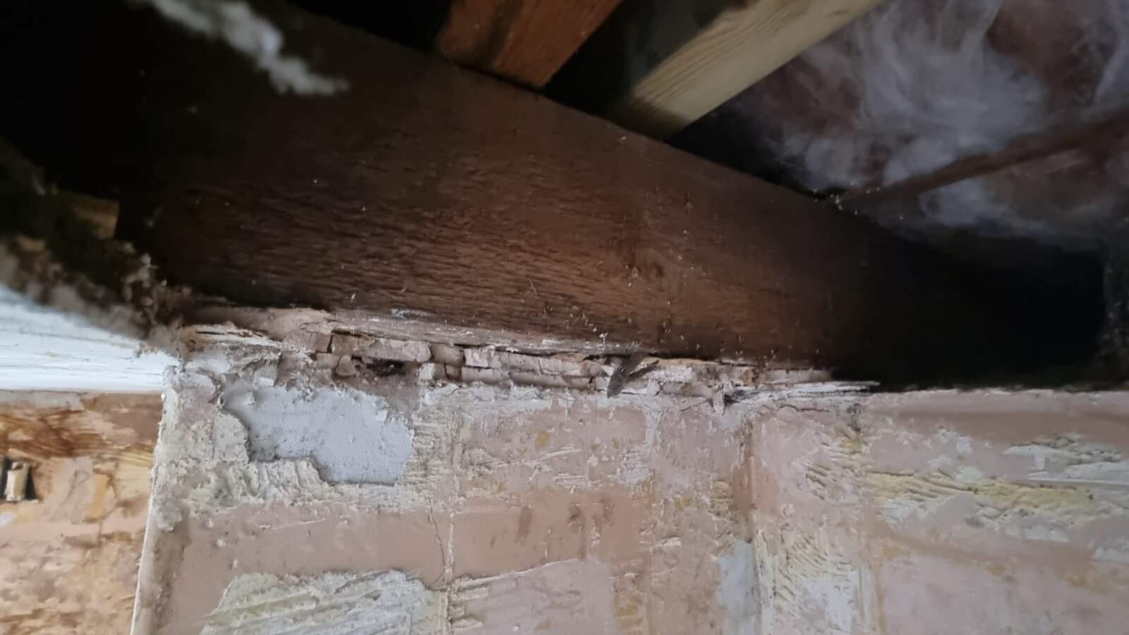

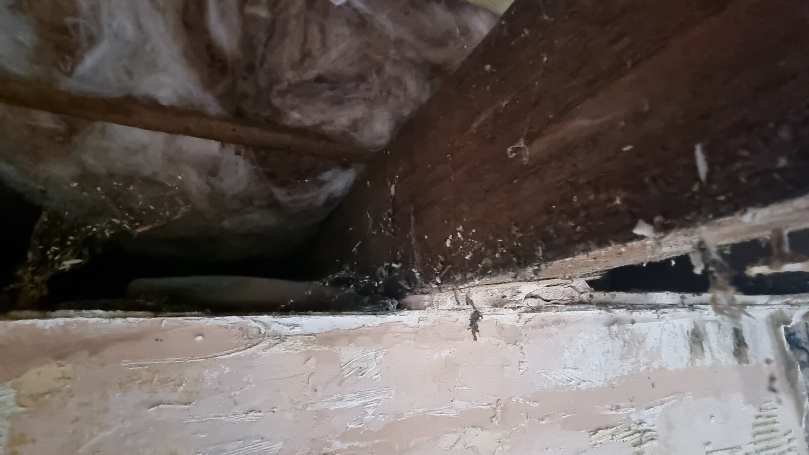

So in the rear half of the house there are two rooms split by a wall. I don't think this is load bearing based on the following photos. These are the joists and the wall looks to have been built up to them as the plaster board is between the joist and the centre wall.

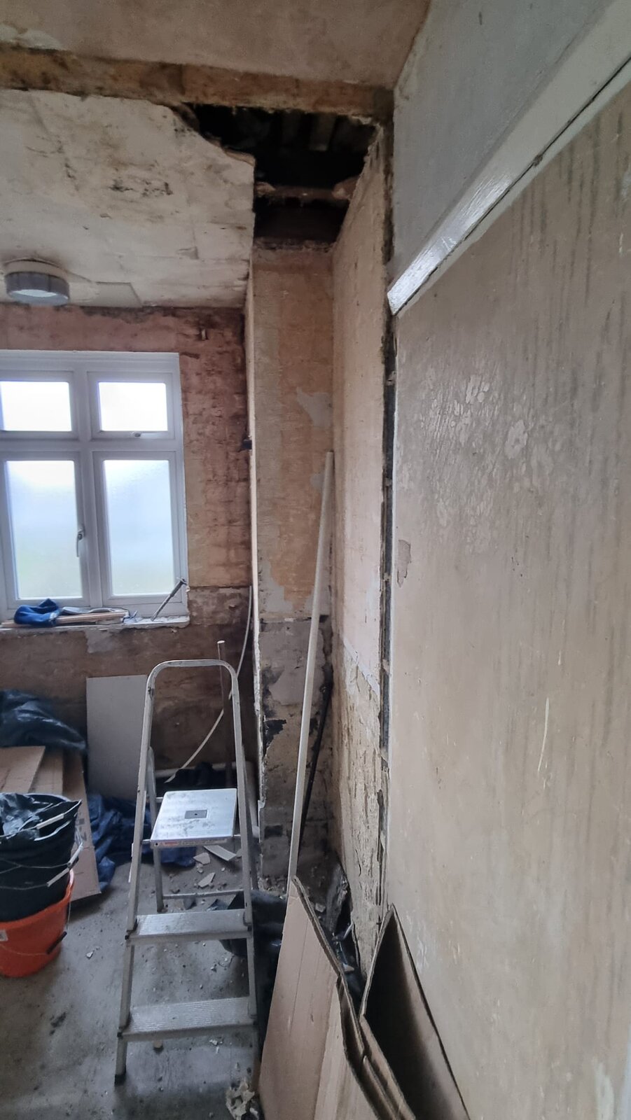

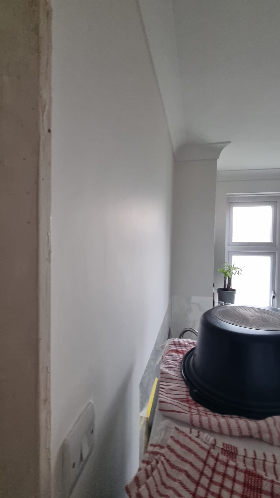

What I want to do is remove the portion of wall at the rear that you can see sticking out in both photos (part in either room)
They are made of breeze block and laid on the floorboards and the ground floor underneath does not match the shape.
The joists are 100mm x 55 and spaced 350mm centre to centre
