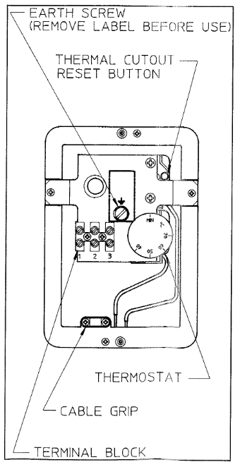

Can someone tell me which of these holes is the reset button on this fairly old Megaflo emmersion please?

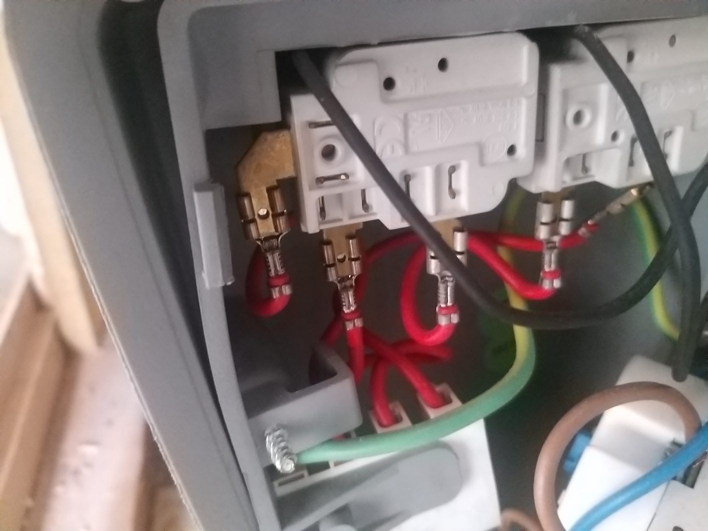

In the main we only use re-settable cut outs where multi fuel DHW heating is used, don't want to renew a immersion heater cut out because the solid fuel fire was running too long, it is considered if the cut out is triggered using just the immersion heater the immersion heater thermostat also needs renewing. So when electric only DHW is used the cut out is often not re-settable.
