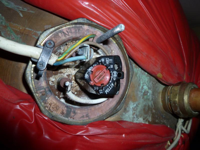

I would welcome some input regarding a problem with my Immersion Heater. It suddenly stopped working - the neon light in the switch was out, and the fuse has not tripped.
I therefore assumed that the immersion heater element had packed in. Visit today by British Gas engineer (immersion covered by service contract). He checked things out and advised that there was 240v at either side of the immersion heater element and 'therefore there must be a break in the neutral wire - somewhere'. He said because of this it could not be the element itself. He then told me he was not an electrician (gas fitter) and I should call an electrician for help. Before taking further action I would appreciate any comments on whether what he said actually makes sense?? Interestingly, (and I don't know what he fiddled with) I note that the neon light in the switch IS now glowing (seems a bit dim) but the immersion still does not work.
Any advice gratefully recived! Thank you.
if there is 230V present on both sides of the element then it suggests there is a break in the neutral conductor. The most likely place would be the switch.
If you feel up to it then you could test the switch using a voltmeter or polarity tester or you could isolate the power and join the wires together (by-pass the switch). You may find the wiring melted out when you remove the switch (loose connection).
I take you have no time clock?
The only other place could be the Neutral connection in the consumer unit but in my experience the problem is either in the immersion element head or switch(s) controlling the element.
I wonder if the engineer checked for a secondary stage cut-out within the element head?
Has the immersion tripped?
Can you post a picture of the immersion with the cap (top) off.

New switch now fitted - neon goes on and off OK but immersion heater still not working.
Just a thought (and in the absence of any circuit testing tools) .... if I were to disconnect the wires from the immersion heater and connect them across a light fitting/bulb holder, then if the light bulb came on and off OK would this prove that the wiring circuit was OK and that the fault was in the immersion heater unit itself??

My advice is to fit a new immersion. We can tell you what to do if you need help.

Problem solved! BG has now replaced the Immersion Heater element under my Service Contract, having convinced them that I'd checked the wiring circuit for faults.....
