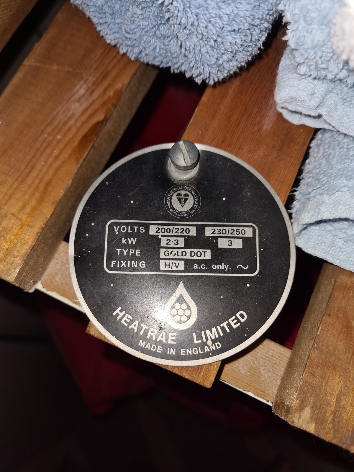

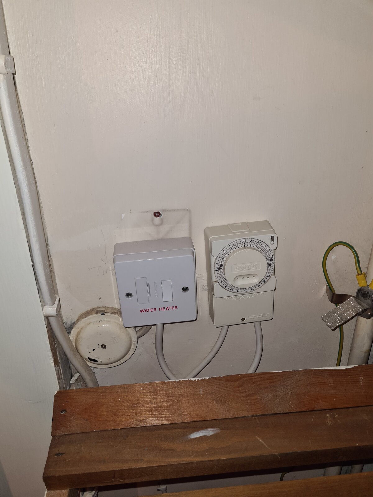

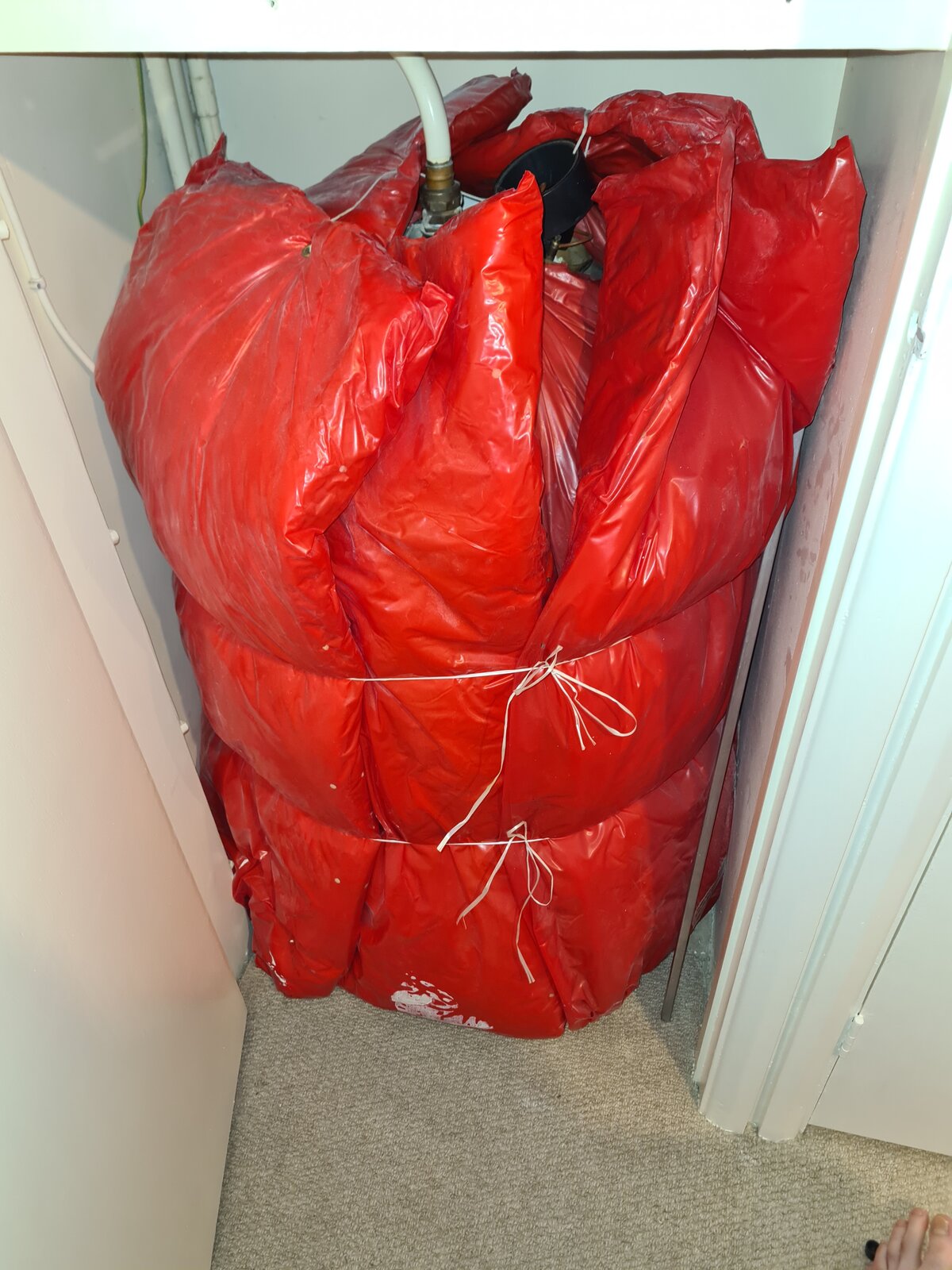

My immersion heater seems to be tripping one of my RCDs.
If I have the switch (labeled Water Heater, directly next to the heater vessel) all other appliances on the RCD work fine and do not trip. As soon as I flick tha switch (even if it's not currently on a heating schedule) it trips the RCD instantly.
I'm pretty handy at DIY and on the tools but not really had to deal with heaters like this. What should be my first port of call? I have attached some pictures:
Boiler vessel:
Thermostat/element:
Switch/electrics by vessel:

You will need the element, new matching thermostat and the special big spanner to fit the boss. A blow lamp, plus gentle taps with a hammer might help free it, if it's seized, and it will need to be drained first.
As above but don't drain first only drain when loosened.
Good point - but he will not be able to drain the water from the cylinder, he will only be able to drain the tank and pipework which lies above the tank. Hence, expect some water to come out, once the immersion heater is released - have lots of towels ready to catch the few pints which come out.
