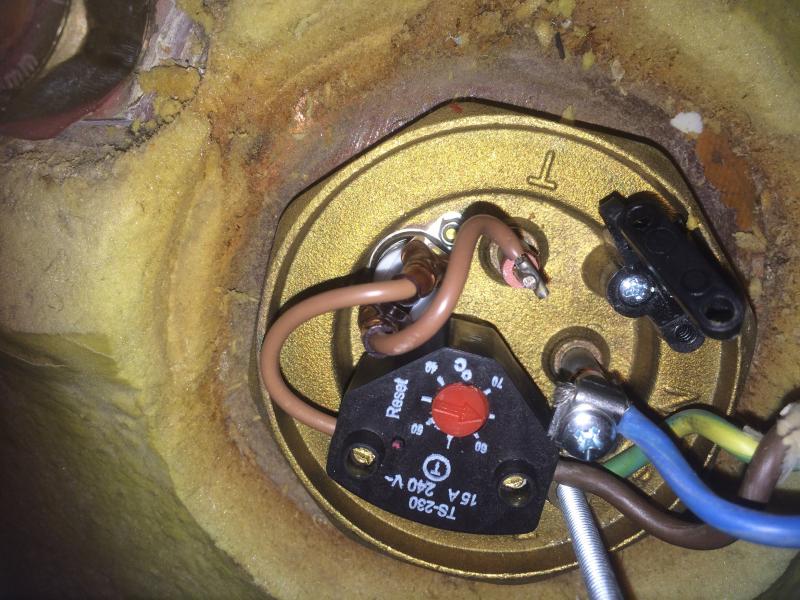

So I need serious help - please help me
I have no hot water. These are the steps I've taken.
- check main fuse box ALL GOOD
- check / replace fuses connected to immersion heater ALL GOOD
- check all wire connections under cap on heater ALL GOOD
- the element was replaced in September
- replace the thermostat, check wiring ALL GOOD
The tank is filling with water but it is not hearing my water.
Any advice, ideas?
Thanks in advance

is the hot-water cylinder heated solely by the immersion heater, or is it sometimes heated by a boiler?
Was the hot tap-water curiously hot before it stopped working?
A photo of the heating connections under the cap, after you have isolated electrical power, might be useful.

Immersion heaters which are the only form of water heating have thermal fuses and the header tank can be thermal plastic. Where there are multi-forms of heating a cut out is used as the other devices could cause the over heating so a cut out is used which can be reset and the heater tank is designed to stand boiling water.
The small silver can mounted on the base plate is likely a thermal fuse/safety cutout.
If you follow the live wire, you see it comes into the main thermostat, leaves the thermostat and goes to the cutout, then continues on to the element terminal.
The idea is if the main thermostat fails on, then to stop the tank boiling and creating a serious hazard the safety cutout "pops" and shuts the whole thing down.
It may be resettable, or it might require replacement.
You can use a multimeter to test for continuity thru the main thermostat and then the cutout, with the power safely isolated. Or you can just have a look and see if theres a reset button on it and press it.

People keep mentioning an over heat/re-set button I can't find this anywhere.
I've uploaded photos - hopefully this will help.
I've still no hot water
It's a new termastate the button is a little piece of hard plastic I've tried pushing it, it doesn't move.... But I'm now going home to push it harder :)
On that immersion head, the overheat reset button is the silver device that has two brown wires going to it. It is situated at about 10 o'clock in that picture.
Cannot see the button as the brown wire is covering it.
TURN THE POWER OFF before poking your fingers in there!
If not then I see that you have timer on that immersion. It is possible that the timer is knackered, or there is a bad connection in there, or in the FCU.

With the age I would say likely it is the safety cut out but it needs testing.
So take a picture and also say what you have as far as test gear goes. Even a door bell can be used with the wires that normally go to push button being used as test probes will still call it belling out a circuit even though in most cases we use a buzzer or meter. But clearly power needs to be off when using something like that.
eric - the photo I posted is the OP's, he just didn't add them to his post, so he does have a reset

I would suspect that she eventually managed to press the reset button, after it's identity/location had been explained to her. From what I understand of the OP, she had already replaced the thermostat - so I suspect that it was the death/malfunction of the old thermostat that had caused the thermal cutout to operate. If so, it proves that these thermal cutouts have their uses!
