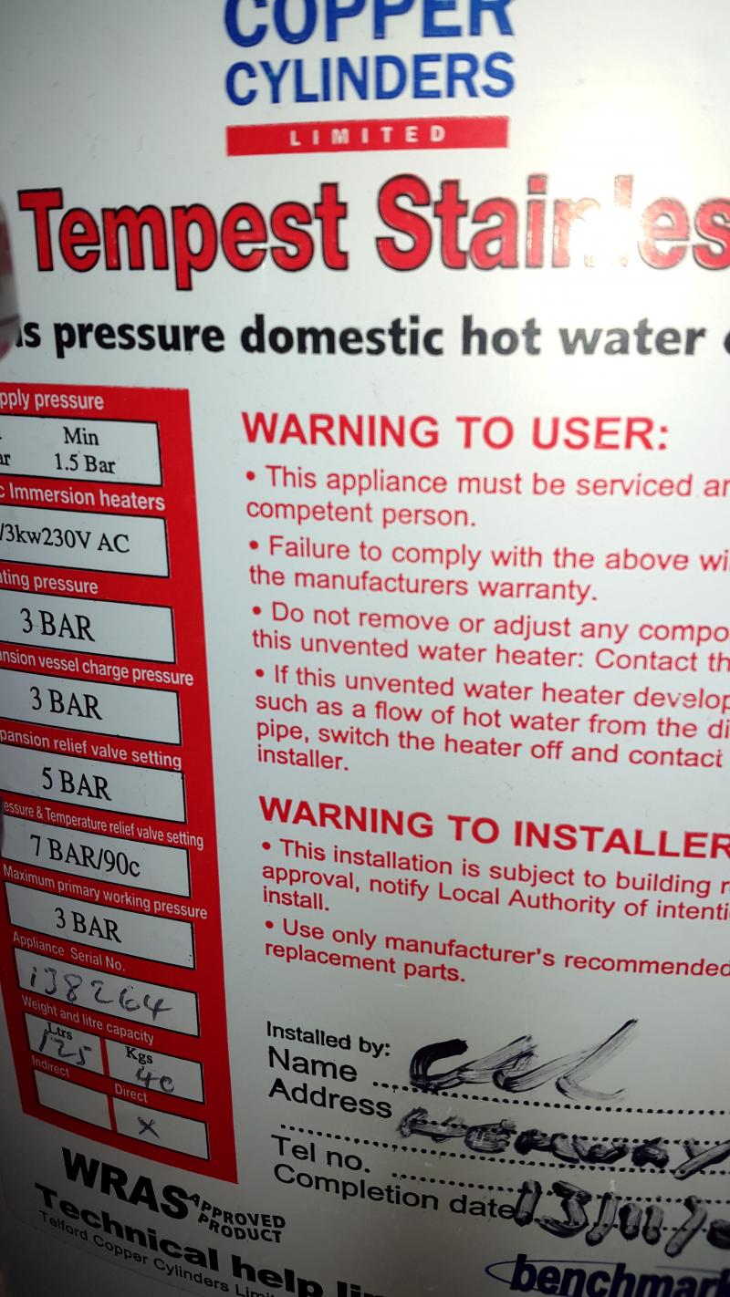

I own an apartment which has a water tank 2 immersion heaters and a timer.
Recently I have been getting extremely hot water then one day I got no hot water at all. A plumber came round and had a look, my timer appears to be faulty along with one immersion heater always being on the emergency thermostat and the other just totally bust.
Alongside this the top one was leaking slightly on to the bottom. The plumber was meant to get me a price for some parts and come and fit them however my efforts to get in touch have proved rather difficult so I would like to purchase and have a go at fitting these myself.
I have purchased a new timer however I believe I require 2 full new immersion heaters along with a new rubber seal of some description to stop the top one leaking. Can anyone help me out since I am clueless what to get?
My tank has the dimensions:
Diameter 50cm
Height 90cm
I have attached images of the specs and immersion heaters themselves. Any help is much appreciated!
You have an un-vented direct hot water cylinder!
This must be serviced and repaired by an engineer that is qualified to do so, not just a plumber nor yourself as it can be dangerous if not done correctly. Please confirm whoever does the work has the correct quals (G3/UVHW) before doing the work.

+1 for Rob's advice. Those things are good but can potentially be a timebomb if not maintained properly! :eek:
You may also like to note, immersions don't always want to come out without a fight, and it is easy to damage the cylinder trying. Any cylinder is expensive to replace. the unvented type more so! :cry: It is not unknown for a blowlamp to be required to remove a really stubborn immersion!
The cylinder is only eight years old and I would expect that the element will come out without too much trouble for anyone who has the right tools.
I use a 36" stillson on a socket fitting and that is usually adequate. It it will not unscrew then the cylinder is likely to bend and usually fail and have to be replaced.
