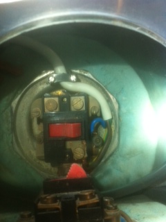

But the repair is easy enough, as the thermostat is in a pocket, so you don't need to drain water to change it, this picture
one can see the little reset hole, today all thermostats should have the cut out built in, older types type it was often a separate device,
and it was easy to install the wrong type and for the cutout to be missing.

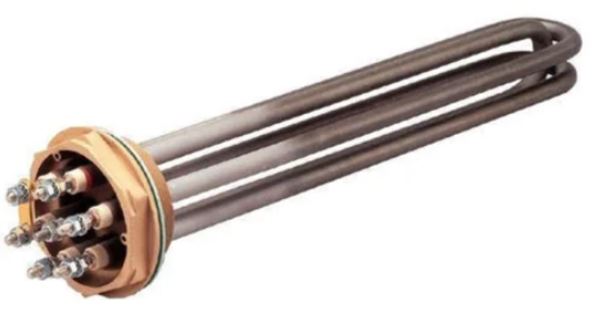

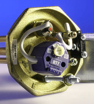

How odd, and clearly not safe. We do it seems still get independent cut outs and thermostats 1718097269509.png and there are some combination units 1718097591034.png this one shows a fuse, two contacts, with temp settings, and reset-able cut out, even a warning light connection. But I have only seen commercial immersion heaters where there is no thermostat. Never seen it with domestic. this one 1718098025173.png is designed for oil, and three phase with no thermostat so clearly you can get them, but it would be very unusual to get one in domestic situation.

There may not be a rod type stat but there almost most certainly will be a contact type stat in your immersion like my 52 year old top mounted dual element immersion with its change over Sink/Bath switch mounted conventionally!! on the top of the immersion.
Can you post a photo please of your one, cover removed.,
