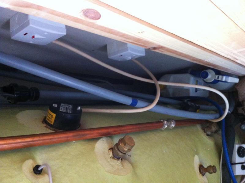

Thank you both for your replies. I will post some pictures when I get in. If the e30 can't be on the economy rate I've got a theory which I can test. In the boiler room itself the switches for the heating elements are placed one above the other and I noticed they are wired weirdly. That is the top switch controls the bottom, economy 7 element and the bottom switch is wired to the top element. I wonder if the e30 is on the bottom element incorrectly and the top element is trying to come on in the night with the economy 7 rate.

So I've swapped over the 2 switches and now the e30 boosts the upper element. Here's hoping the lower element now comes on overnight on the economy 7 tariff...

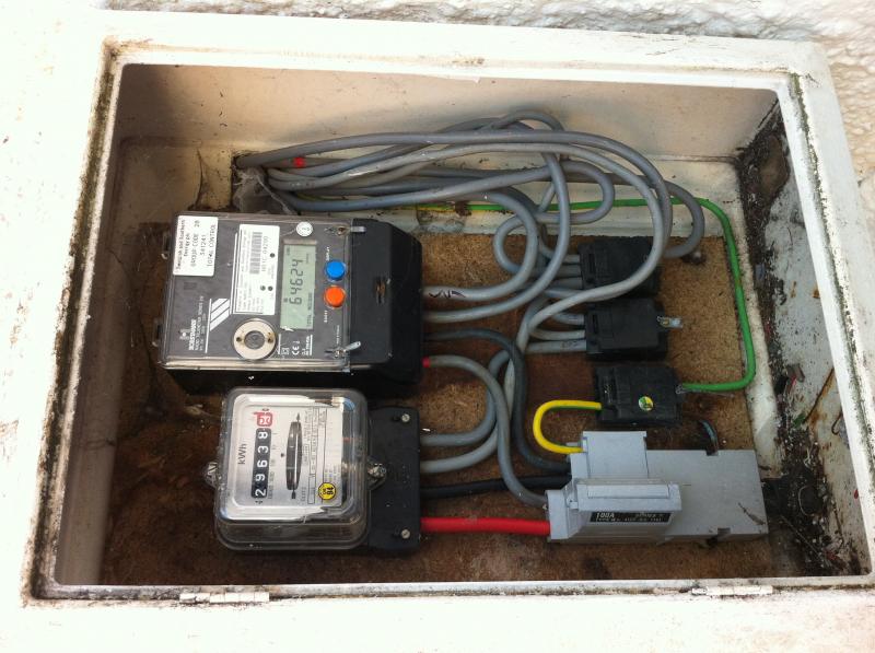

Hope the photos are of some use. As I say the switches in the boiler room were wired oppositely tho this shouldn't have mattered as long as the sparky fitting it knew that and wired in the e30 to the boost element and the main element to the e7. Fingers crossed.

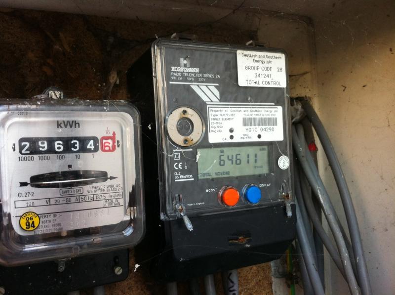

the horstmann box beside the meter contains the timeswitch. Stand back and take a photo showing the runs the cables take between the meter, timer and consumer unit please.
Ah so the timer is actually next to the meter itself? Thanks for that. Unfortunately the meter is outside and the boiler is miles away upstairs in the house so I can't get a photo of it all together. Reckon I may set the alarm and check that the lower heater element comes on in the middle of the night. Or at least check temps tonight and tmrw am to see if it has topped up overnight. Thanks again.

I meant the Horstmann timer, not the one by the hot water cylinder (it is not a boiler). The number of thick cables, and how they are connected, may be of interest. There are two ways off-peak circuits can be connected.
Its clock is radio-controlled, so they very rarely go out of adjustment, but it can happen in a cellar or other location where there is a poor signal.
It will also be interesting to see a photo of the consumer unit(s) with the flap open.

I wonder how the circuits to the immersion heaters got crossed over.
That looks like a dual-tariff board.
"bedroom", "bathroom" and "24 hour water heater" look like 24-hour circuits. on the other half, "storage heater" and "storage water heater" look like off-peak.
The 24-hour half of this board is probably supplied from the left-hand (main) meter through the henley blocks.
It also looks like a Scottish "total heat total control" tariff. SSE / Hydro have a monopoly on this tariff as it uses 2 meters, 3 rates, and other suppliers can't bill it properly.
If this is the case then the dual tariff heating board has been wired up wrongly through the henley blocks. It should probably have been wired completely to the Meter-Teleswitch so all your heating is charged at the lower heating rates. There is probably a 'boost' button on that Teleswitch which will give a boost to the off-peak heaters (storage heaters, and bottom hot water cylinder heater) during the day, at the off-peak rates.
Meter 1 - a standard single rate meter meter (MPAN#1, first 3 digits on MPAN normally 171) This meter measures the Domestic supply (lights, sockets, cooker etc) This is a 24 hour supply....no point in putting washers etc on at night as it does not have a cheap rate.
Meter 2 - is a radio Telemeter (MPAN#2, first 3 digits on MPAN normally 172) This meter measures the heating supply and can have 2 or 3 seperate outputs as follows-
- a 24 hour supply for any panel/convector heaters in the house.
- An 80A switched supply, for the storage heaters and hot water (overnight charging).
- A 35A supply for 'boosting' the hot water through the day...if connected this is done by the meter, but can be done manually...if not connected then the boost is supplied through the 24 hour supply.
