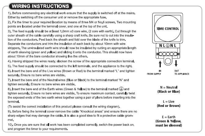

I have found the wiring instructions, which no where specifies the need for an additional switch - see attachment.
Perhaps if I can be explained why only a timer shall not suffice. When I do wish to completely switch it off (when on holiday), I just need to pull the segments out to disconnect - isn't it?

he immersion instructions do. See wiring - section 2
http://www.heatraesadia.com/docs/Immersion_-_Issue_3_-_36005868.pdf
That is the point - the timer will only disconnect the live conductor.
For isolation the neutral must be disconnected as well.
Should a fault occur between neutral and earth switching only the live will not isolate the fault.
If you have RCDs protecting your cabling this could result in half (or all, if only one RCD) of the circuits in the house being disconnected until the fault is isolated by actually removing the wires from the immersion - instead of just switching off.
However, the link above (lead to by streetlighter's post) does show a timer which includes a double pole switch.
Unfortunately it also contains a 13A fuse which, if your immersion is wired conventionally, is unnecessary and in my opinion undesirable.
The safest way, is to leave the existing switch in situ, and place the timer in between the old switch and the immersion element. This way you have both functions available, i.e. the timer controls and the Holiday Isolation, where the existing double pole switch is turned off when on holiday. :LOL: :LOL: :LOL:
