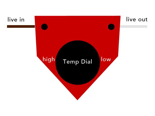

One further question. The thermostat wasn't marked to say which side the live wire goes in. The unit is almost identical to old unit and I couldn't remember which side live wire went. However, seems to only fit well one way. Anyhyhow I've drawn a diagram. Do you think this is correct side for live wire? Does it matter which side it goes in?
thanks
Forget that, I have the answer. I opened up the old thermostat.
It doesn't matter which side the live wire goes in cos the on/off switch is controlled by expansion and not electronics.
