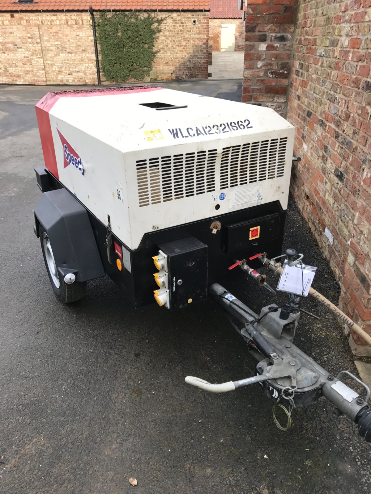

First the equipment, compressor, hoses, oil pot, mole and launch gear.

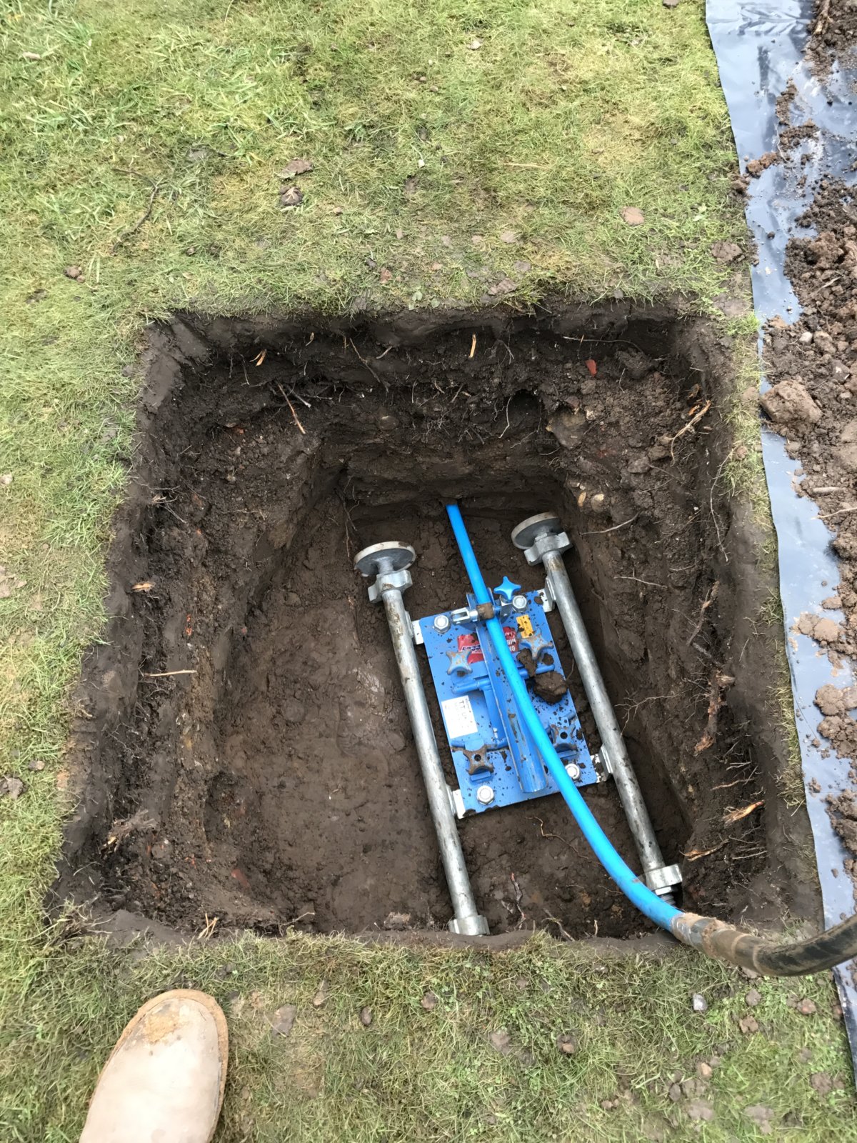

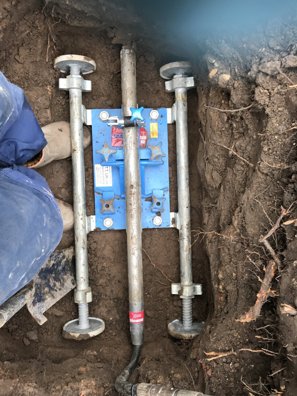

You can mole about 10mtrs at a time, further in good ground, less in bad ground, so dig your 2 holes and plant the launch pad in one. If you moling near any services start near them so they are easier avoided:
Then aim it, you will get a sight/scope to look through and a stick to look at. The stick is about 75mm longer than the sight so stick it 75mm into the bottom of your second hole. Then point the sight at the top of the stick, the bottom of the sight sits on the mole itself
Then fire up the compressor, turn the handle and hope for the best

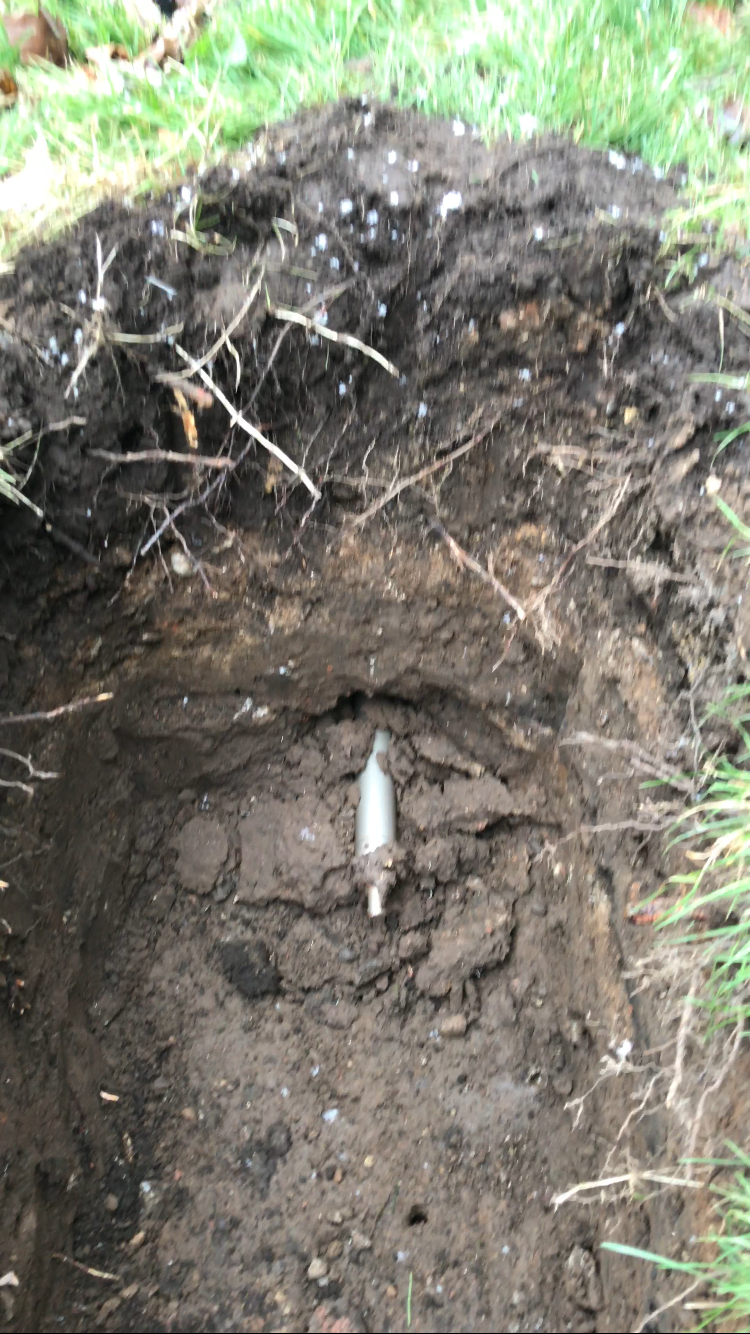

If you miss your target you can reverse the mole, if you hit the target drop the pressure out and take the mole off.

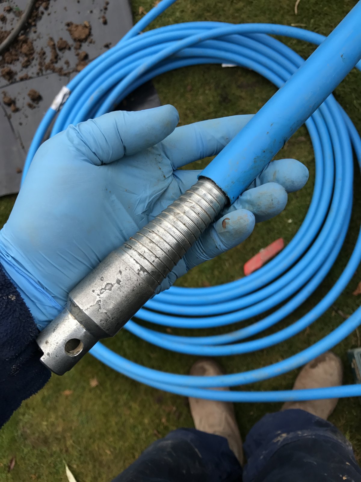

You then use a 'carrot' to screw into your new pipe, this attaches to the hydraulic hose that powered the mole
Then simply pull the hose back, bring your new pipe into the hole and connect to whatever your connecting to or continue moling to more holes
