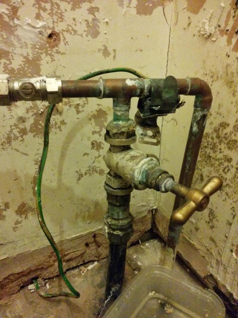

Hi,
My stoptap is leaking and needs to be replaced (I've tried repacking the gland nut, no luck).

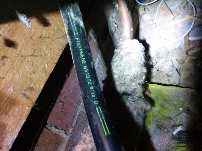

The current setup is show below. The mains pipe is Polyprene BS 1972 Class D with a 21.5mm OD, and according to http://www.stevensonplumbing.co.uk/alkathene-accessories.html, a 14.1mm ID. The copper pipe is regular 15mm stuff.
Can anyone advise how and what parts I need to replace the fittings and stoptap please?

The advice I was given was to use a short piece of 15mm pipe as an insert into the plastic pipe (to stop it crushing as you tighten...) and a 22mm compression fitting with a 3/4" olive over it to allow a new piece of pipe to be put in.
You've got 1/2" class D alkathene there with a connector to 1/2" BSP on the end going into the stopcock .You just need a 15mm copper to Female iron 1/2 compression fitting then a stub of copper and a new 15mm stoptap . Out the top a stub of copper and a 15mm compression coupling onto the stub out of the soldered T ;) .
It looks to me like somebody has attempted to solder the 15mm copper from the tee into the top of the stopcock instead of using the correct male iron fitting!:eek:
If I'm correct, the OP might have a little more 'fun' to contend with!
My understanding is the ID for class D is 14.1mm. Would a 15mm pipe insert fit?
So I am told. I didn't have to do it in the end as I mentioned.
