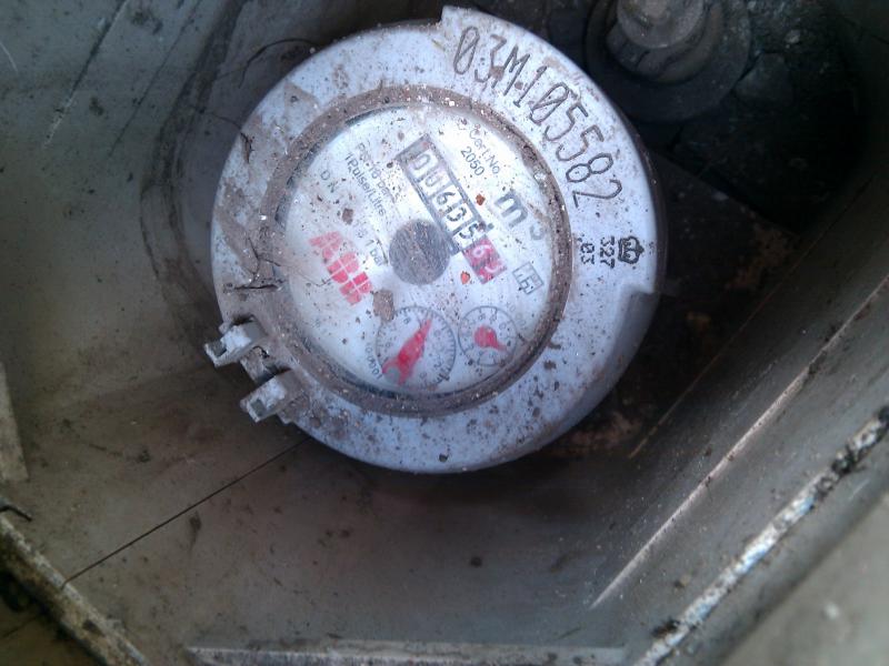

I took a photo of the water meter, does anything on here indicate pressure?
There's no indication of pressure on a water meter. The static pressure could be fine, but the dynamic pressure could drop rapidly as the flow rate increases.
