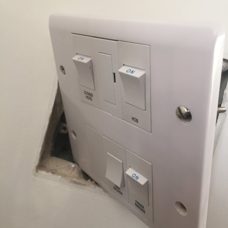

In-identified grid switch plate

I have been asked to change the grid switch to a chrome effect one as you can see iits white. but who makes it a bit first step in finding out how I can replace it otherwise I will have to replace the whole thing this one as my selections on for the cooker hood dishwasher and the fridge freezer in the hob
Do you recognise this make?
Is the name not moulded into either the back of the modules or the front plate?
Surely if you're replacing it for chrome you've gotta replace the whole thing anyway? You can't have chrome bits and white bits mixed in, it'll look awful

Indeed - but maybe it's the back box he is hoping not to have to replace, given the unusual (by today's standards) arrangement of fixing screws?

Looks like it could just be two twins to me, but you're right, the spacing will probably be wrong.
They're odd looking grid switches, they almost like like they're euro mod size.
It has a very Denmans Designa look about it. I fitted some of their grid switches recently, absolutely horrible. There aren't many mains grid ranges where the module fits into a letterbox like yours. The grid box could be a standard 6/8 module box, but without measuring it's just a guess.
I can see why you want to change them, the design doesn't look smart at all! I would replace it with either MK or Crabtree, or perhaps Hamilton. I wouldn't even bother looking to find the matching decorative version from the manufacturer of your current one.
It does indeed look like Denmams Designa Curve range.
Apparently a yoke is not required, so a metal plate should easy to change without too much disconnecting.
As said, it looks crap, but I imagine you just want to change the faceplate and get the hell out of there.
