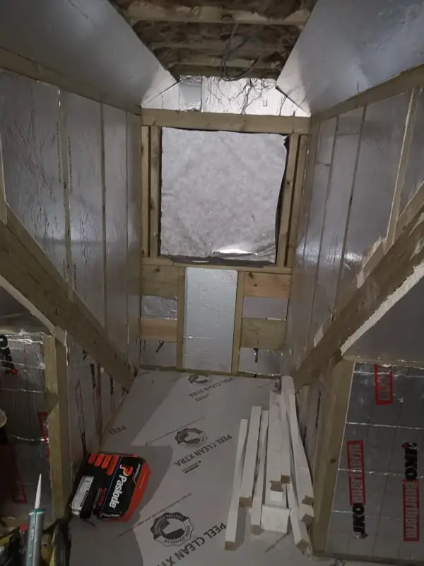

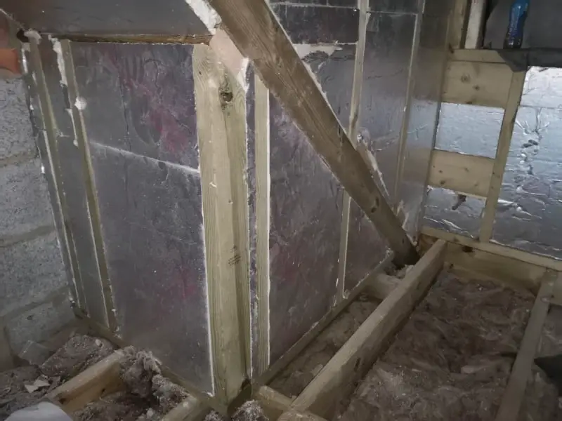

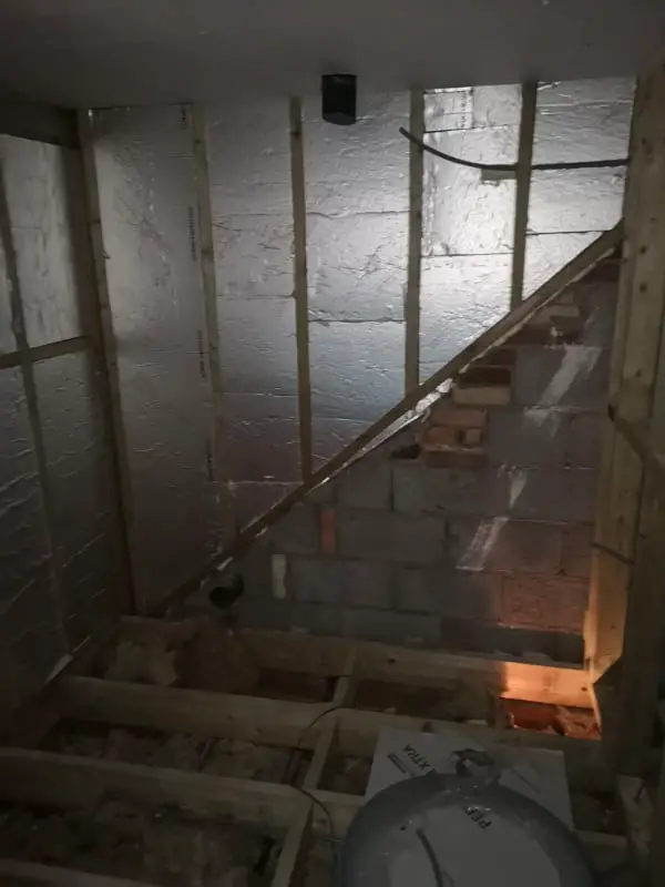

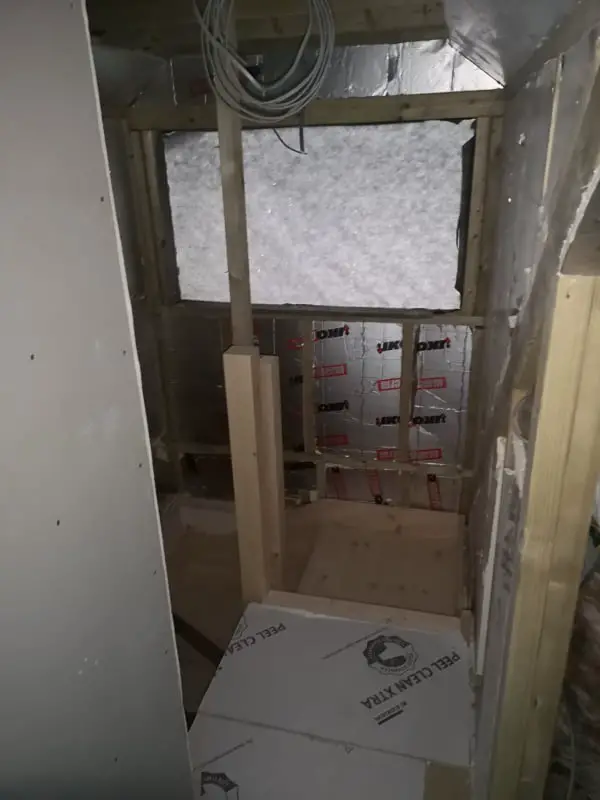

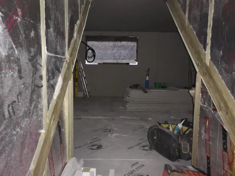

Did you take photos of the work during the build. Maybe there are some that show the insulation?

All those joints (board to timber and board to board) should have been taped if there was no over the timber cover sheet. Not just to prevent draughts but also as a vcl.
If those timbers are 4 x 2 (they look like it) there's max 100mm of insulation in the walls- that's adequate inside a solid brick wall but if the outside of the dormer is only cladding or something like then possibly not.
Looks as if there's 50mm under the rafters but can't see if there's anything between them.
Get that thermal camera going.....
