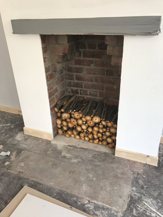

This time I saved a few small logs for inside:

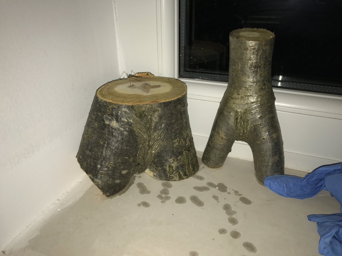

And a couple of bit made into modern art instead of that rusty Chinese rubbish:
