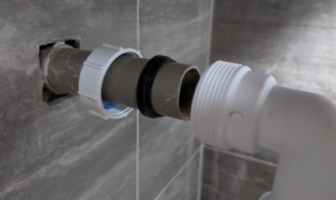

It's a bit more complicated than that.... Waste pipe is available in 2 different types, 'Solvent weld' and 'Push fit'. The pipe and fittings are not compatible with each other, so if you need to join the 2, you will need a Compression waste fitting. (Compression fittings use a plastic nut and washers to make the seal, same as on the outlet from the white trap the Plumber fitted.)
Given you appear to have solvent weld waste going into the wall, I would suggest you try the following. Get one of the fittings picasso has linked to above. Measure carefully how deep the socket is and cut the pipe sticking out your wall back to allow the new fitting to butt tightly up the shoulder of the fitting just visible in the wall. (It is vital you get this measurement right. Cut it too short and you will have no option but to demolish the tiles to get to a decent section of pipe in order to make another connection to sound pipework!)
Once happy apply some solvent weld adhesive and glue fitting onto the stub of pipe, allow a couple of mins for joint to fuse. Fit chrome collar to hide joint. Insert chrome pipe into socket, check length required to meet trap. Cut to size. Fit pipe, using nut and washer to make the seal. Fit Trap.

For what it's worth, I took the trap off the waste pipe and this is what it has. So this is using a solvent weld with a compression fitting on the trap?

I would suggest you try the following. Get one of the fittings picasso has linked to above. Measure carefully how deep the socket is and cut the pipe sticking out your wall back to allow the new fitting to butt tightly up the shoulder of the fitting just visible in the wall. (It is vital you get this measurement right. Cut it too short and you will have no option but to demolish the tiles to get to a decent section of pipe in order to make another connection to sound pipework!) Once happy apply some solvent weld adhesive and glue fitting onto the stub of pipe, allow a couple of mins for joint to fuse. Fit chrome collar to hide joint. Insert chrome pipe into socket, check length required to meet trap. Cut to size. Fit pipe, using nut and washer to make the seal. Fit Trap.
This is a great suggestion. I wouldn't trust the current plumber to do this so I will have to make do with his work and get a more competent plumber in to do the job properly.
