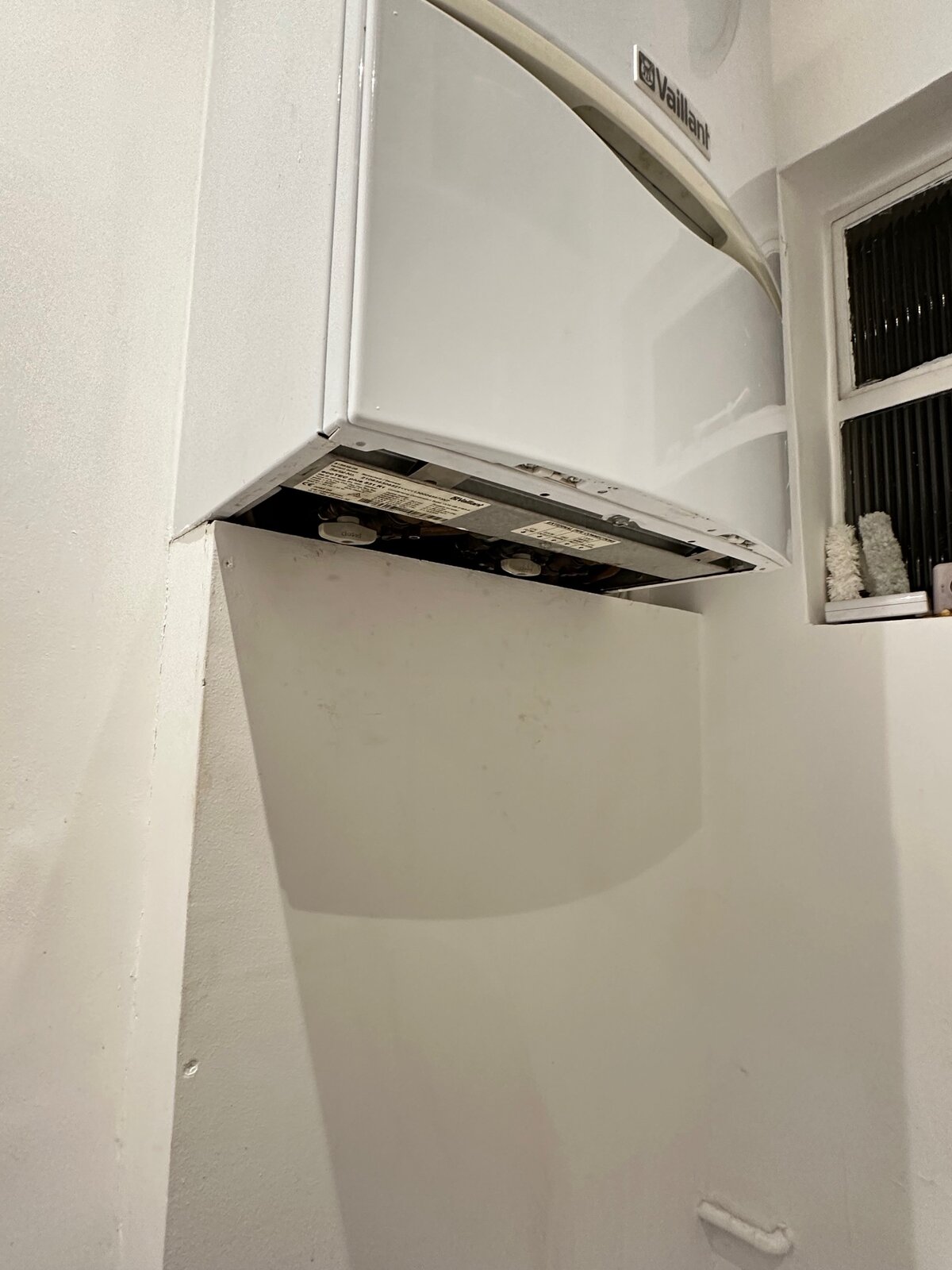

Will do this evening. My filling loop is a flexi. Unfortunately the pipework has been boarded-up right to the bottom of the boiler making access to the flexi itself difficult, as its kinda pushed back to the wall. Maybe that's why nobody checked it properly in the past. The engineer did mention at some point he might need to cut into the boarding, which I said is fine as it is in a utility room. But then he never did.

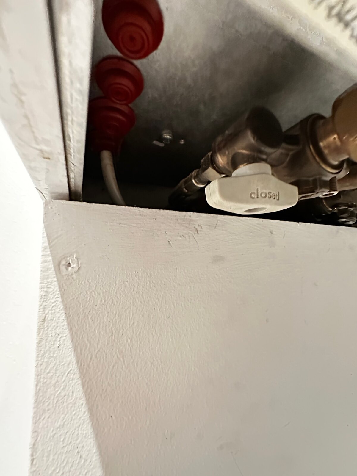

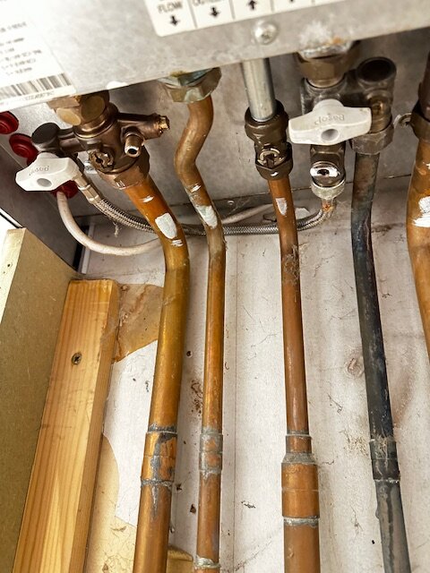

Attached some pictures, but you can't really see much as it's boxed in.
The is a flex going through the back from one side to the other, not sure you can see it on the pictures

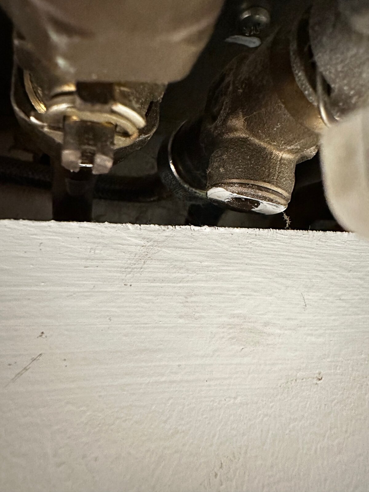

board removed. It was dripping indeed, from both sides!
More so from the left side than from the right. I've recorded a one minute video to illustrate the amount to drip, you need to have audio enable to listen for the drip.
I suspect this should not be the case? the flexi also looks quite old and I did not see any rubber gasket inside, but will check again. It was not leaking while mounted.
Fit a couple of blanking cap nuts and seals,one to each valve. And see if the pressure remains stable.
Long term the valves would need to be replaced.
