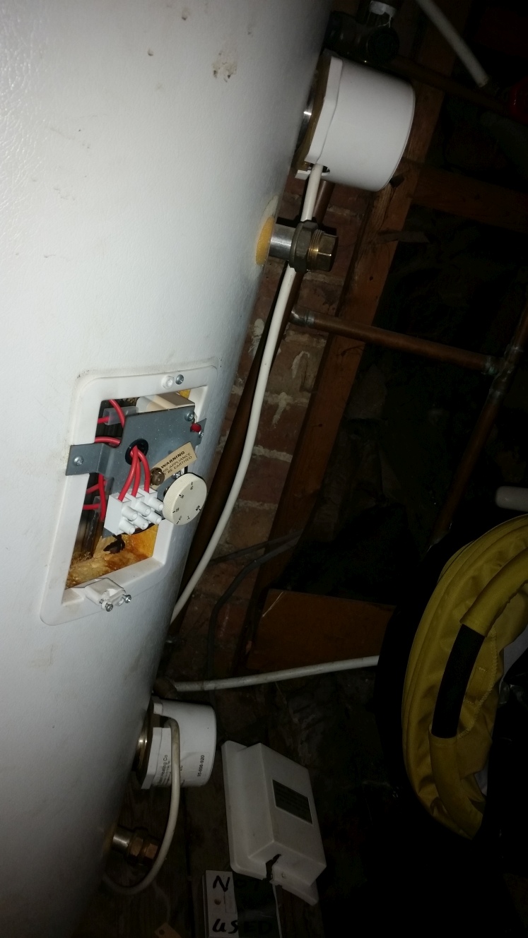

We have an old megaflo - moved into the property summer last year.
Have had the airbubble recharged (once after moving in & just recently - however it is something I will attempt myself next time pressure drops / tundish drips as seems straightforward).

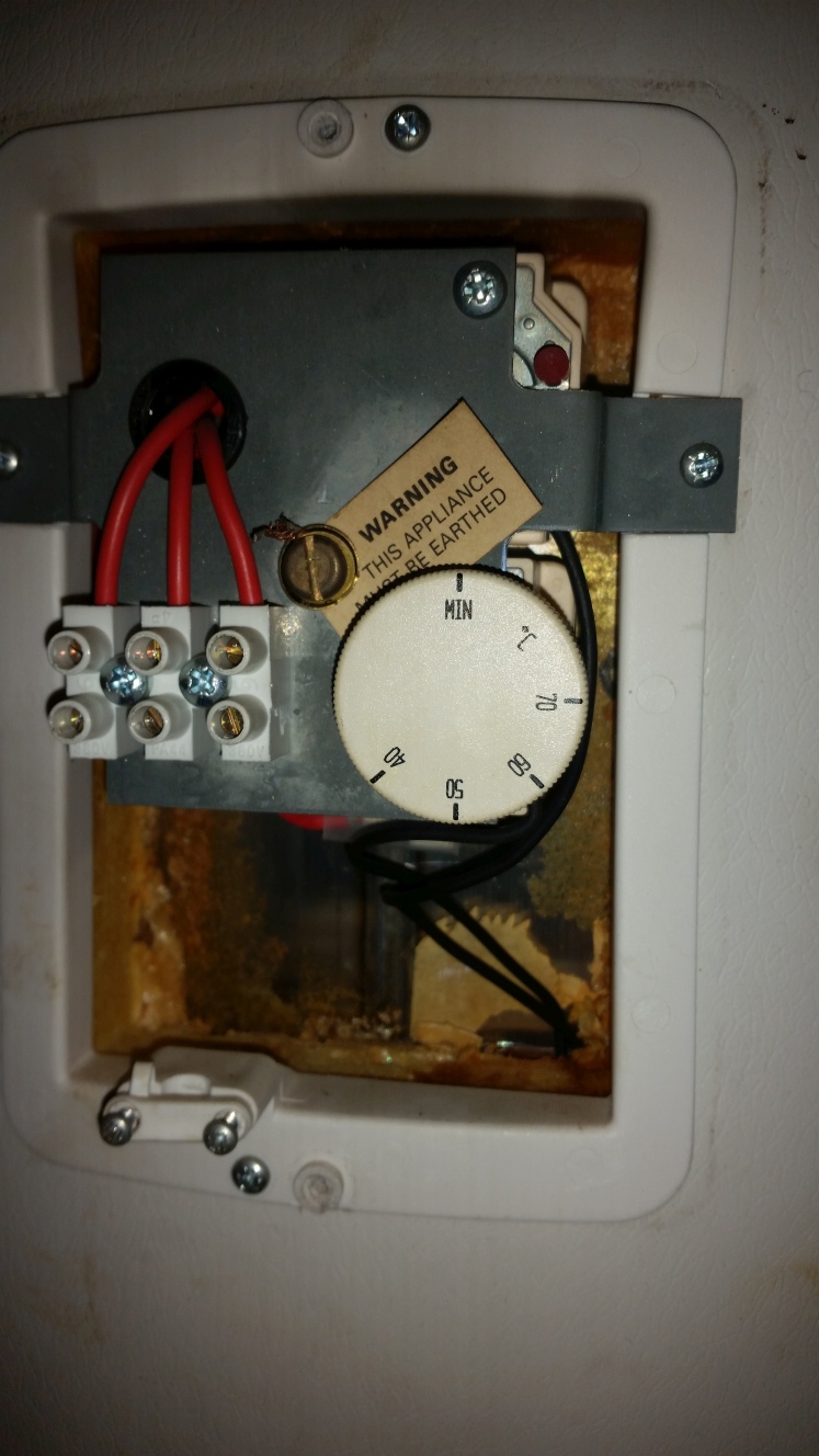

However the water temp is not terribly hot (I prefer hotter water) - seems to be set at around 50 degrees C on the indirect controller accessible from outside of tank.
I have now set to 55ish (as far as I can tell as not clear from knob where setting mark is !). I think I have turned the correct way as I turned one way until "click" heard, which I assume is the off position, then rotated other way until approx. 55 positioned at 9 o'clock (50 was there before).
Am I doing the right thing ? Will I cause any significant problems turning this up (apart from scolding !) ?

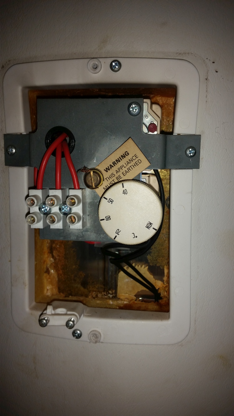

Any idea which way to turn indirect controller to increase temp ?

Turn off electrical supplies to immersion heaters. Remove cap from lower immersion. Look for temperature control in here and turn up by 5 degrees. Replace cap. Re-instate electrics.

Am I looking at the wrong controller then ?
It looks like the controller that you've uncovered is the temperature sender for a boiler. Nothing's wired to it.
The immersion element will have its own thermostat built into it so you'd adjust the water temperature as per Daveydub's post above.

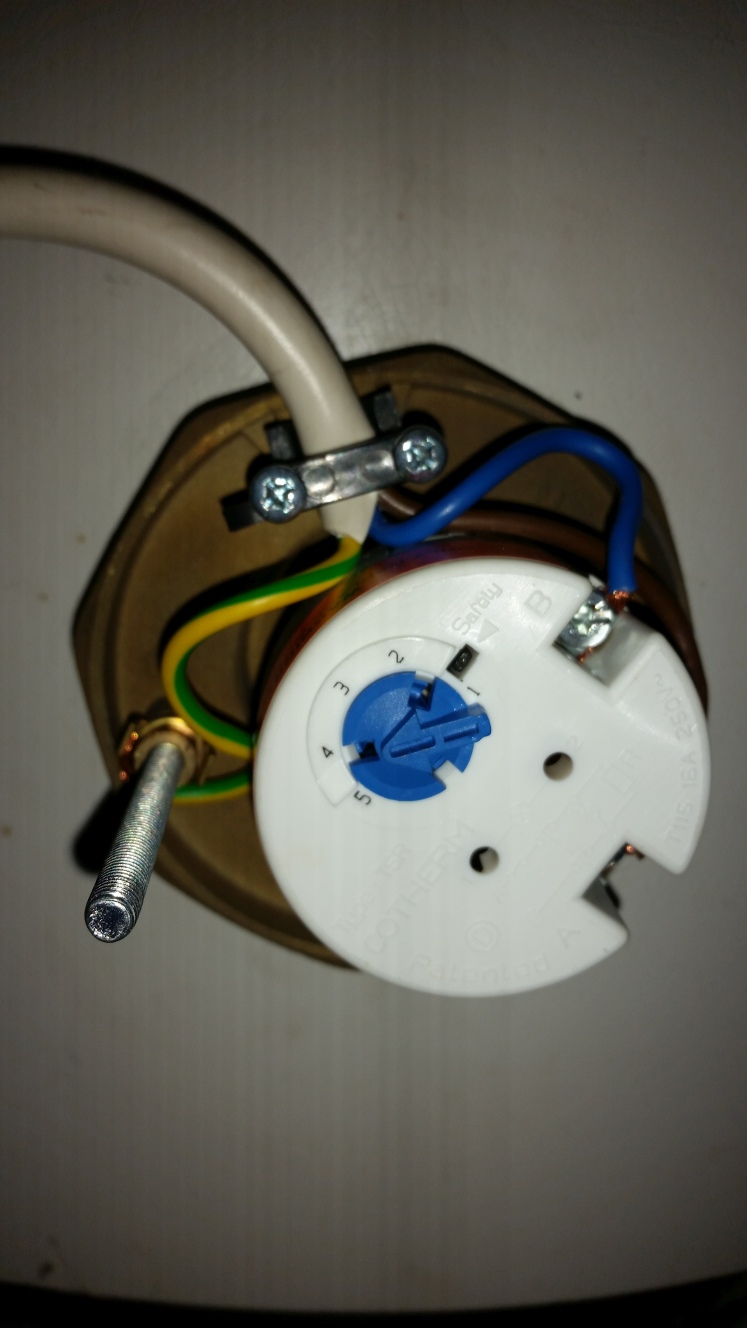

PS Here is the lower immersion controller - it was set at 4 but I'm not sure what temp these values equate to. So I have increased to 4 1/2 & will check water temp tomorrow morning - is that sensible ?

If the lower device is immersion temp controller, what is the higher one ?
You have two immersion heaters elements. You need to turn the temp up on the higher one too, assuming it is wired.
as you're on ECO7, it's normal to have the upper element set to a temperature that will not come on unless the overnight cheap hot water has all been used up. The upper element is for daytime topups and costs about twice as much as the overnight rate.
Because hot water rises to the top of the cylinder, you might find you can achieve that even if top and bottom stats are about the same. But setting the top one hotter than the bottom one would be uneconomical.

It's strange that your water is not hot enough with the stat turned up to 4. So verify the lower element is actually switched on, and draws 3kW at night. It could have failed or been turned off.
The manual says:
It is recommended that the immersion heater thermostats are set to between position 4
and 5 (60C - 65C), however they can be set between 1 and 5 (10C and 70C).
So you should be OK with is where it is in the pic.
