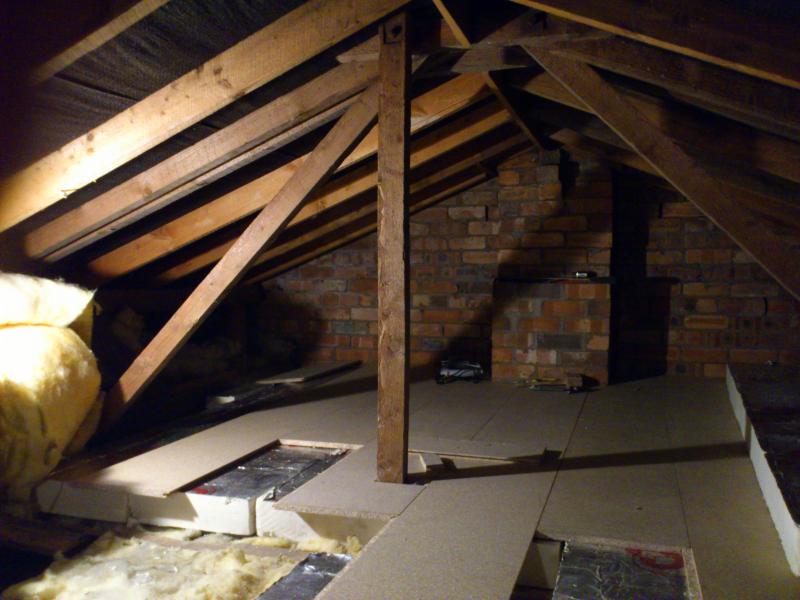

I have boarded three lofts in my time. My sisters flat and my house using extra timber to jack the floor level up. My sister then moved to a house and asked if I would board out her new house and fix the loft insulation, as it was only as deep as the joists and missing in places. I decided to go for the Celotex/Kingspan method as something of a punt for speed and minimizing the loss of height.
You need to be careful when installing it, always make sure you use a board to kneel on it, but I did not find it has dented significantly, and it still seems to be doing fine a year later.
3) Have you used 'standard' t&g loft boards on top of the insulation board? If so how have you fixed them down to prevent them coming apart when walking on them?
Yes I used standard T&G loft boards on top of the insulation board. They are fitted tight between the gable ends of the house and two thicker joists that ran the length of the house, so it cannot in effect "move" I is however screwed to the 100mm timber I used to jack up around the loft hatch. You could if you want get 150mm screws and screw the loft boards to the joists through the insulation board around the edge if it is not butting up against something solid.
This is a picture of the job in progress.
I have just had a report from my brother who reckons that the plastic loft legs are good, so if you have the insulation already and have plenty of headroom, then that is reasonable solution. If you look at the picture of my sister's loft she does not have much headroom, and did not have any insulation to begin with so the celotex route turned out to be a no brainer.
