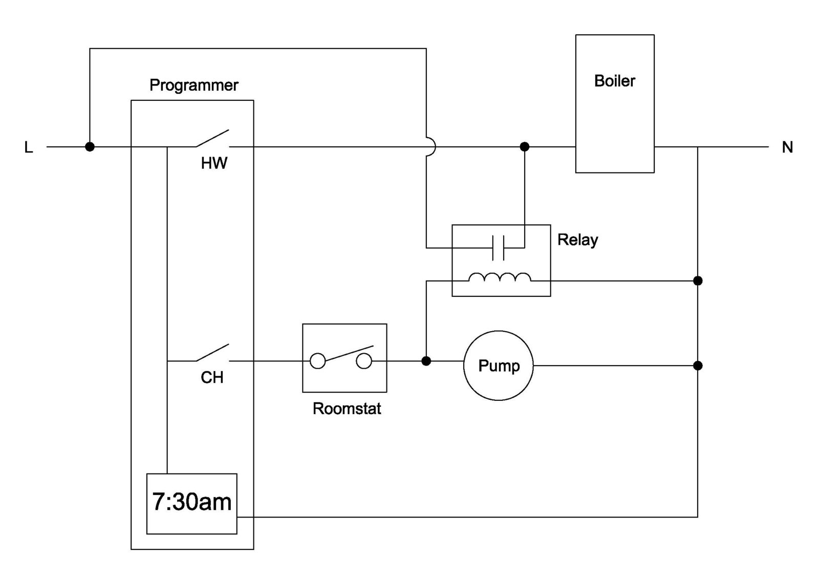

In our rented home, we have an old Potterton MF RS 70 that has gravity hot water, and pumped central heating. It does not have any zone valves, but has a programmer that allows the CH to operate from a room stat when the HW is on. The trouble with this, is that to have the CH running from the thermostat at a steady temperature, we'd have to have the HW on all day, with it heating up to maximum boiler temperature and then cutting out, constantly.
We recently had a new programmer fitted to the front of the Potterton, a BP2000, but I believe that beforehand we had the option to have the CH on without the HW needing to be running constantly (no idea how, but I'm not happy with the way it is now)
I don't want to have to change the system to a C or Y plan. I'd rather not have to fit a cylinder stat.
Here's the question:
Is it possible to wire the BP2000 so that when the CH room stat calls, it then switches on both the HW and the CH?
And if the BP2000 isn't up to the job, would it be possible to fit a programmer that can turn on the CH and the HW simultaneously when the room stat calls for it?

The thermostat currently just turns on the CH pump. What I'm picturing is a relay from this circuit that also switches on the HW. (I don't mind that the HW will come on with the heating, that's not such an issue) Is there a way to wire this, or a programmer that has this functionality?

If you can change the configuration of the programmer to allow separate time control of the HW and CH, and then add a relay as below, it will do what you want.
1) During the winter when the heating is on, the hot water will be also be switched 'on' and 'off' by the room thermostat along with the central heating under time control from the CH channel at the programmer. (HW is set to off)
2) During the summer when the heating is not on, the hot water can be controlled by times set by HW channel at the programmer. (CH is set to off)

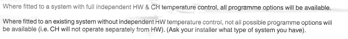

That's not how it works presently. The BP2000 will allow for separate timings for CH and HW, but the CH will not come on unless the HW is actively on. So no, the CH will not also turn on the HW, that's the issue. (Unless there's a way to set this programmer differently??) FWIW I've attached the paperwork that came with the BP2000.

OK then, it's not been set up correctly for the system you have now. From what you describe, yours is set for the top option from the manual you posted and copied below, which is actually for systems with motorised valves (C,Y, S plan). As it stands now, if you were to turn CH on, only the pump will come on and circulate cold water through the radiators. The boiler won't come on until the HW is set to be on also.
This is wrong. It should have been set for the bottom option, which reduces the programmers functions to suit your basic system and would have turned on the HW automatically when CH was selected. I said before the programmer can cover all possibilities, it is your plumbing that is the restriction, and the programmer when installed should have been set to 'dumbed down' mode to suit it, but it hasn't been.
The good news though, is because yours is presently set for the top option, then it is actually where you want it to be after the relay is added, so you won't have to change it.
Any 230VAC relay / contactor with a volt free normally open contact will do there's an example here. you would need an enclosure to put it in.

1) The modern setup with motorised valves allows completely separate control for the heating and hot water, so they work independently. The programmer allows either to be 'on' with, or without the other. Provided the plumbing has the facility for this.
2) The restricted version is for gravity hot water / pumped central heating as you have now. The HW can work on its own [Boiler comes on, water circulates through the hot water cylinder by gravity] but the CH can't work alone because the HW also has to be on for the boiler to work. When set to the 'restricted mode' whenever the programmer switches the CH on, it automatically switches the HW on too. The thermostat is a separate item wired from the programmer CH and only connected to the pump. It has no control of the boiler. The HW only has boiler control.
