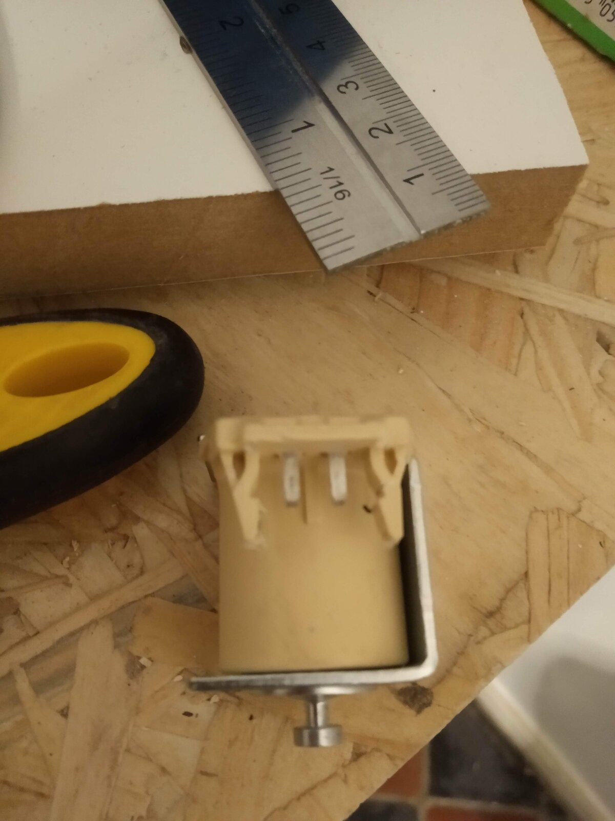

Hello,
The detergent drawer has stopped opening on the dishwasher and rinse aid isn't going in. After some googling I found it might be something called a solenoid that controls the drawer opening.
I've taken it out and the circuit tester says it's broken.

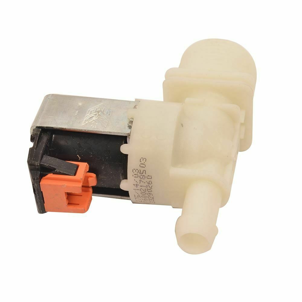

I wanted to ask about the correct replacement part. Are the two parts in the photo the same thing? One with an extra bit one, presumably the dishwasher has another solenoid somewhere. I just searched for Indesit DIS 04 solenoid.
It's the first one , but doesn't come seperately, you will need the dispenser complete.
Thanks. That's a shame you can't buy it separately. The first picture is the one I took out. I was hoping the second one had the same part in it. The whole dispenser is about £60 so might not be worth it.
