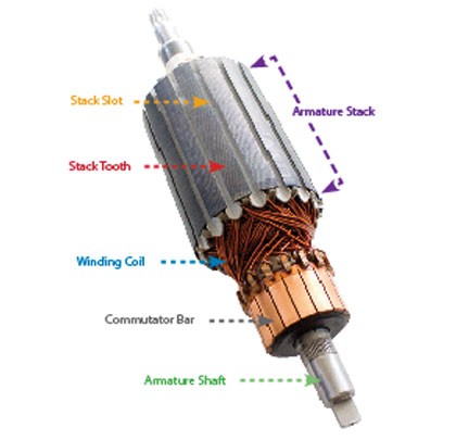

Could it have overheated the motor and damaged the windings when it got jammed?.
Definitely a possibility. It was also leaning back (levelling legs at the back have broken) which stopped the drum turning. Placing a piece underneath at the back to level it out is helping but it struggles with heavy loads now. Not sure the drum is sitting properly now (the felt band seems a little out of place).
Are those windings hard to replace?
You need to take the belt off & see if the motor bearings are free to turn
It'll be a new motor if they are damaged.
I've had results before cleaning the commutator pads (and between them) before on motorcycle started motors, depends if you can take the motor to bits (or justify the work).
