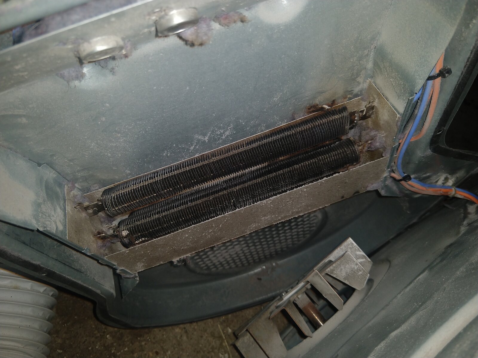

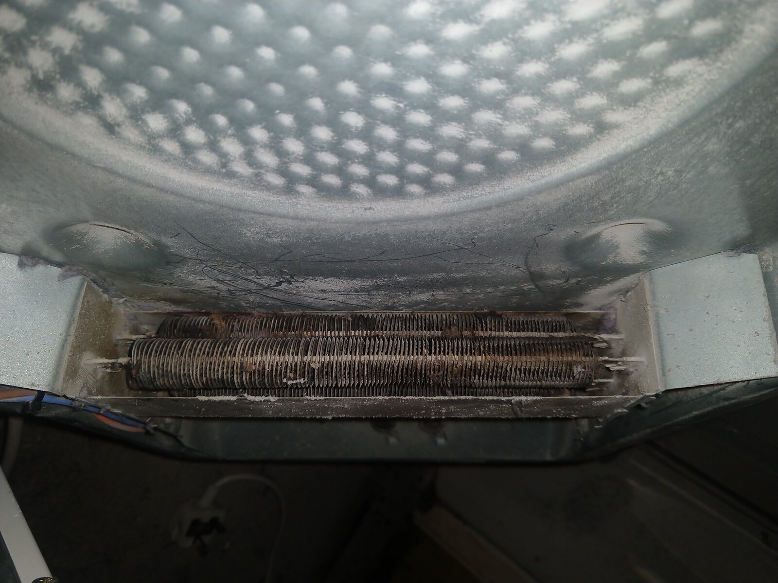

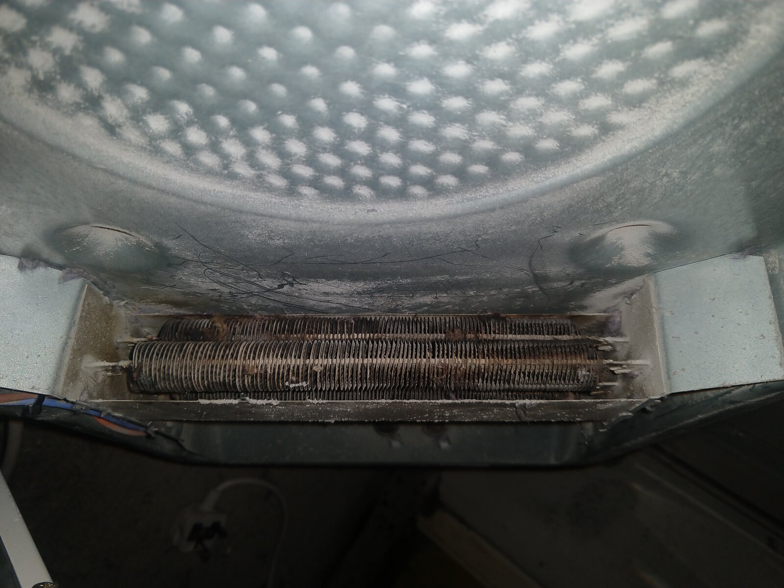

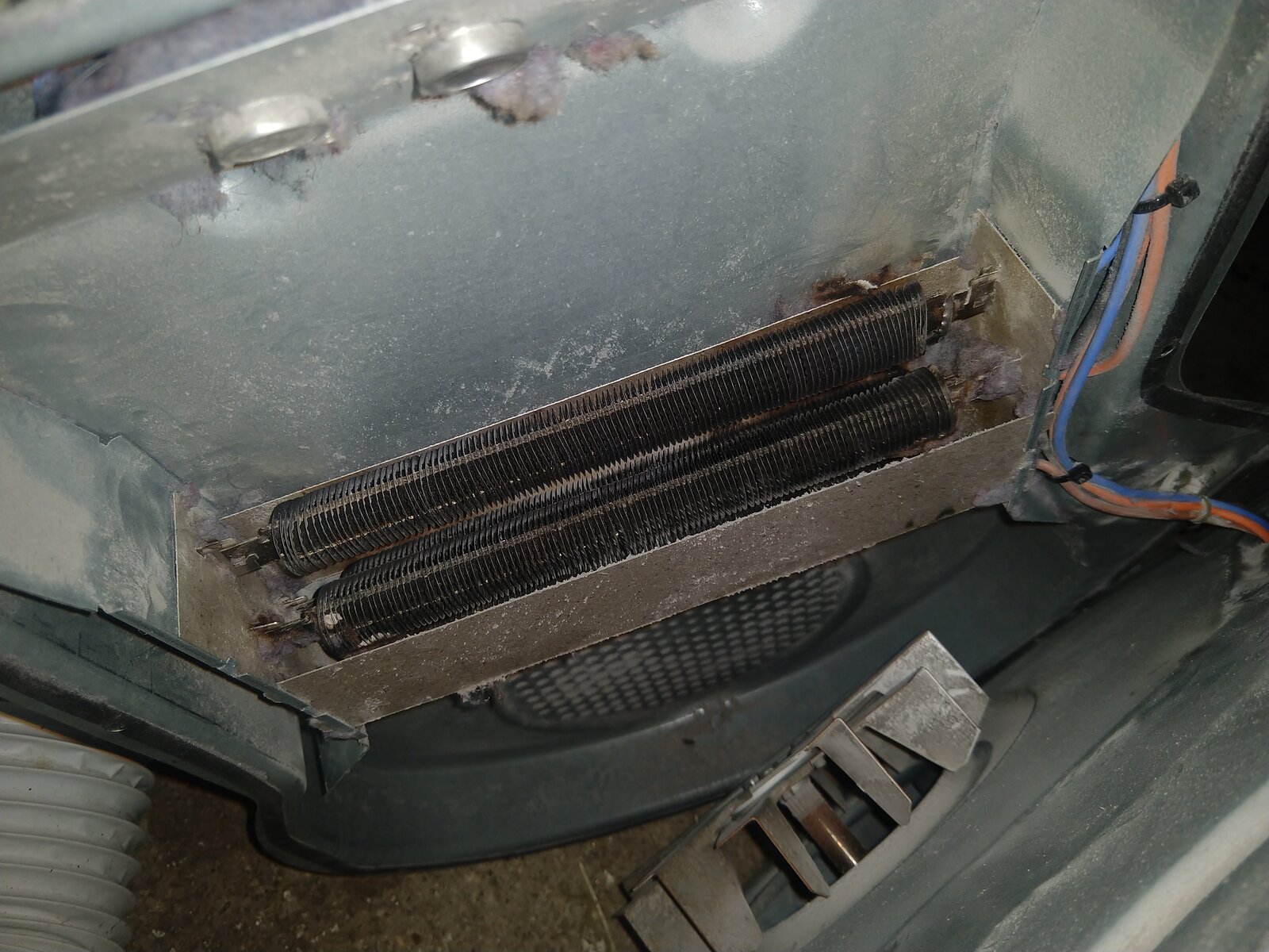

Took the heater enclosure off to investigate - quite a bit of fluff in there, some evidence of burning :cautious:
Have given it a thorough clean out, wooden skewer was helpful.
Giving it another test to see if it still trips - think I will replace the heater anyway as it's 5 years old now so done decent service.

Yikes! Naked heating wires? Not the sort of element I was expecting in a machine where accumulations of fluff are possible.
