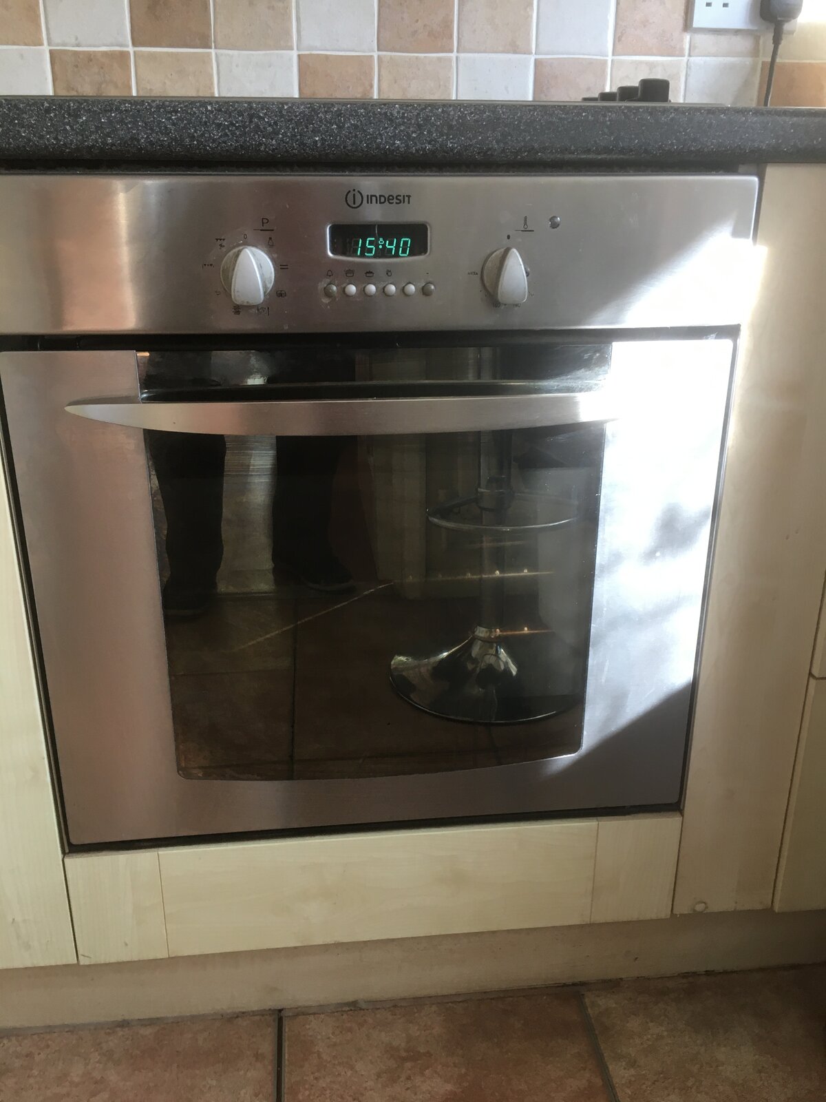

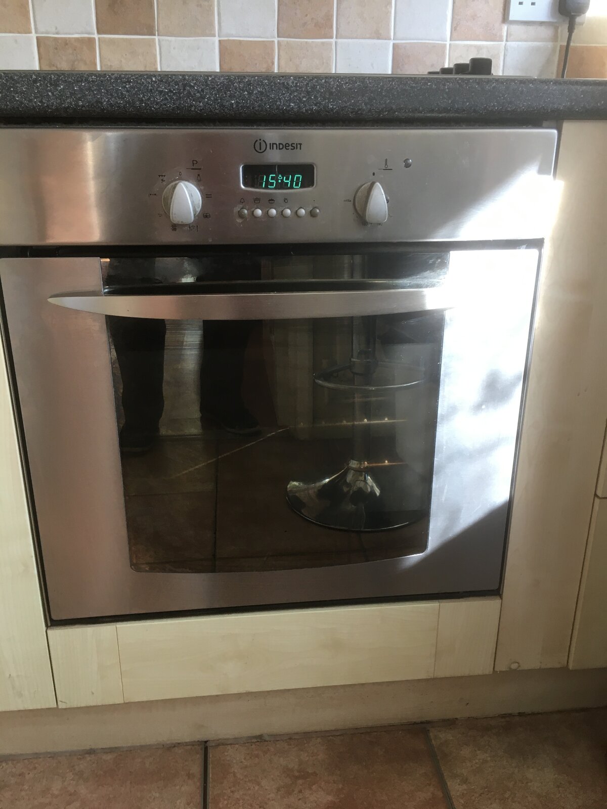

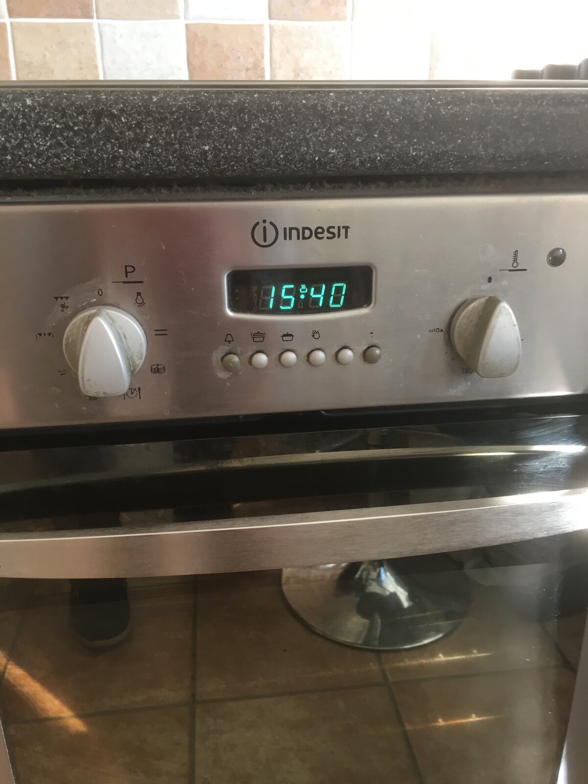

I need a grill element for an Indesit single oven but can't find the model no. Any stickers on the front have long gone - hoping someone can advise by the photos attached. Otherwise have to take it out and look at the back.

Many brands put the model number on the inner edge of the door. I don't know about Indesit though.
A reverse image search comes up with the FIE56 K.B IX GB
Which is also similar to the FI 51 and the FIE 36.
If you are using Chrome on a pc, right click on the image that you posted and select "search image with Google"
Edit and if it that model
Someone like Capital Repairs in Raynes Lane (west london) may be cheaper.
Yeah ! That's it. Thanks. Had a look at the element in the oven and it matches the picture in one of the spares listings. I'll do some measuring then order. Looks like the screws are accessed from the back on this model. Around £20-30.
