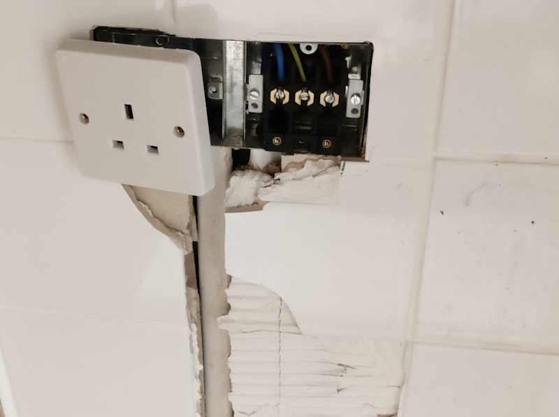

I just feel the need to check a couple of things and hope somebody can repsond.
My kitchen has a Bosch plug in oven (2.4kw) plugged in to a socket near the oven. This then goes to a fused switch above the worktop with 13amp fuse (switch says Ignition but oven is plugged in).
This is the socket before it was finished. The cooker connection is on its own circuit and the socket is on the same circuit as other sockets in the kitchen (this one is has the wording "Ignition" and is 13amp). Hope I am giving enough info here. This all does look MUCH better than is this picture but is behind oven so I can't take a new photo.
Is it OK that the oven is plugged into this socket with the 13amp fused switch up on the wall?

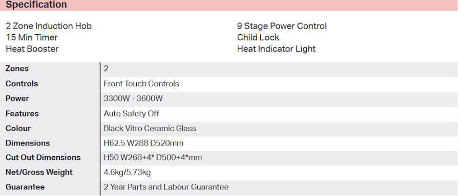

The kitchen also has a 2 zone Montpellier induction hob 20amp which is hardwired into the cooker connection behind the oven.
Is it fine for hob to be wired into the cooker connection?
Something that could run at 2.4KW should not really be plugged in (as a generalisation) was it manufactured with the plug on it? or has someone added it.
Loads 2KW and above should be avoided on a gen socket circuit and be on their own supply.
When you say the hob is 20A how did you get this info? Manufacturers usually state the KW and voltage.

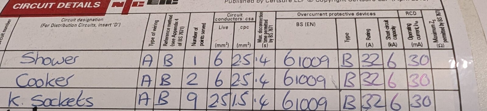

If you know the KW rating of the hob and add it to the oven KW (2.4) you could treat it as a bog standard cooker circuit and make the calculations for a cooker circuit which is less limited because diversity is applied in the calculation.
Although, in practice, a 2,4KW oven is unlikely to run at full whack for excessively long periods it could still run at that for a while at sometimes on a socket circuit that is only rated for 32A sockets total, not a good idea really.

If the oven plug is a moulded one then that is presumably how it came and is able to be plugged in to a socket circuit.
You could, of course, connect the socket to the cooker circuit.
Exactly correct EFLI , I was waiting for you to make that comment, if the manufacturer allows it then it should be OK but I was, initially, trying to explore the possibility that someone has changed it either by putting a plug on it or ,unlikely, putting a moulded plug and lead on it. And yes I was primarily thinking why not put it on the cooker circuit.
If the OP has the manufacturers instructions that should tell us if it is actually OK in itself plugged in.

I misread the hob ampage I believe. This is what I have now found. Is this OK to be hardwired into the cooker connection?

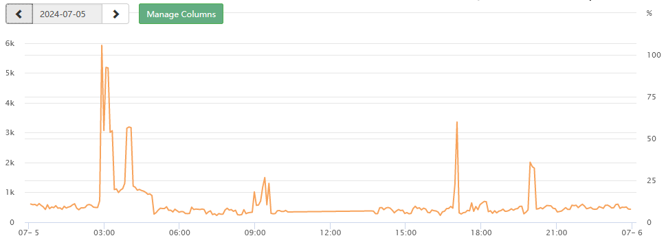

If the OP has a smart meter they can watch the In Home Display while using the oven etc.,. and see what the appliance consumes.
"Ignition" for the switch/socket implies use for a gas oven or (more likely) hob when the place was built.
To answer the question asked but not answered so far as I can see: The 20A hob connecting direct to the 32A MCB protected cooker supply is usually acceptable as the cable will be protected in the (unlikely) event of a short circuit within it.
If the OP has a smart meter and In Home Display they can see how many extra Watts the home is consuming and for how long when using the oven...

The appendix 15 does say 2 kW, but the examples are non-portable. The socket seems to be from a dedicated cooker supply, so not really anything to do with ring final rules.
So in theory, if one overloads a correctly designed circuit, some overload device will open, so should be no problem trying it, and seeing how it works, only with the ring final is there a problem.
The ring final has 20 amp cable on a 32 amp supply, so an overload can occur near the origin of the ring, the centre of the ring should be reasonably even load on both legs.
So to stop the problem of potential overload, items using a high load, for a long time, like an immersion heater, should be on a dedicated circuit. The highest and longest load, likely to be plugged into a ring final, is the washer drier or tumble drier, when they use resistive heating. In compassion, an oven of less than 3 kW is a much smaller problem, as although over 2 kW the time the element is powered for is much shorter than the time the element is powered for with a tumble drier.

I look at power used. 1720260891758.png yesterday, the highest was when washing machine, tumble drier, dishwasher, set off before going to bed, and the battery also charging from the off-peak supply. Total 6 kW and in real terms rare we exceed 6 kW, except when having a shower.
