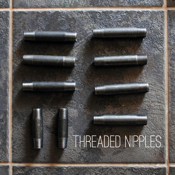

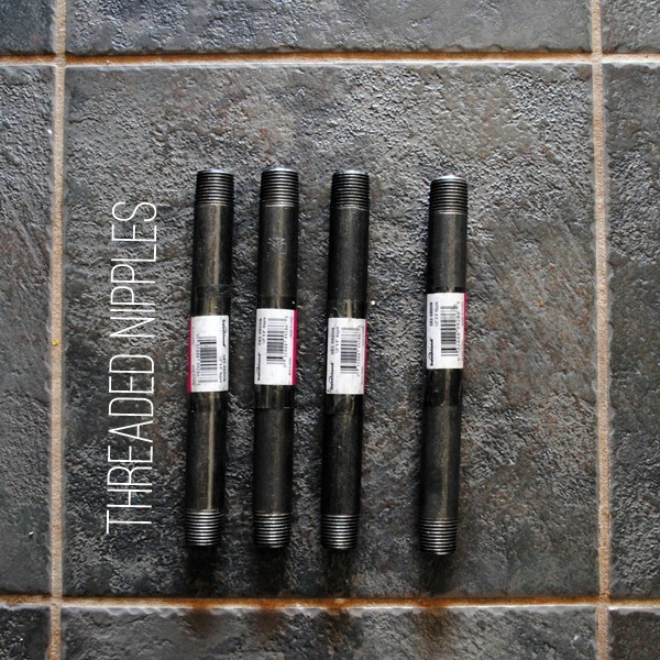

I am constructing an industrial water pipe ceiling light. Two queries:
1. What type of wire should I use from the light bulb socket to the main electrics?
2. What is the best way to earth the light fixture?
Thanks for all responses

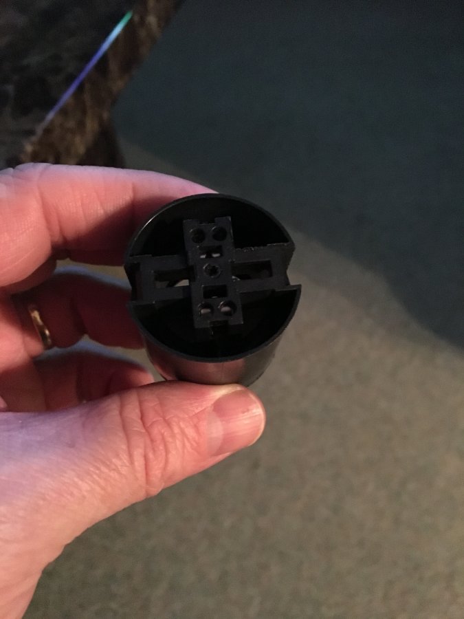

Using 3/4 inch pipe. This was the lampholders I was planning on using as I can not find any other black lamp holders.
There more suited for "Machine prepared " cable ends, untreated flex may go in but not ideal, you could use heat resistant single core "appliance " wire, but thats not ideal either really due to its rigidity.
Also as they have no earth connection, the fitting will need earthing elsewhere possibly within the ceiling cup .
Possibly the only suitable black holders you will find in the uk are "continental holders" though as said they are designed for 1 cable in only, you will end up with over at least 13 cores at the inlet

Surely in the one which strautman is holding we are looking at two terminals for L and two for N, allowing them to be daisy chained?
Bootlace or pin crimps?
Yes, im sure they can be daisy chained, the reason i mentioned continental holders is there also black, have standard screw terminals, which although not desighned too, will accept two flexible cores, plus has a metal base to accept a 10mm metal thread, soldered to his piping, and internally has a screw type earth terminal which will transfer the earth connection to the pipe body.
This is a pretty standard set up on them 3 shade pool table lights you see in pubs.
I assumed hes unlikely to have access to any suitable solid lighting cable, then without as you say, ferrules or a tool its unlikely he can get his flex securely in to the holders shown, i may be wrong, some you can pre open the hole by inserting a flat screwdriver in the slot.

These are my basic parts. Have two ubolts that goes around the rafters to the flange and bolted on.
