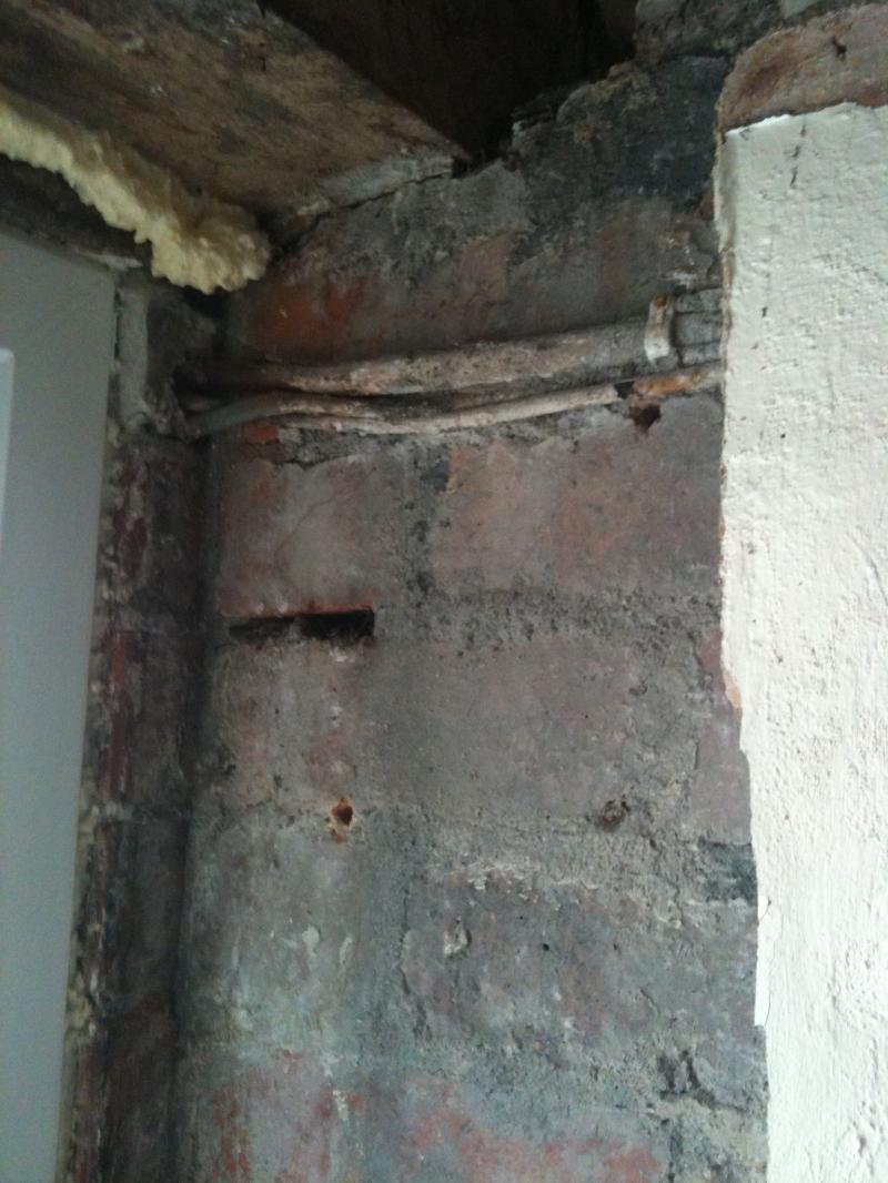

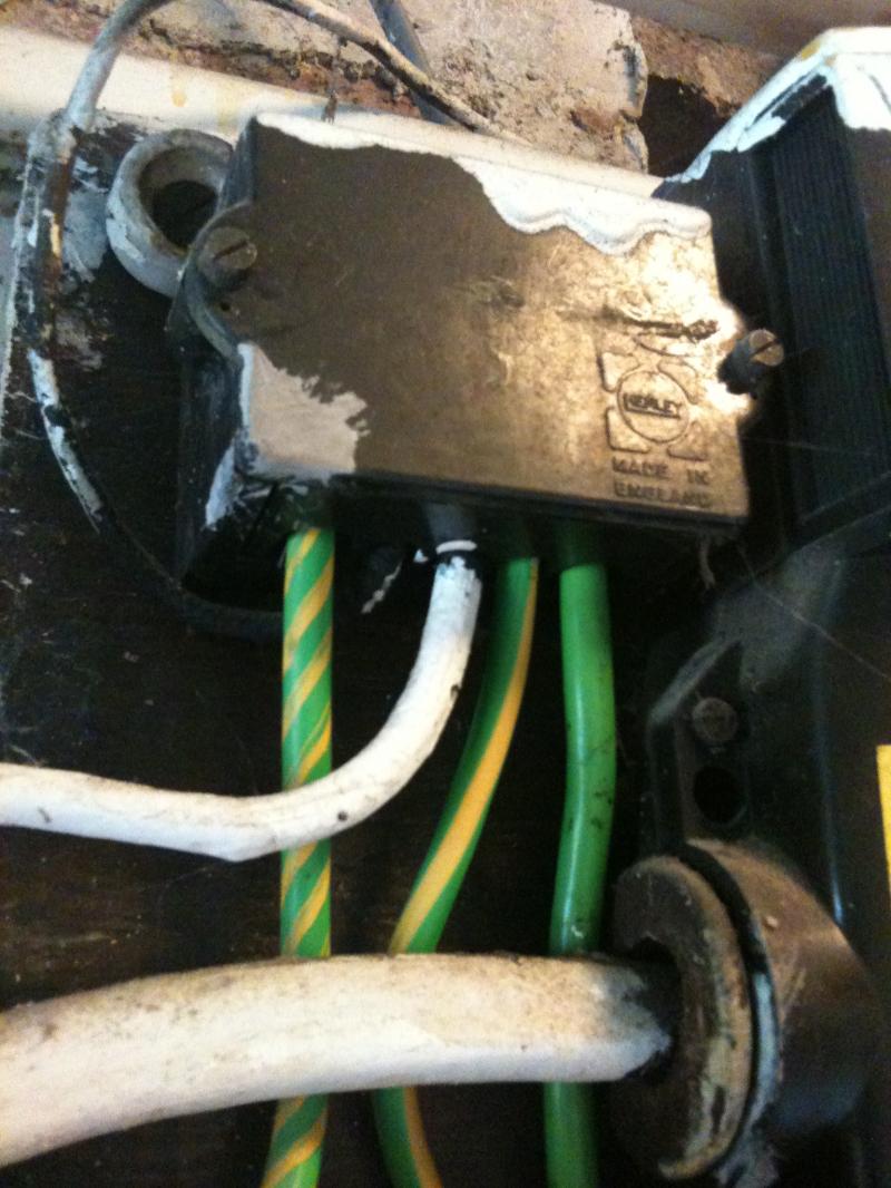

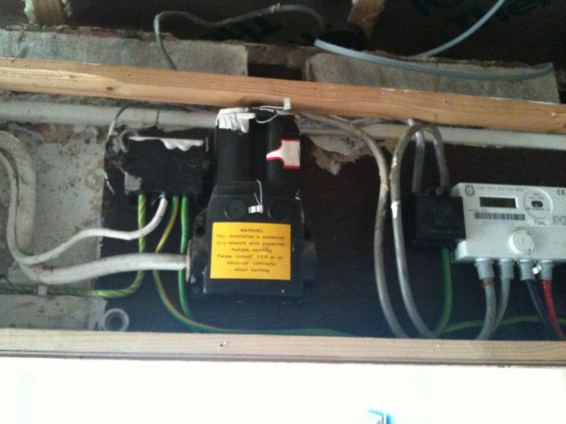

I've not seen as many of these as you lot will have, but just looking at mine makes me nervous.... I've uploaded some pics....
It is this last one that makes me most nervous, that's the mains supply cable running just under the plaster about 5' to the main fuse.

I've had the tape out, and the cable length of the tails would be about 8m when vertical distance is added.
Yeah, that looks......nice!
It's overhead, I take it?
The thing is their rules & regs are very different to ours.
It seems to have an earth...is it provided by them or is it from a rod in the ground?
Overhead, yes - but only about 6'6" from the floor.
Earth-wise, I'm not aware of any rod in the ground, so I presume it comes from them. The big yellow sticker on the main fuse referrs to 'protective multiple earthing'.
just looked again at the pics - is the supply cable into the bottom on the company head twin and earth????
(Or do I need new glasses??) :eek:
It could still be an overhead supply - many which were originally TT have been converted to PME.
It looks like twin & earth to me. 6mm at a guess, though it could be 10mm. Do I take it that isn't normal?
And the old tails are pathetic little things too.

I've worked on supplies like that in the past. The feeder cable is a bit like twin and earth, only it's twin without an earth, and the external sheath is much tougher than normal PVC, more like hi-tuff It looks like a 16.0mm² supply to me. The last one I saw was just outside Halifax.
The supply type is PME. Note the big yellow sticker on the bottom of the cutout ;) Most likely a TT conversion I'd imagine.
