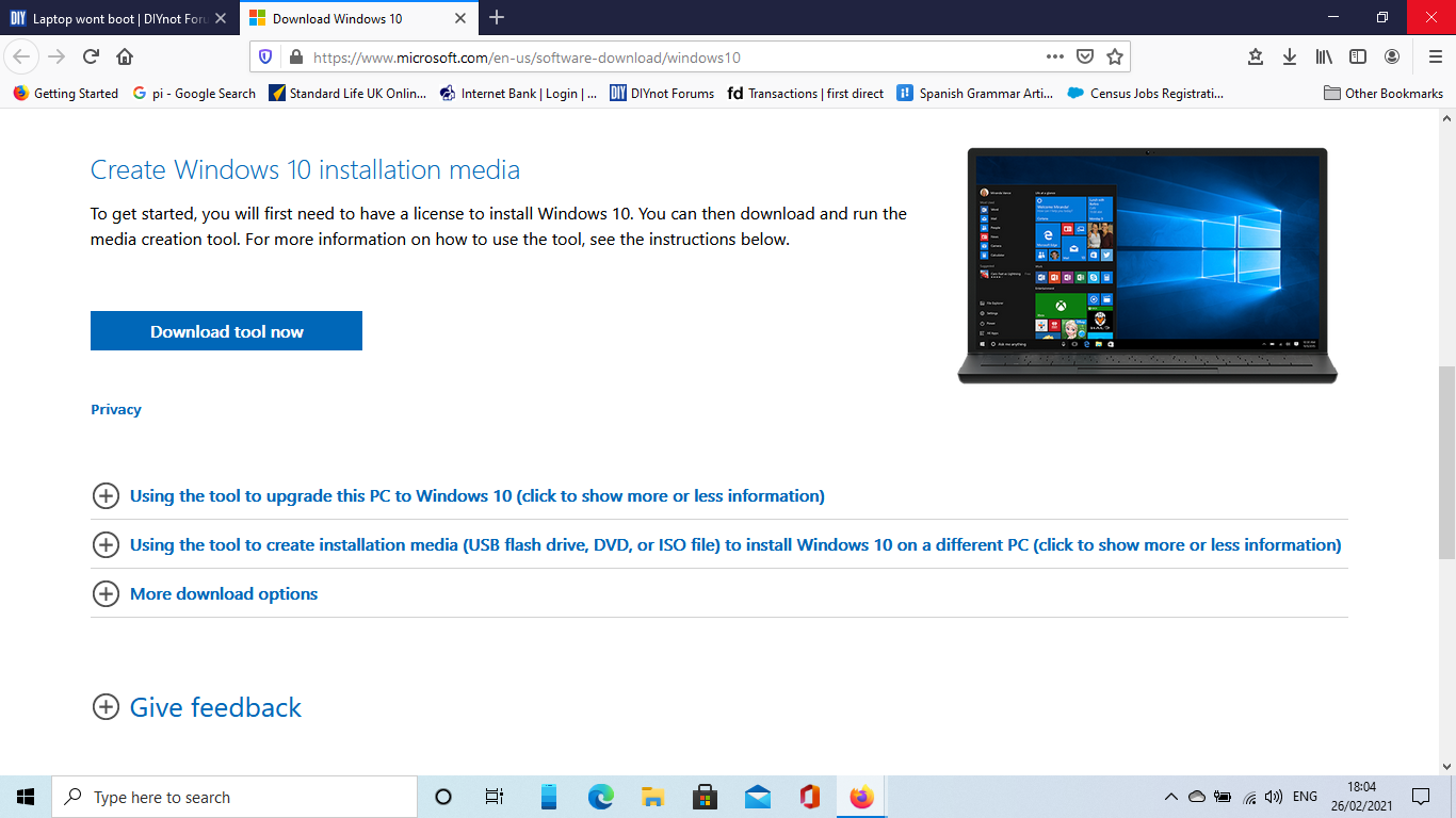

Hi Chalky, Thanks for your interest. I'm no computer wizz and have no experience of LINUX. A few months ago I loaded a fresh version of Windows 10 on my laptop from installation files I had loaded on a memory stick. I got the files from this website:
https://www.microsoft.com/en-us/software-download/windows10
Here's a link to the thread I started on here to do this:
https://www.diynot.com/diy/threads/laptop-wont-boot.557172/page-2
I still have the data loaded onto a stick. Will it be possible for me to use this to create a new installation of Windows 10 on this inherited laptop?
Will it simply delete and/or overwrite everything that is currently on the device?
Seems too simple to me.
Cheers, Chris.

Yeah, that works if you have a Win10 code.
The media creation tool creates the bootable USB, then hit F2 or F8 as laptop boots and in the BIOS make sure boot order has USB first. If no USB option, create the media on a CD

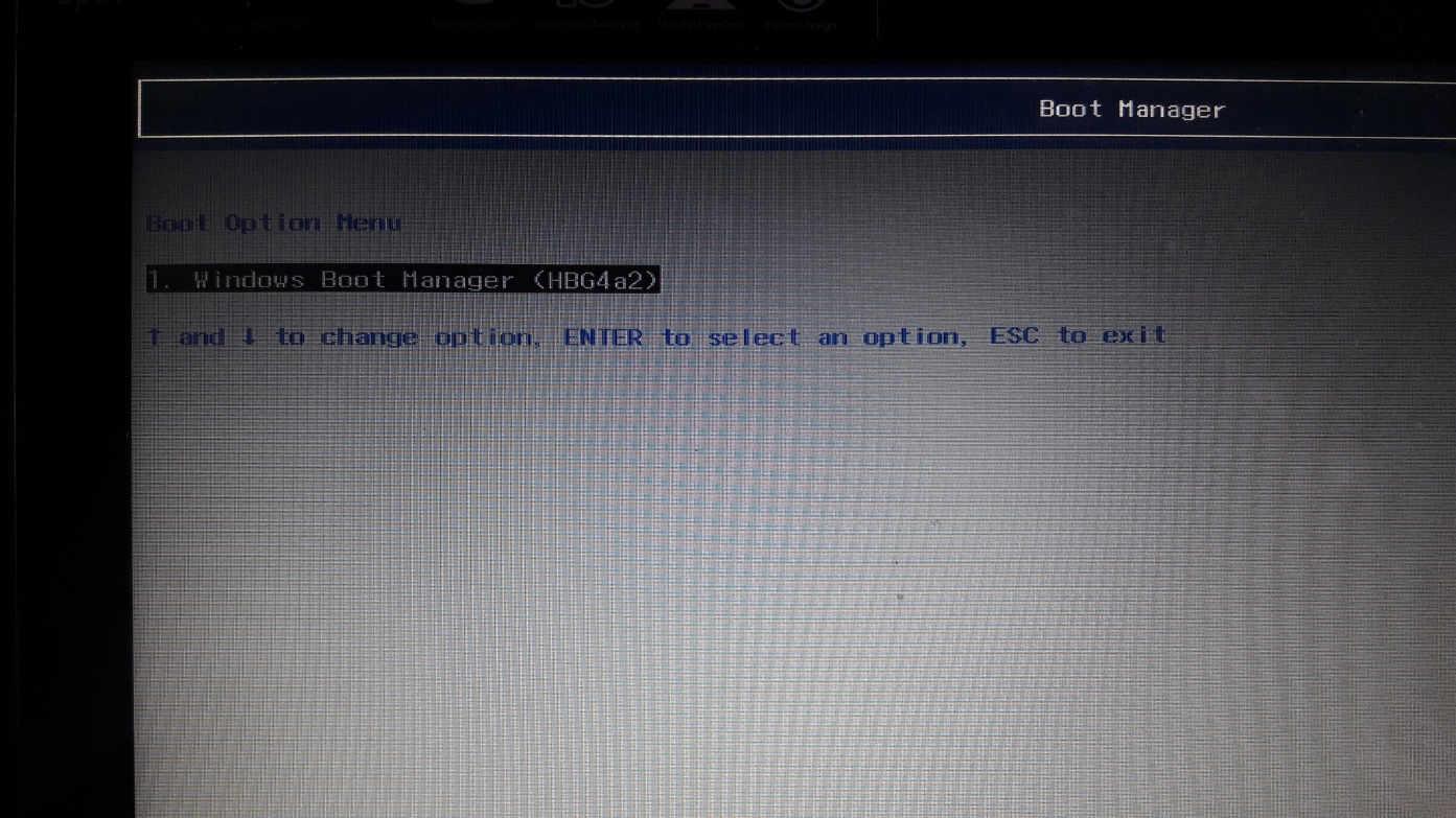

Chalky, I don't think I can boot from anything other than Windows.
This is what I get when I hit F2 and go into the boot manager. Do I need to do some enabling somewhere?

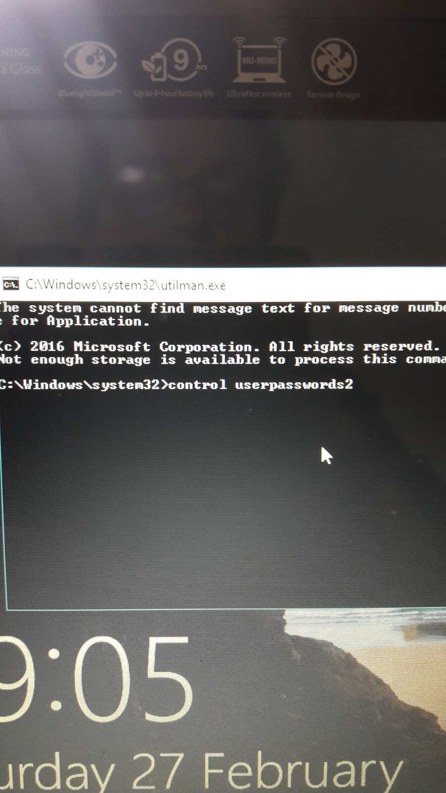

HB, Thanks for your input. I couldn't manage to get into DOS following your video so I tried another random offering on the internet:

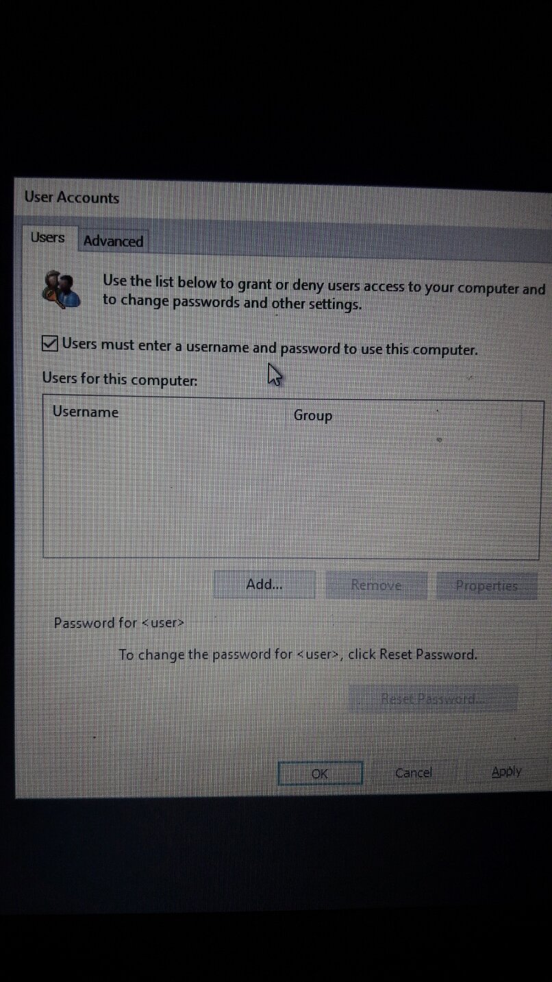

With this I got into DOS and, as the guy instructed, entered this command 'control userpasswords2', which led me to this screen:
Now there was the original username in the users box but there was a message in the reset password box saying that this password could not be reset.
Stupidly, I decided to delete it, thinking that would allow me to add another user.
I then went back to your video but, of course, the username has been deleted.
Is there any way back from this? I tried system restore, but there are no restoration points set.

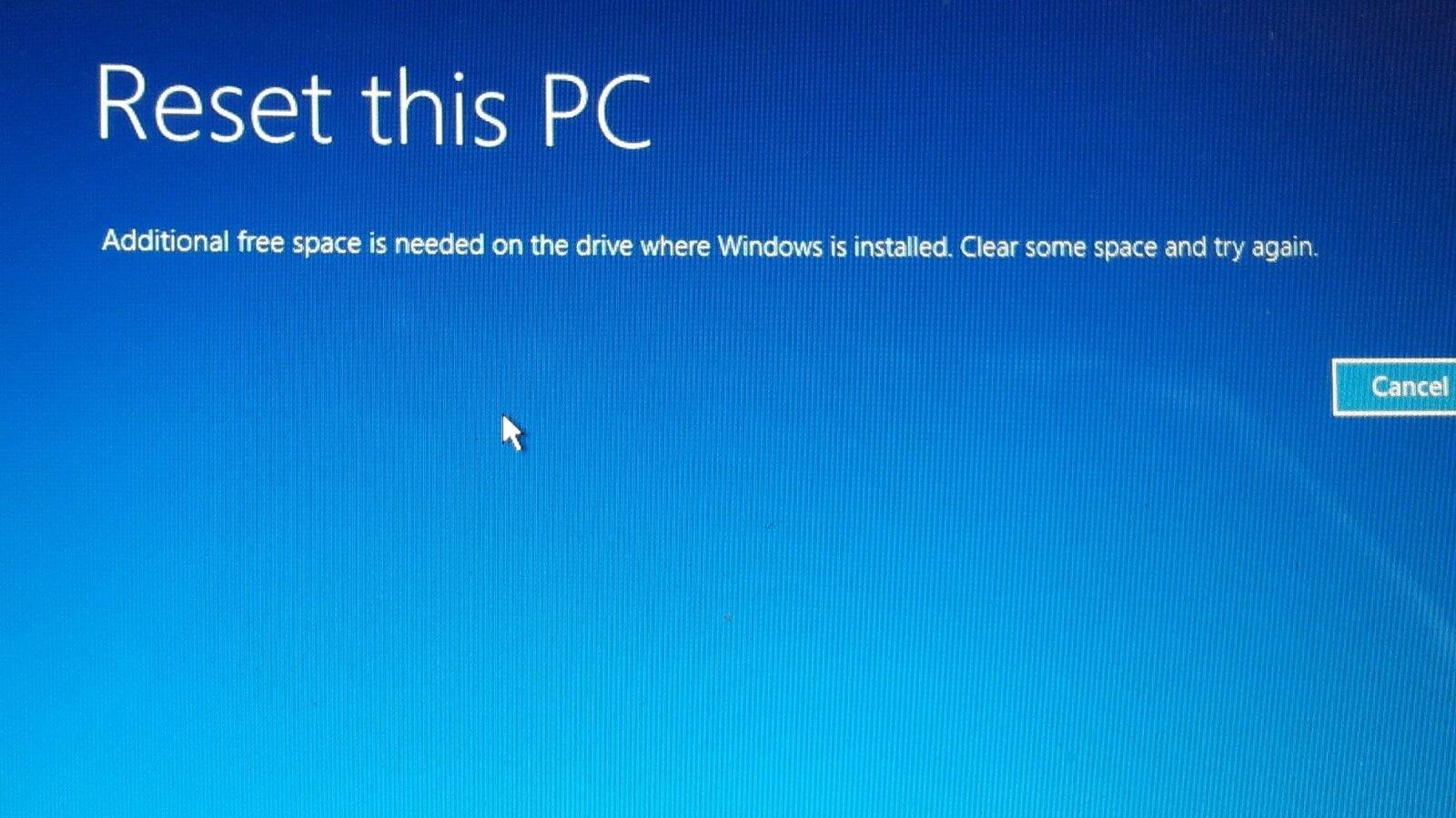

Thanks for your help Jonbey. This certainly seems a simpler way to get into DOS and restoring the laptop to factory settings would be ideal, however, whether I select 'keep my files' or 'remove everything', I get this message
Is there a trick I can use to clear some space? Perhaps use a DOS command to delete something?

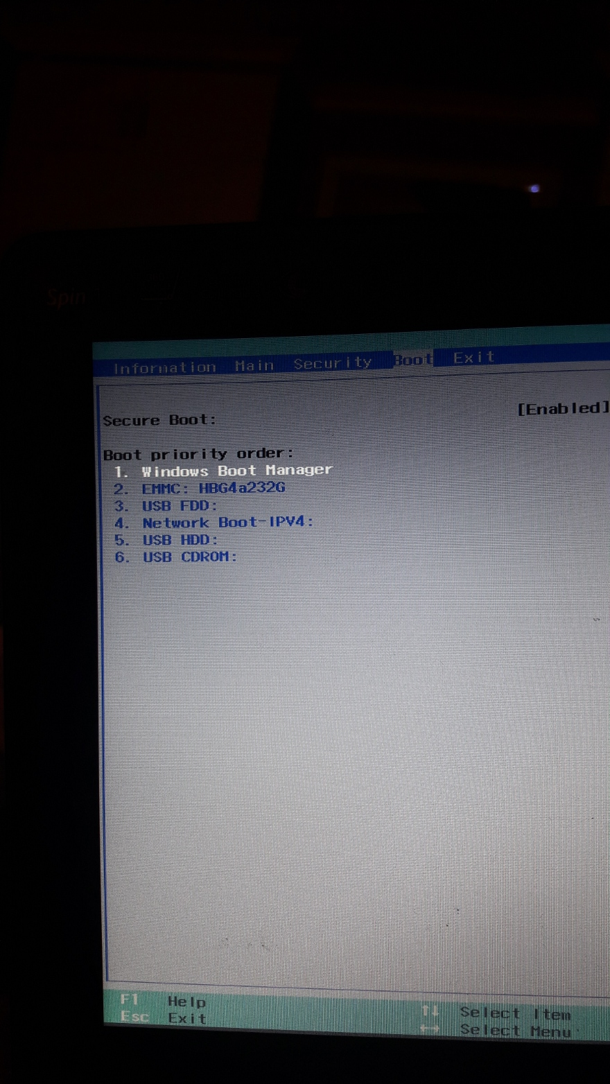

Thanks for your input wgt52. No. I don't want to access my uncle's data. A fresh install would be fine..... And I've managed to do it.... :LOL::LOL::LOL::LOL::LOL::LOL:
The problem was to get the laptop to boot from USB. There was some kinda "secure boot" thing going on which meant I couldn't boot from anything but Windows. To disable secure boot I first needed to set a supervisor password. After that, loading Windows10 from a stick was a breeze.

I don't think so. This is all I have in the BIOS screen. I simply moved Windows Boot Manager to No.6 priority and it booted from the stick.
