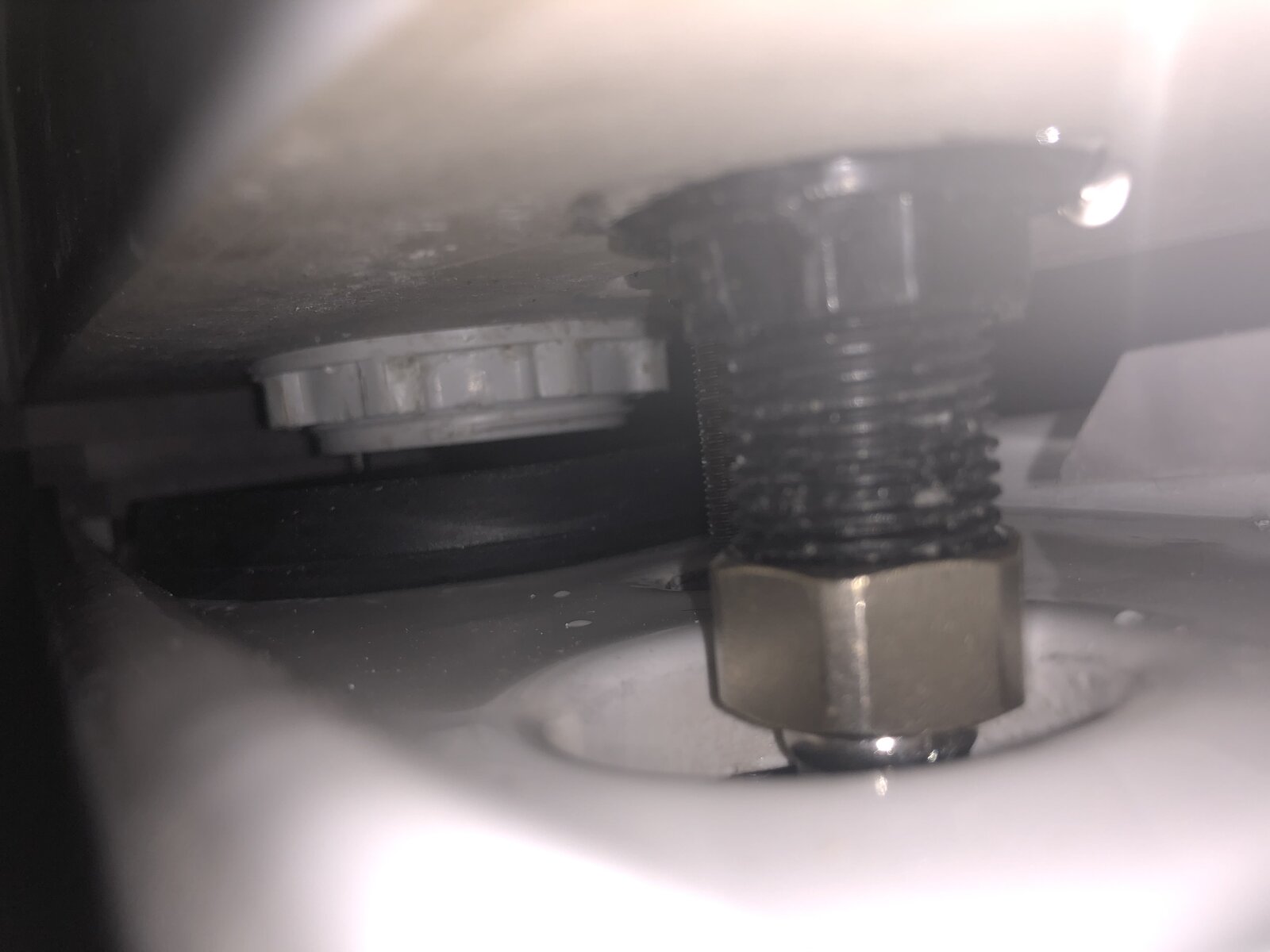

Brand new close coupled toilet and has been leaking from below the inlet valve from the get go. I removed whole valve and retightened to the max I could with no luck. What else could I do?
You need to take the valve out and check the inside of the cistern. Is the sealing washer conical and is it the right way around inside the cistern? Don't overtighten as it can squash the sealing washer too. It may need a little fillet of silicone, if it won't seal properly.
It’s conical and the bottom of the cone will be married to the bottom of the cistern. I’ll try a bead of silicone there.
The conical part of the seal would be down towards the hole in the cistern. If it still won't seal up then yup a little silicone. Just be careful as the silicone can lubricate the rubber and make it squidge about, so don't over tighten.
Never rely on washers alone, the ceramic is always too rough. Apply silicone, moderate tightening and leave 24 Hrs to set. Use a bucket for flushing.
Doesn’t appear to be any damage. I’ll leave the silicone 24 hours to set this time.

Points 1 & 2 I'm sure about. For point 3, there was no sign of any washer supplied that will marry between the external nut and the button of the cistern, is that was what you meant?
Are you sure the leak is from inside the cistern
You can see the drip top right of the black inlet where the nut joins the cistern - bit out of focus 4 sure or is it my eyes .... water connection looks dry tho
You wouldn't usually have a washer on the dry side, the flanged nut sometimes has a centering ridge that sits inside the cistern hole and lines the inlet up.
If its a cheap one (the B & Q £38 job for instance) I had problems with one of those, the casting was off, the hole where the water inlet went was too near the side of the cistern for it to seal properly, as i tightened it the whole valve unit was pushing sideways. Took it back, went through another 8 on a pallet before finding a good one
Leaks appears to have been sorted with the above advice. Many thanks everyone. I hope the silicone fix will last!
