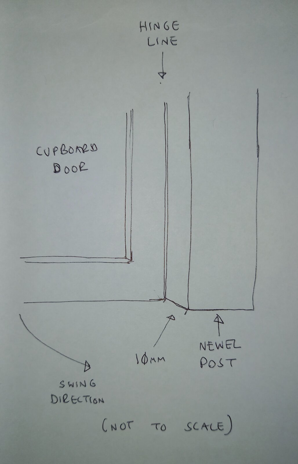

First time building a cupboard and wondering if inset hinges would work for this design?
Would inset hinges give the door enough "throw" so that it would open given the position of the newel post?
I'm thinking of creating the door out of plywood. Not sure on the thickness yet. The opening is around 1 metre in length and will fit into the opening below a 45 deg. staircase.
I was thinking maybe 12 - 18 mm ply for the door then making the panelling design from 9 mm mdf.
I would welcome any suggestions.
Thanks.
Yep, it should work!
Although the thickness of your door material may have an impact.
I used inset hinges for my cupboard under the stairs, with standard thickness IKEA wardrobe doors, cut to shape, rather than creating my own.
Edit:
Sorry, just reread your post - so the door thickness may be 27mm in all?
I think this will be out of clearance for most inset hinges and you'll be looking at 'Thick door' hinges.
...and a 1m wide door will require a lot of space to open and walk around.
I think Parliament hinges would do it, and not get in the way in your layout.
a good leading edge [chamfered back edge] as well as with a parliamentary hinge the exposed knuckle [pivot point ]to door back edge is the equivalent off door thickness
also sloping top edge you need to avoid a point at the top hinge side or the point will not work on opening
Can you get Parliament hinges for a 27mm door? Only ever fitted them on stuff like bank doors (e.g. 50mm thick and above). I'm also concerned that the stile half of the hinge would need to be sunk into the newel post unless a 4 to 6mm gap on that edge of the door was acceptable, or a thin stile could be fixed to the newel to accommodate the thickness of the hinge recessed plus
say, 12mm or so (based on the fact that every Parliament hinge I've ever seen is a lot thicker than the equivalent fire butt hinge)

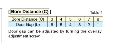

I had a look at this:
Firstly, would that hinge to the job?

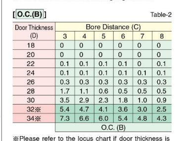

Looking at the charts on the data sheet:
Is the bore distance the distance to the edge of the bore of the centre? I presume it's the edge.
What sort of gap should be aiming for to have a nice neat finish?
Likewise, for the opening clearance:
As my door will open onto the newel post I'm not sure what opening clearance I need.
I could start with some 18mm ply for the actual door and then make my panelling design from 6mm MDF potentially?
I think 18mm is the starting point as the bore depth for those hinges is 15mm.
This would give me a 0.1 mm (?) opening clearance if I have interpreted the chart above correctly.
