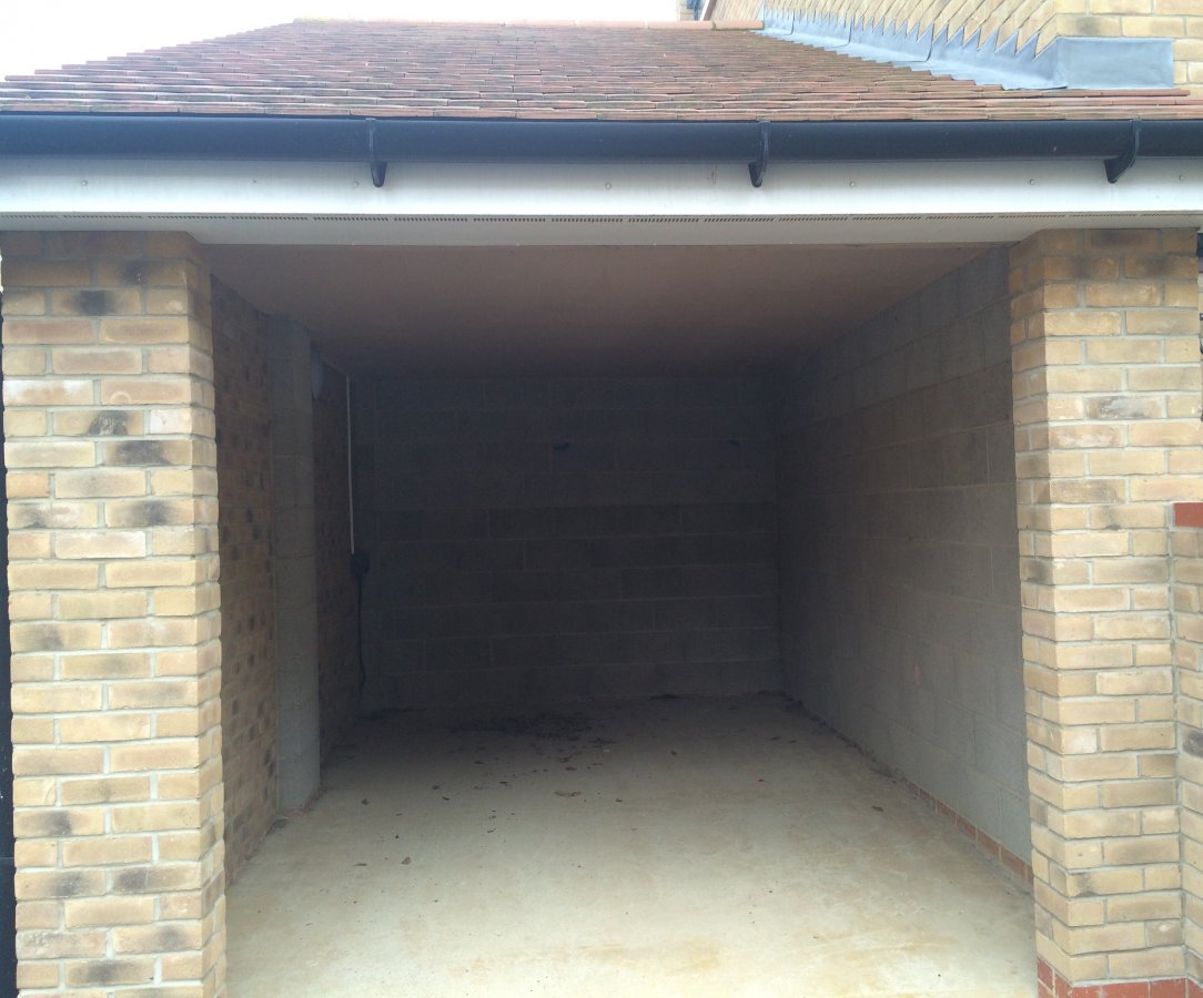

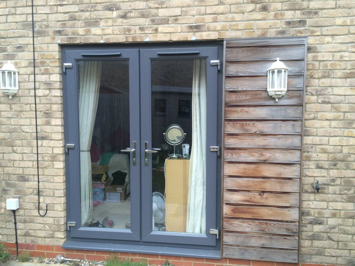

I believe my property development rights are being taken away from me. I bought a house with a 3 wall structure across my garden that is classed as a carport/garage (or neither as garage has to have a door but it doesn’t while carport has to have 2 openings but it only has one). I wanted to insert a double door similar to ones used in the neighbourhood on a structure to use it as a secure storage space. I had local council getting involved telling me I have to apply for a planning permission as it will be a material alteration to the external appearance. From the researched information, it states on planning portal that i do not need a planning permission to insert new doors that are of a similar appearance to those used in the construction of the house. It also states that as long as I am not altering structure and not extending the place my project falls under my development rights. I have checked and i do not live in a conservation area and my development rights have not been removed. Local council said that there is nothing stating I cant put up a door, I do have restrictions on putting windows or dorma doors but no other types of doors are restricted. However, despite all that, they want me to apply for planning permission due to me putting up a door will materially alter the appearance....But then any of my developments rights can be twisted by the council. I feel Local council is unlawfully limiting my development rights and want a fee from me when I am confident what I am proposing is within my rights. Its like they created a loophole to overrule my development rights. Please help!
Three pics: identiacal neighbours carport/garage; works done so far to mine; and proposed double door insertion to match neighbouring houses

Assuming none of your permitted development rights have been removed, what you are proposing would not need planning permission.
Clearly you intend using that as a room - are you sure there is no restriction on converting garages to
habitable rooms on your estate? (many councils do this if they forsee off-street parking problems).
Other than that, all I can think of is that they are bluffing and just want your £172 application fee to put towards their Christmas do.
Just put the doors on, and see what they do, which in all likelihood will be $od-all, or maybe just a snotty letter or two.
PS: putting a door(s) in an opening does not constitute a 'material alteration'. Whoever at the council told you that is clearly in the wrong job.
PPS: just re-read; are you confusing Planning with Building Control? Conversion to a habitable room does need a Building Regs. application. Maybe it's that which they mean?

As there is no statutory definition then you have to considered how significant an alteration is to the building. You could argue that as permission is only usually required for windows & doors on a side facing boundary elevation, at a first floor level, that inserting a window of a similar style to that of the existing forward elevations windows would not require permission or pose a significant material change - it's effectively the same materials already in use over an opening that's already in use. The council would have to argue the term 'significant' and if this ever went to an appeal I think the planners would look stupid - so I doubt they'd want to take it to appeal so would therefore grant permission if they requested a retrospective application - especially as you say other properties have done similar (which sets a precedent).
The alternative is to fill the gap with a temporary garage door - then after a period replace it with a window. They can't argue a garage door is a significant change in the first instance then in the second instance they'd have a hard time arguing a significant change from a door to a window.
