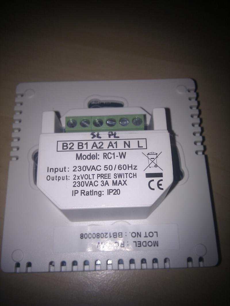

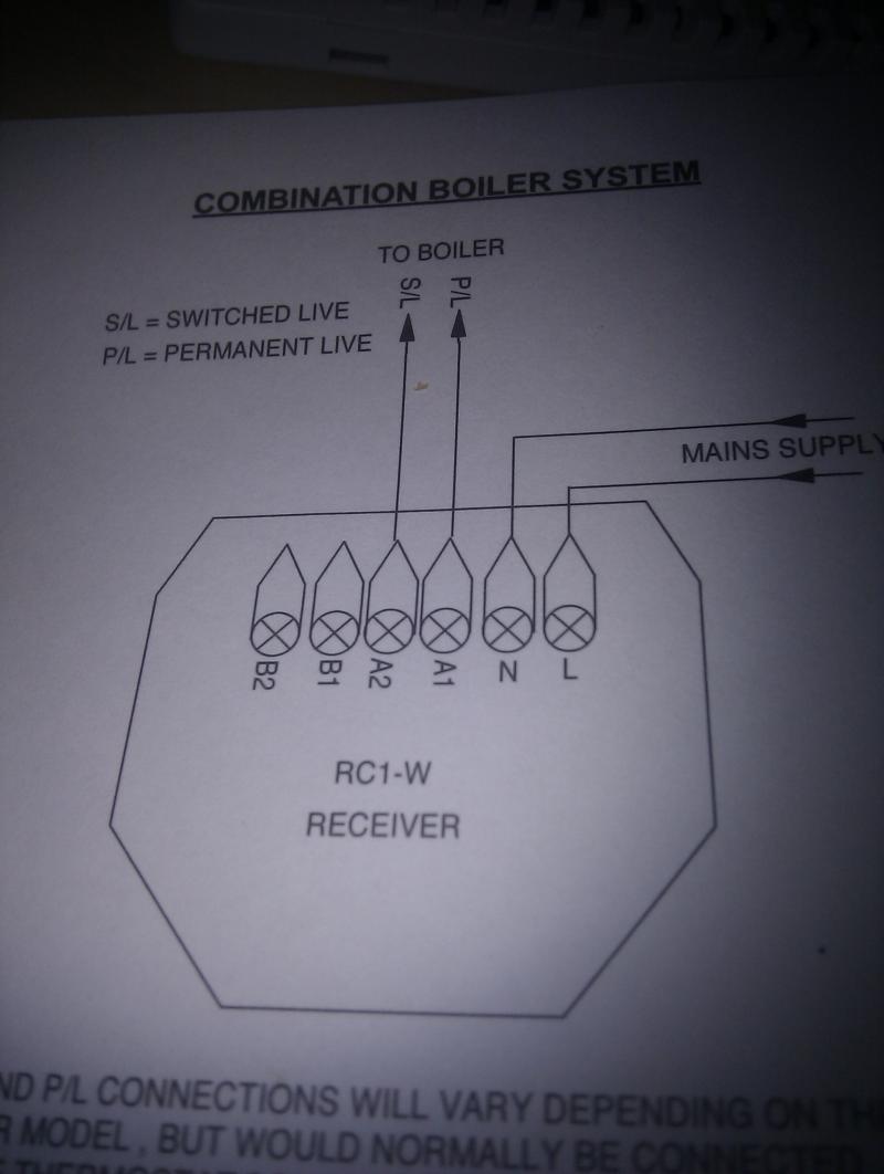

Recently moved into house which has combi boiler (biasi m90f 24s) for hot water / heat.
There was no room stat and I fitted a cm900 rf unit as per D_Hailsham perfect instructions, thanks
Now the good bit , i have just been given a heatmiser prt -ts wifi rf kit to test so im gonna try and fit that inplace of the cm900.
How would I install it? I've posted some pics of the system as it is was -
There is a mains feed in the airing cupboard for the reciever which i can suss out, but where would I wire the control to?
All suggestions gratefully recieved. - PHOTOS BELOW

I have sussed out the live/neutral in to the reciever from bioler 3 amp feed
but
In the first picture
is the permanent live the bottom left wire (red) in the bottom connector block
and the switched live the far right blue wire in the bottom connector block
any help would be really appreciated gang
