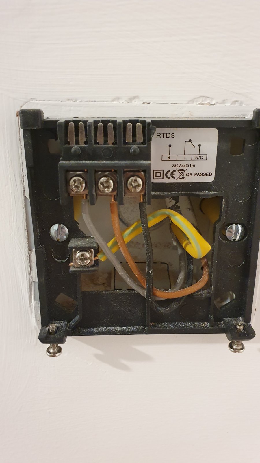

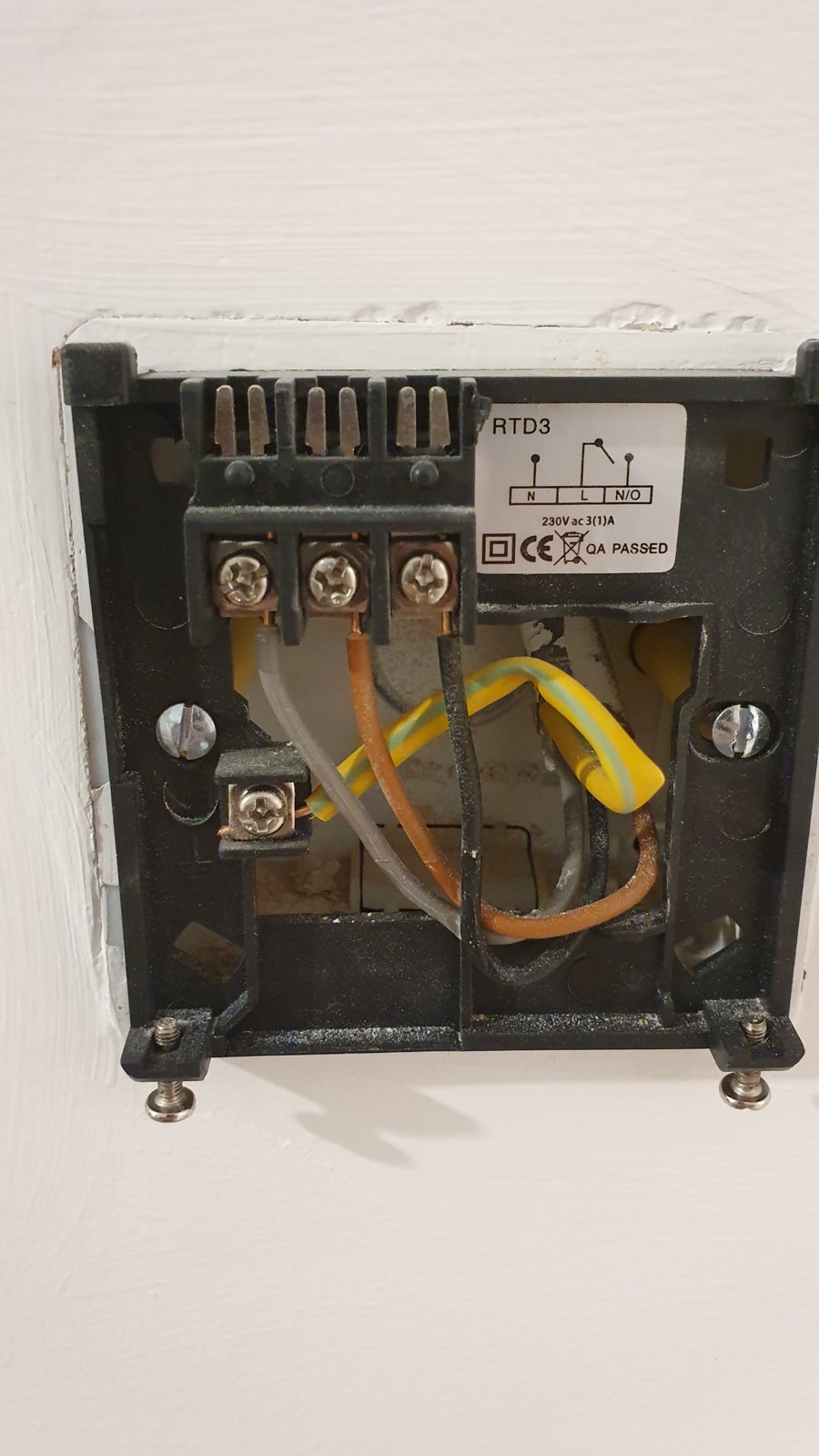

Hi, I'm trying to replace our current ESi thermostats with Tado. Our heating is multi-zoned with boiler+external controller+thermostat at zone 1 and hot water cylinder+thermostat upstairs at zone 2. I dont think the cylinder is related to the thermostat upstairs but using it for location reference.
Following the Tado instructions it only shows 2 cabled and a dotted (optional) one to be installed (NO, COM, N). However my thermostats have 3 cables and an extra yellow/green one (see photos).
Any ideas how to connect the Tados and whether the water cylinder changes the process at all? I believe everything goes to the external controller and then to the boiler which should then command the cylinder. This is the main reason I bought Tado as I bought a Nest and engineers wouldn't install it.

They were saying my set up was too complicated for them. I'm guessing cause with Nest they need to replace my external controller with Nest's heat link.
Anyway I managed to install Tado. I just used the parking slots for the yellow and Neutral cables and worked. Thanks

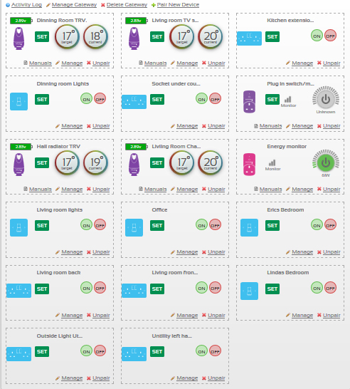

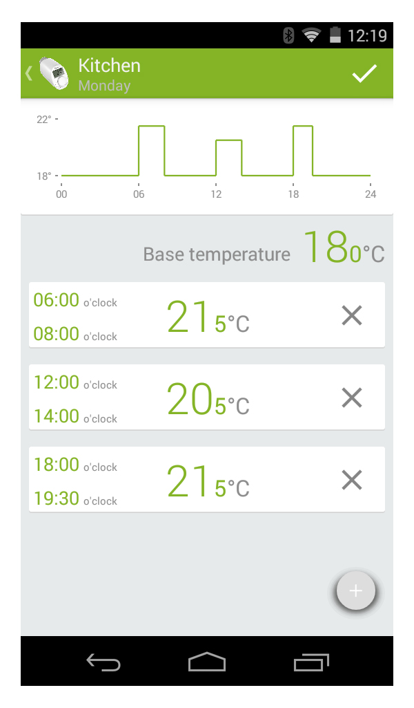

In my case also lights and sockets as well as heating. The problem is until you install often people don't know what it will do. This is one of the pages from the cheap bluetooth
it shows the schedule set.
Point is every programmable TRV head forms its own zone, well the eQ-3 shown above can be paired with other TRV heads so where there is more than one radiator in a room the heads are linked.

Alternatively, you can just swap the two room thermostats for wired Tado thermostats and leave the hot water as it is.
In which case, if your Tado thermostat looks like this:
stat-jpg.177622
The grey (neutral) wire in ESi N is not required, put it out of the way in one of the 'parking terminals'
The green/yellow earth wire is not required, put it out of the way in one of the other 'parking terminals'
The brown wire in ESi L will connect to the Tado thermostat COM
The black wire in ESi NO will connect to the Tado thermostat NO (No surprise there!)
