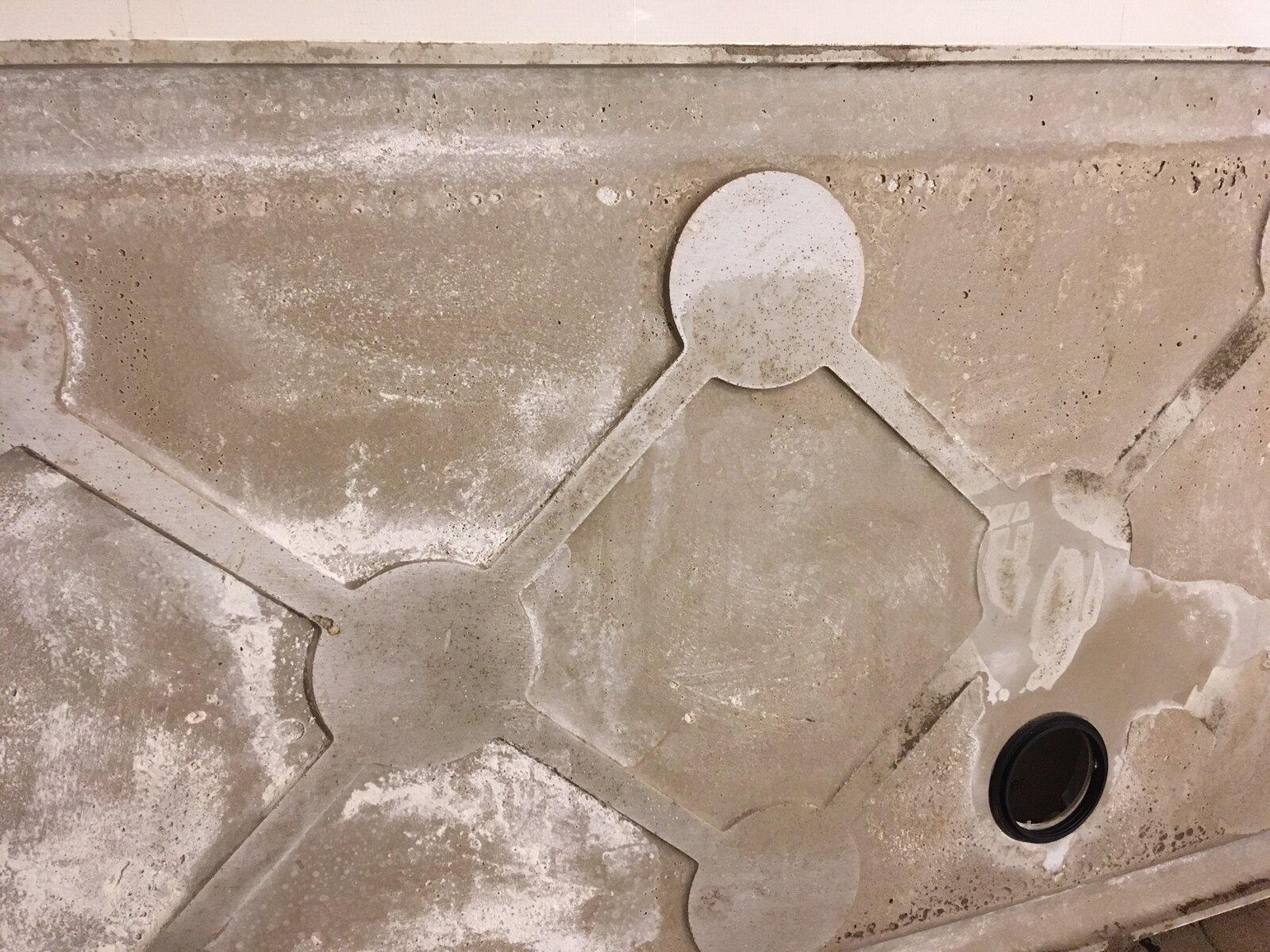

The tray is like this underneath (not my pic). I'm thinking that the machined flat parts are bedded into the sand and cement, but as a result the edges are 'floating' a little and that's where I see the movement.

What make is the tray? I'm sorry to say but if I received a tray like that for one of my customers I'd be telling them to return it straight away. As far as I'm concerned that's really bad/cheap finishing.
The whole base should be flat and level, or at least flat and level over large portion of the underside and certainly at all the edges, that's probably why they ask for it to be set into sand and cement so they don't have to finish it properly.
Did you run a level over the base and see what size of gaps there were to the low points? That would determine how much more mortar mix you might need. You maybe need more mortar mix to fill the larger gaps.

If you watch this video at the 2'50" mark it shows the tray being ground down so the bottom is flat (in certain areas) https://www.mx-group.com/videos/

So are you fitting trays like my one, i.e. not flat on the bottom but full of undulations and mouldings?

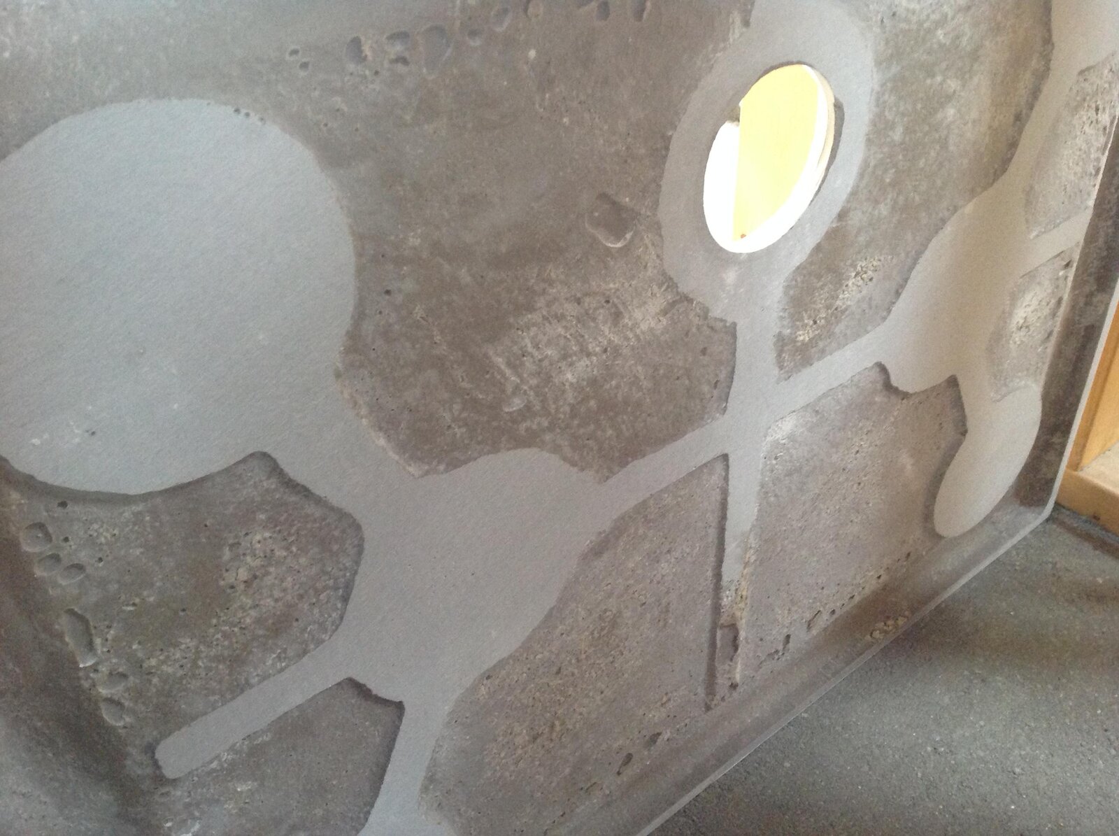

I've taken a couple of pics - the underside of the tray, and what the mortar looked like when I lifted the tray. I can see that the 'flush' parts have squished the mortar down to about 6mm, but there hasn't been enough mortar to fill all the sunken parts. (I laid about 10-12mm).
Running a level across the bottom of the tray, some of the 'atomic model' ground down mouldings are flush but some are nowhere near flush. How deep should I have the tile adhesive to make sure everything gets supported? and how do I get the flush areas to be sitting on a thin bed of adhesive and the 'not flush' areas to be supported? It's such a big heavy tray it's hard to shoogle it around when levelling it.
It would great to figure out a way to turn the tray over, fill with tile cement, then put a thin lid on it. Turn it over and place on the plywood, then slide the lid away. Ta da! all mouldings filled and tray secured.
We just use blobs on the floor where the circles are going to be and then whatever’s left in the mixing bucket gets blobbed all over
The moulding doesn’t have to be filled, just make sure you get a good bed of rapid set all over under the tray, and it’ll be fine
Ah ok, those high spots are there by design and not just a bad pour, the mould's made specifically to create those and the ridges by design and then the mortar will be laid for those pads/ribs to sit on .... fair enough.

Your mistake was shoogling it- those trays are too big & heavy. Trick is to get your slightly wet bed level then drop the tray on it as square as poss, check for level. If not level, lift tray, redo bed, repeat til level then chuck yr big weight in the middle & leave it.
Walking on it will have squeezed mortar away from the edges & created your wobble.
