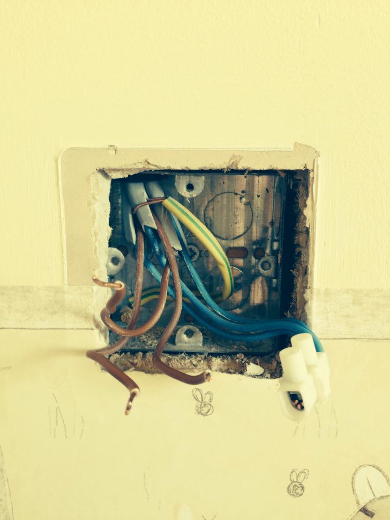

I took off the switch in a bedroom to replace it with a dimmer switch. When I removed the switch (after turning off the supply) I noticed that there were 3 lives wires.
The earth was connected to the back of the metal box. There were 3 neutrals, that were all connected together and fastened in a plastic clip.
I didn't take note of the original connections although I'm not sure where I need to connect now as I'm puzzled.
Help please.

How did you know they were all 'live'. Do you mean that there were three brown (or red) wires connected to the switch, or what?
Again, how do you know they were neutrals - do you mean that they were blue (or black)?

Is there a second switch which controls the same light(s) as this switch?

If those three browns haven't been bent around very much since having been removed from the old switch, I think their positions, as in the photo, probably gives a very good clue as to how they probably should be connected to the new switch (top one to COM, or whatever, and the other two to L1 and L2, or whatever they are labelled).

Seems more likely to me that it's a one way setup and he has incoming permanent live, outgoing permanent live and switched live.

That's a possibility but, if so, to get everything (including other lights) to work correctly, he would have to have put two (and the right two) of the browns into one terminal of the dimmer - which I would not have thought would be a particularly obvious part of a 'trial and error' process.
Anticmosquito:Is that what you have done, or did you put each of the browns into a different terminal of the switch? Is everything (including other lights) working normally?

I put two browns into the C terminal and the remaining one in L1.
Ah, they were right, then! - and you obviously chose the right two browns to put into the C terminal (the two at the bottom of your picture, I imagine?). As a matter of interest, did you just guess (as part of your trial and error process) that two had to go into the same terminal, or did you remember that from the original switch?

I seem to remember there being two cables in one of the terminals on the original as both had the connectors up. Other than that, it was trying which combination worked in the correct way without affecting the rest of the circuit.
