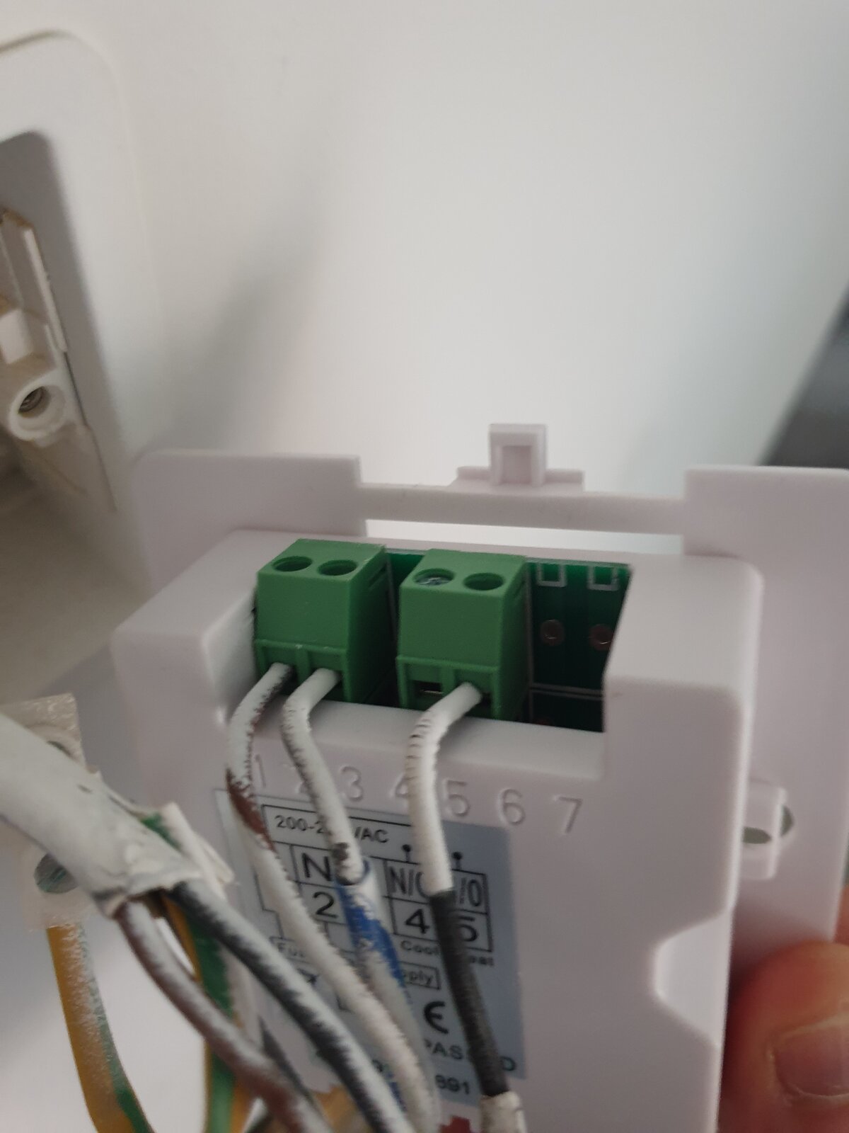

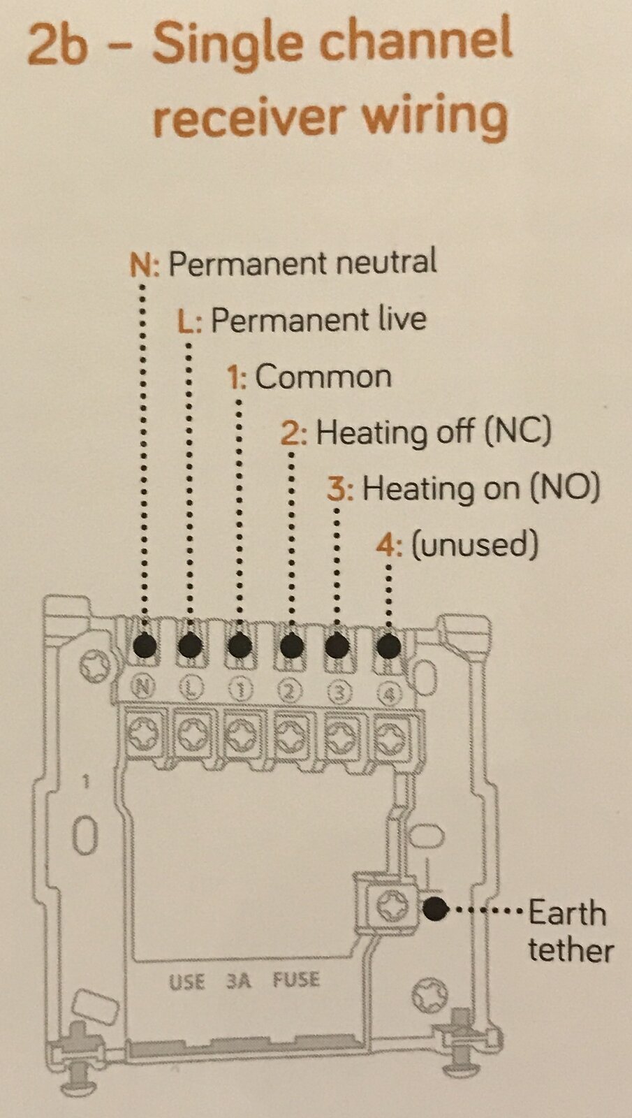

Afternoon All,
Hoping someone can help me. I have (had) an ESI ESRTP5 controller with a combi boiler, after much searching eventually found I needed to put the receives in place of the current controllers. I've done this, all looks ok except that the heating does not come on.
My suspicion is I need to connect 2 of the connectors on the hive receiver. Could anyone tell me which though..
Pictures below are the old cabling and the new.
PIC1 - old ESI
PIC2 - Current config
PIC3 - Hive wiring diagram.
hi @ianmcd
Many thanks, I thought it was that but I'm no professional so best to ask. Another question and don't judge, this is just all I could find around the house, would it be ok to use the Live wire from a plugs cabling?
if not a trip to screwfix I guess.
Thanks.
