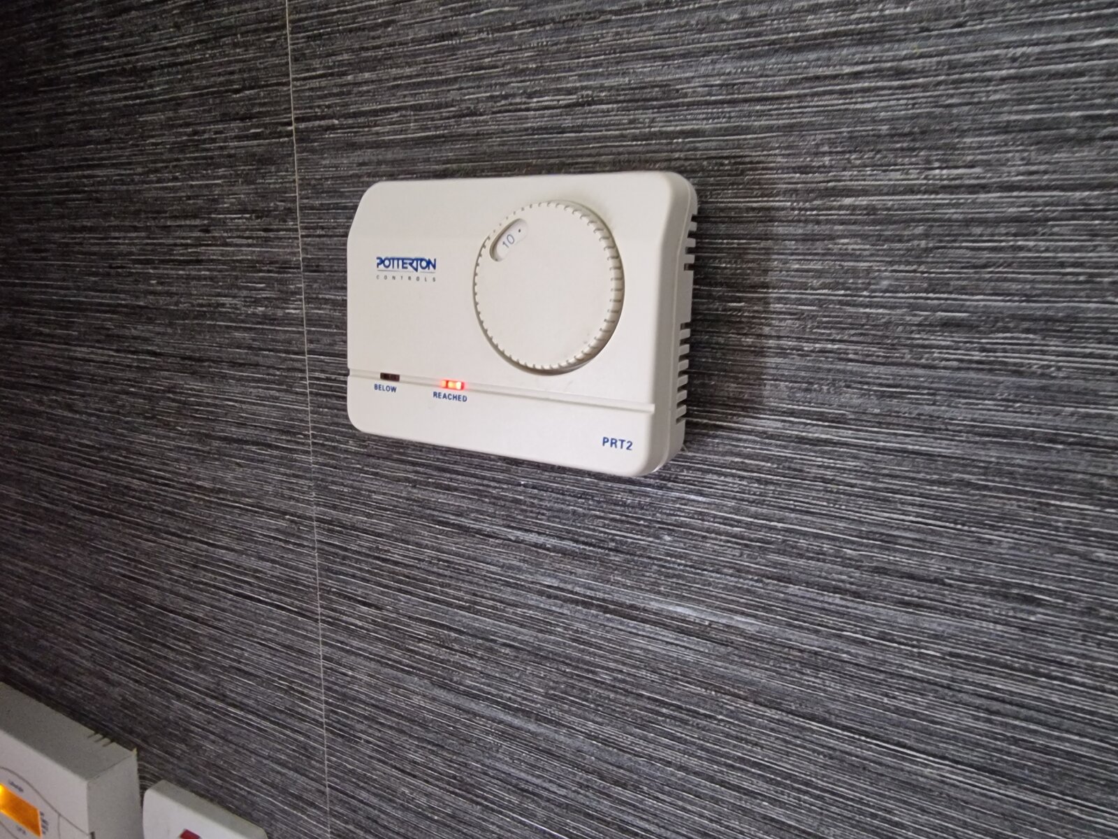

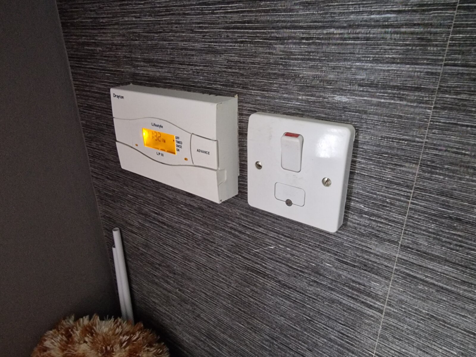

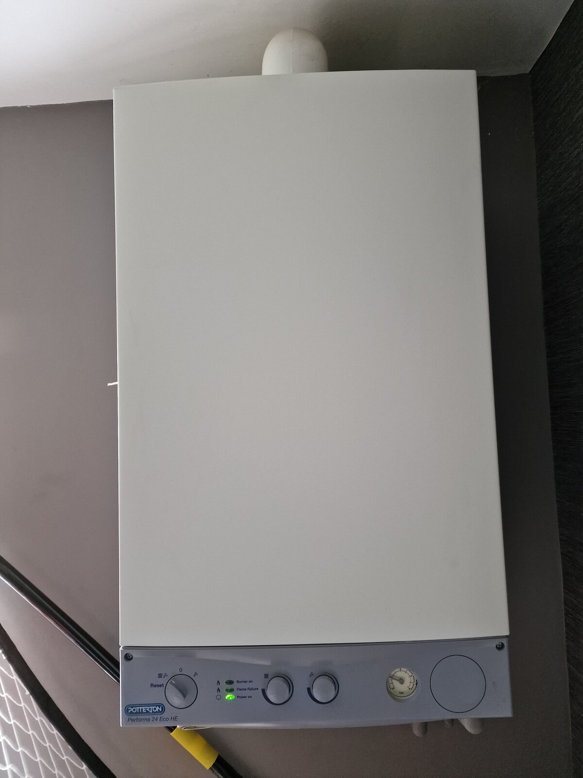

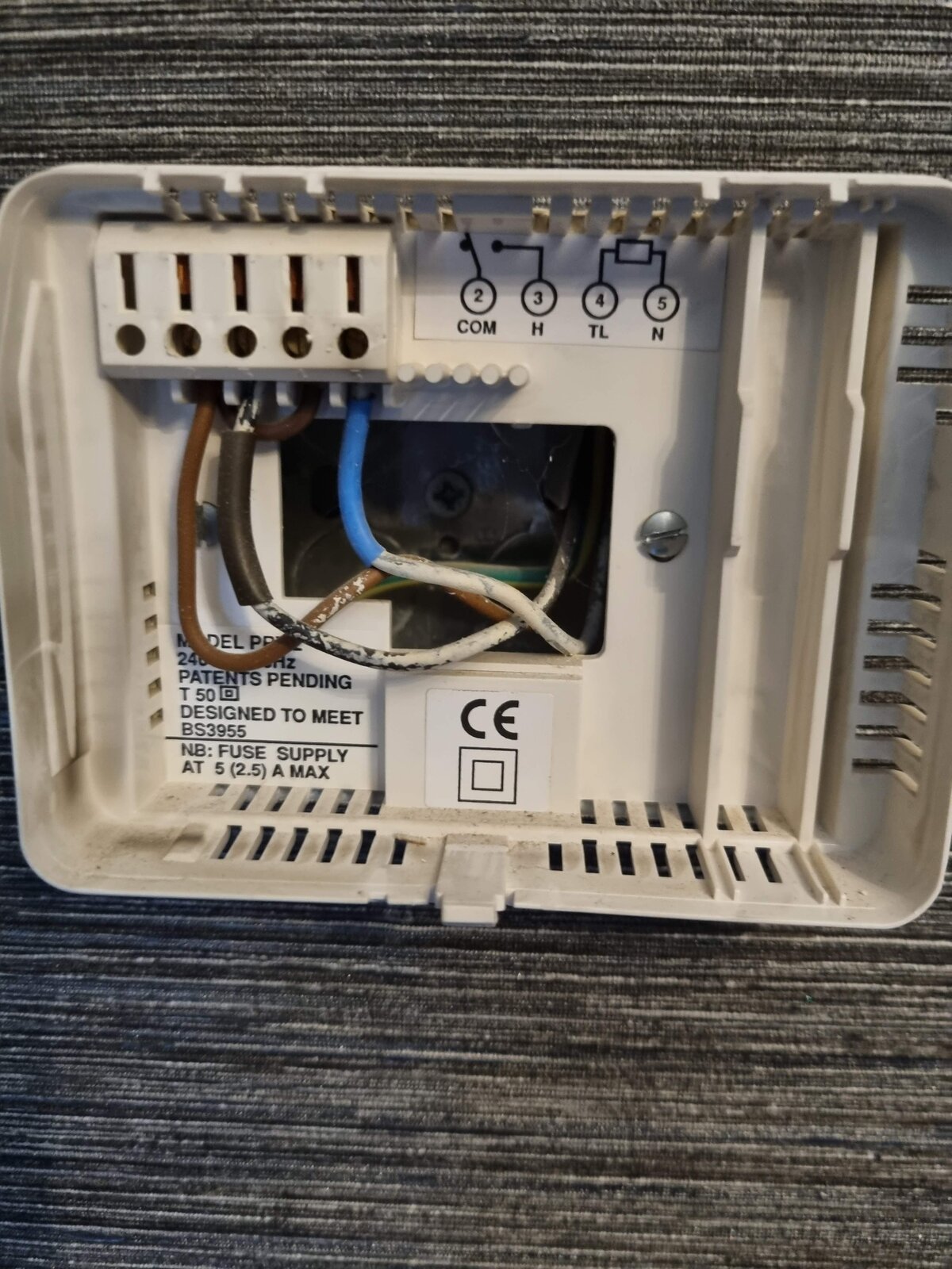

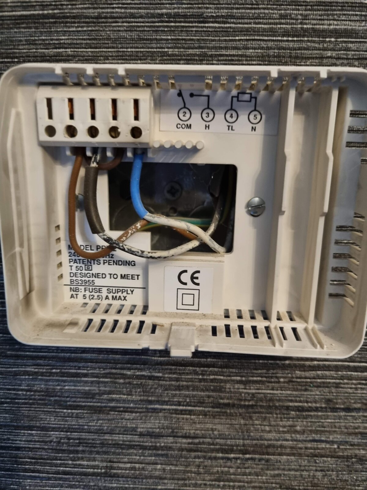

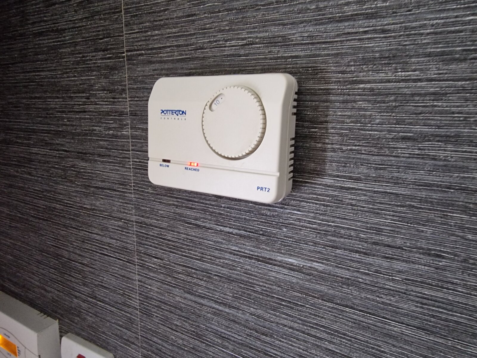

Hi all,
I want to have a go at replacing my current combi boiler thermostat with a Nest. I currently have a Potterton boiler installed with a timer and thermostat. I believe the Nest E can replace the thermostat component but I am not sure on the correct wiring. Appreciate if anyone can provide some guidance?
Thanks,
Steve
Any Nest can replace your existing thermostat, as there is a Neutral and Live wire available to power it.
The Nest E heatlink is battery powered and wouldn't require the Neutral wire.
What you do will depend on how much repair work to the wall, you can put up with!
Rather than replacing the thermostat, you could put the Heatlink in place of the timer - the thermostat could then be linked out and removed, but that would leave a hole in the wall to repair.
If you don't want to repair a hole, and are happy with retaining the timer in place (set it to permanently on); replacing the thermostat with the Nest thermostat E Heatlink would require these connections:
The brown wire in Com, would go to Heatlink C.
The black (oversleeved brown) wire in H, would go to Heatlink NO.
The grey (oversleeved blue) wire in N, would need to be safely isolated in a separate terminal block.

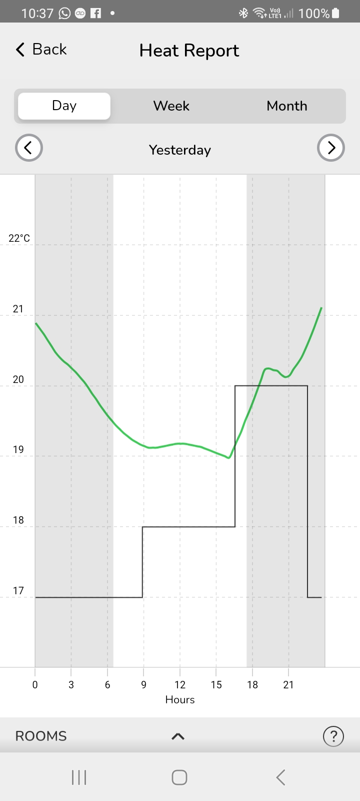

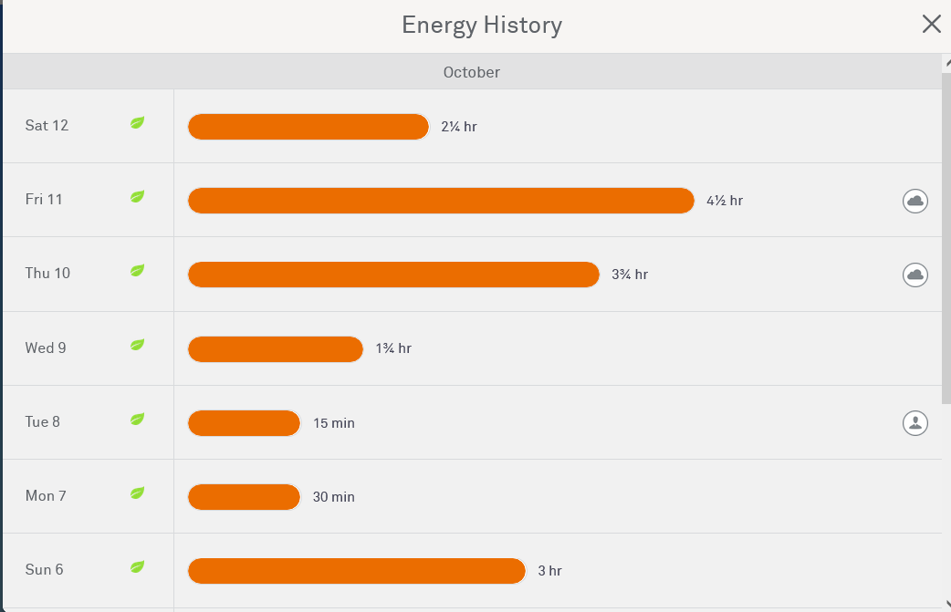

Yes Nest has allowed me to see the temperature to gradually raise through the day 0.5ºC at a time, with 2 hours between each rise, but had it worked with the TRV heads, I would not have needed to do that anyway. It sends me a history 1728824871022.png but since that is only how long calling for heat, not how long the boiler ran for, rather useless.

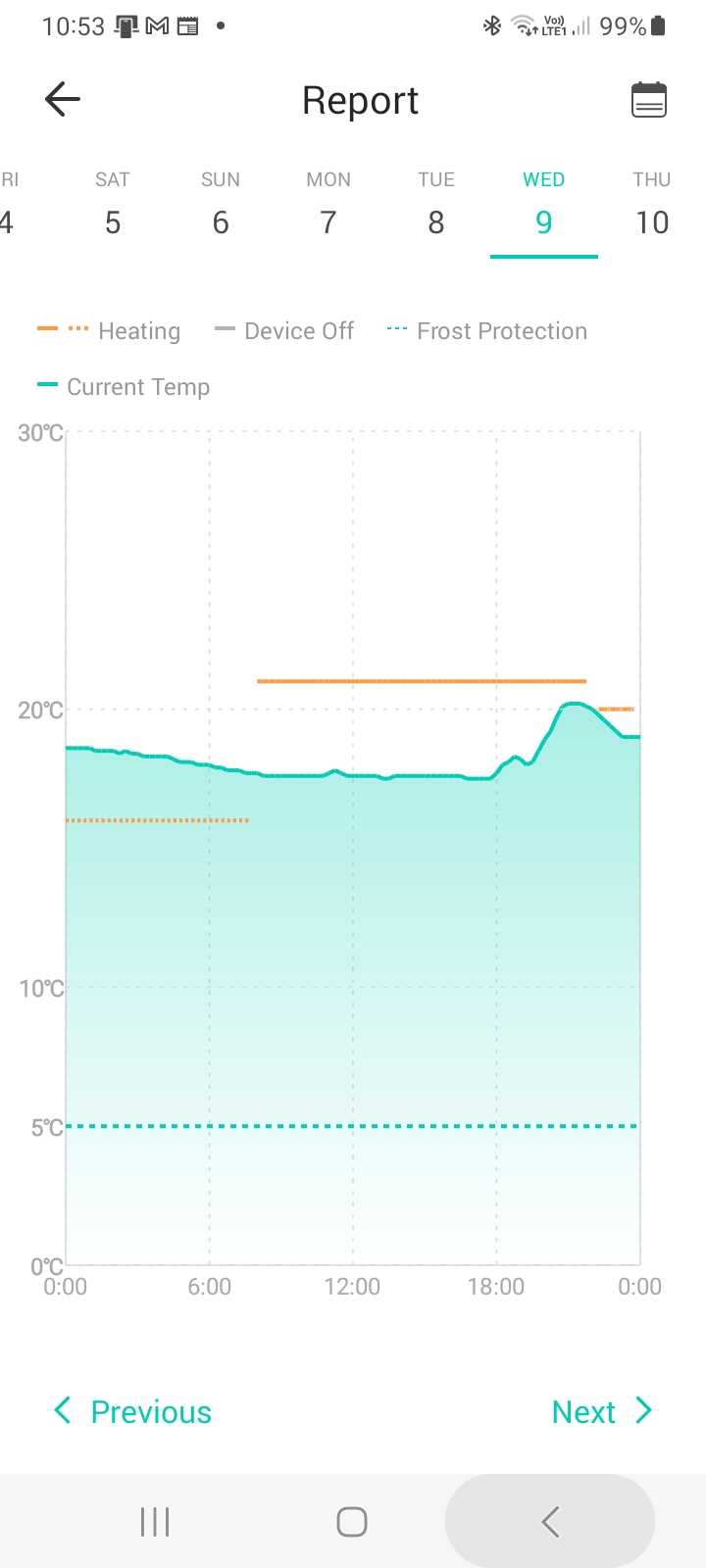

Nearly every feature of the Nest Thermostat I have found I needed to turn off. The Wiser thermostat 1728825096096.jpeg app at least does give some useful info, as does the Kasa TRV head 1728825230606.jpeg they do help work out what if anything is wrong, but only good point for Nest is it can be controlled from PC without a emulator.

Just following up on my original post, I've followed the instructions as per RandomGrinch and it's worked perfectly, all now set up and installed in under 30 mins. Very easy job, thanks again for the help!
